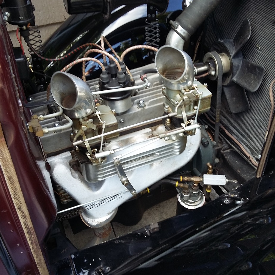

  9. FORDY 6
    Joined: Oct 8, 2002
    Posts: 1,571
    FORDY 6
    I've run these 81's on a Zepher intake on a B motor 20160718_181709 (1).jpg 20160718_181552 (1).jpg in my '31 A for several years without problems...stock tank - no fuel pump.
