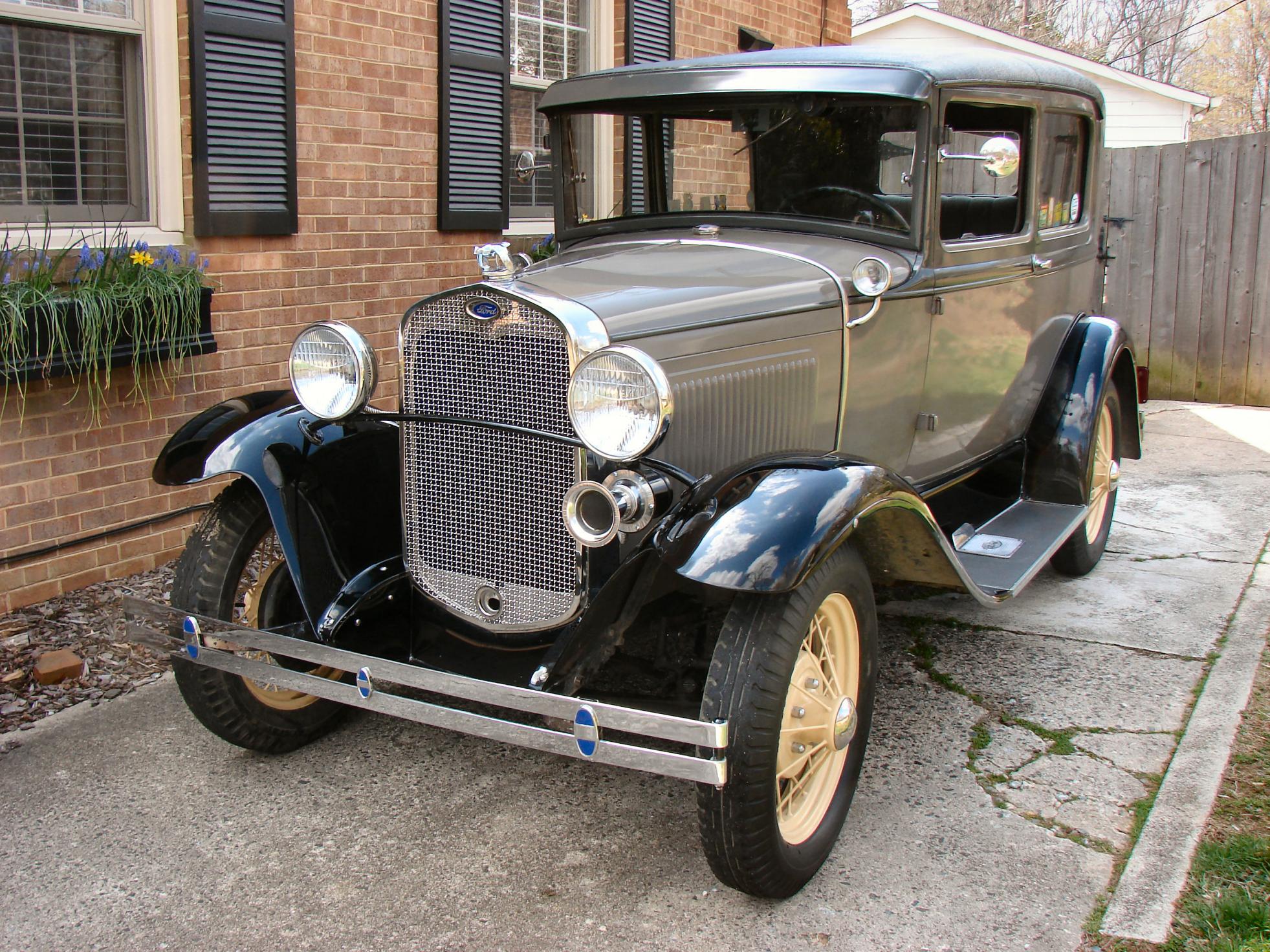

    Years ago I had a Model A with high compression head, dual carburetors, etc and I had a little over 150# in each cylinder. You may be a little low depending on what head, pistons, cam, carbs, etc.
  3. fiftyv8
    Joined: Mar 11, 2007
    Posts: 5,401
    fiftyv8
    from CO & WA
    I have just spoken to a restorer friend of mine and he tells me a high compression head should give you around 70psi per cylinder.
    That is not to say FatFndr<SCRIPT type=text/javascript> vbmenu_register("postmenu_5301933", true); </SCRIPT> comments are incorrect as other factors will make a difference as well.
    However as a general rule with nothing else done 70psi is roughly what you should end up with.
  4. George Miller
    Joined: Dec 26, 2008
    Posts: 413
    George Miller
    from NC usa
    FatFndr is that you Ed
    I agree it all depends which head, pistons, cam. My hill climb A has 160lbs compression.
  5. Pir8Darryl
    Joined: Jan 9, 2008
    Posts: 2,487
    Pir8Darryl
    So long as all the cyl's are within a few pounds of each other, I'd say your good to go.
    Naturally, that assumes the engine hasn't been sitting outside in the mud for the past 30 years :rolleyes:
    Also, keep in mind that 6:1 was considered "high" compression when that engine was new.
  6. 97
    Joined: May 18, 2005
    Posts: 1,983
    97
    My old Motors manual says 65-70 PSI, wide open throttle and engine at normal road temperature, stock engine, Greensboro is less than 1000 feet elevation so that won't be a big issue.
    I would suggest that a leakdown test may be more productive.
  7. sailingadventure
    Joined: Feb 11, 2007
    Posts: 283
    sailingadventure
    Thanks for the help. Jeff
