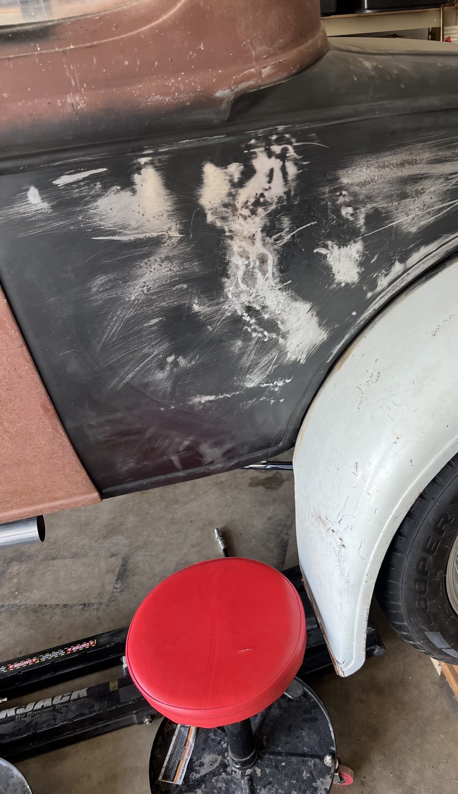

    I did a search and looked around, but couldn’t find anything that dealt with this exact question. The rear driver side fender on my model a sits up at an angle. At first I thought it was the fender, but checking a couple other fenders it’s still not right.
    What I am thinking of doing is, cutting along the top of the inner fender well and pushing the inner panel out. This should push the mounting bolts down to bring the fender angle down. If anyone else has seen this problem before or has a better idea, feel free to chime in. Body work is not my greatest strength. Thanks. IMG_0857.jpeg

    Looks like your quarter panel is sunk in.

    Not yet. We started front to back, knowing the back was the worst part. The car was a plumbing truck for part of its life. So the rear trunk area of the body was cut out entirely (floor, trunk lid, lower panel), amd a box put on top of the buggy spring for storage. There was a pipe rack on the p***enger side fenders as well.
    But without the inner support, the rear driver side must have flopped around.
    The rear quarter is sunk in a bit. I think it’s part of the problem as well.

    I can see new floor in your picture. Maybe whoever put that in, and maybe a wheel well too, tweaked the angle?

    If the quarter is sunk inward (toward the center of the car) the fender will hang like that. I wouldn't cut anything yet, I think this whole issue can be resolved through straightening the quarter.

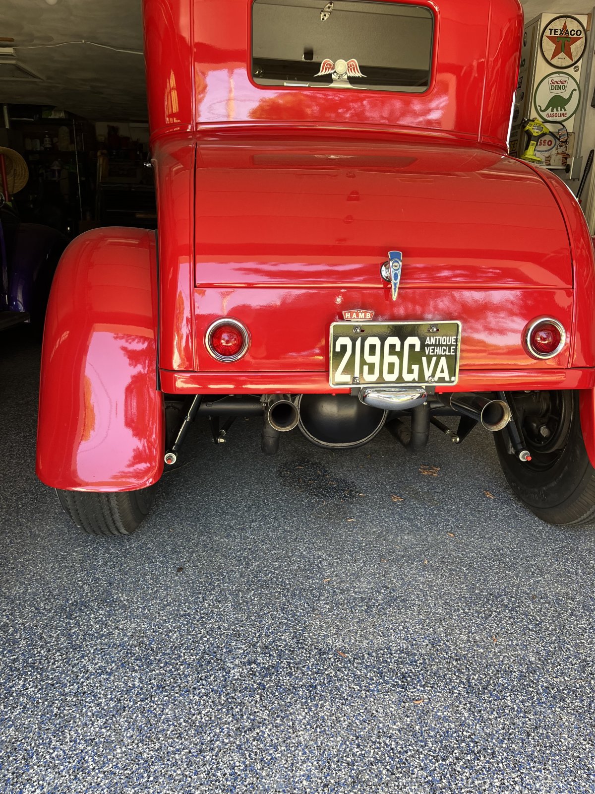

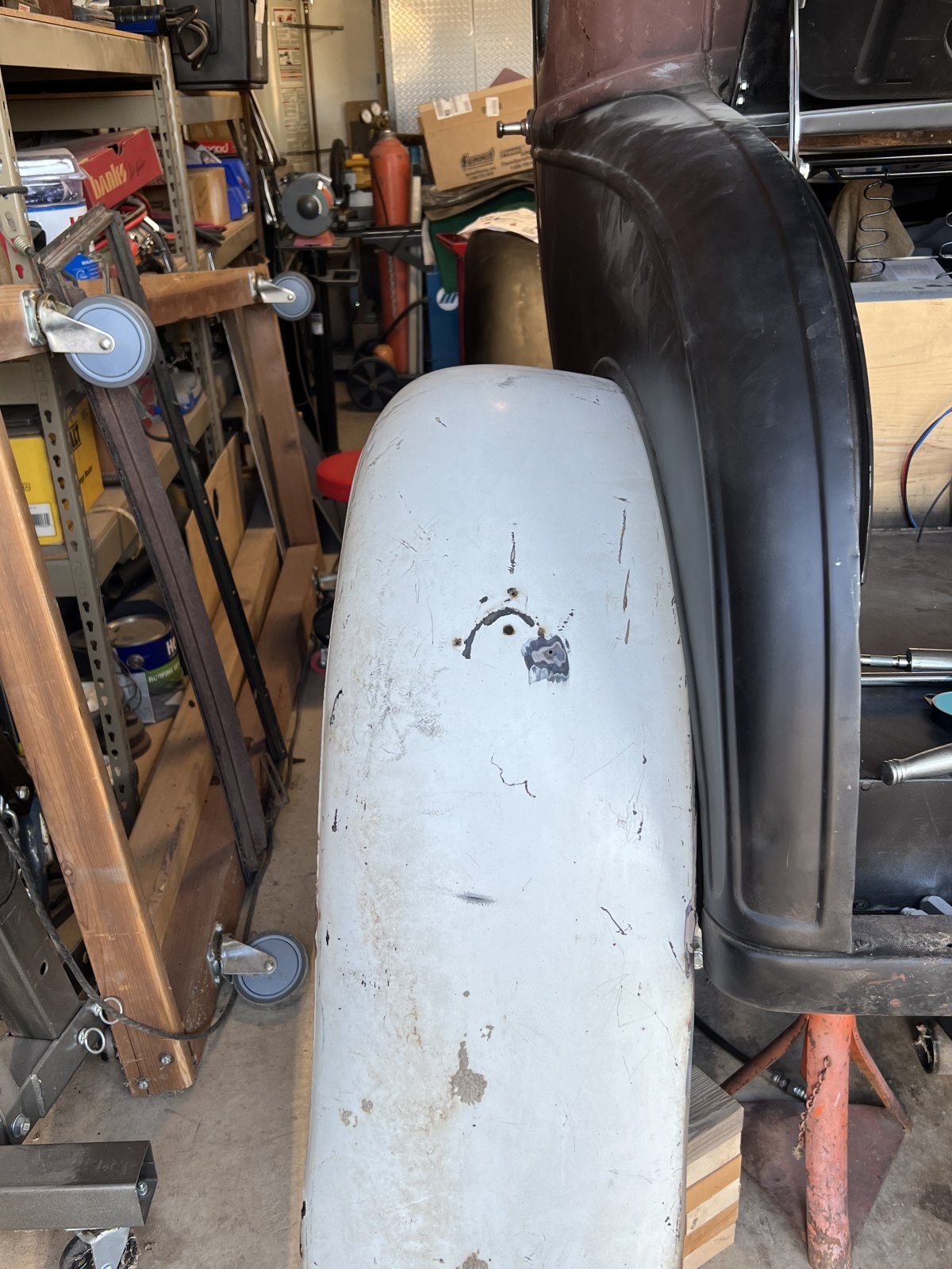

    Thanks everyone for their advice. We worked on that dent in the quarter panel most of the day and it did make quite a bit of difference in the fender angle. The dent went from about 6” in diameter to now about 4”. I never would have guessed that dent tweaked that fender that much. Will keep at it till it’s gone. IMG_0945.jpeg IMG_0944.jpeg

    From your last pics I can also see the lower quarter patch in front of the fender is wonky. That might also be adding to your problem.

  17. That last picture shows a marked improvement. Good work

    Can you remove the fender and post a photo of the wheel well?
