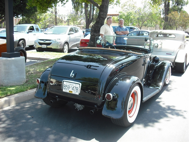

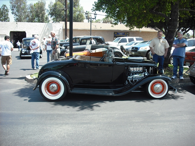

  8. Here's an A roadster on a deuce frame with 32 front fenders and Model A rears. The car was slightly channeled and the fronts were modified in the cowl area.
    It was built in the 50's and recently redone. It was out of Canada and really looked great.
    The phot was taken last weekend at the Early Ford Store in S DSCF0814.JPG DSCF0815.JPG an Dimas.

  9. Obviously, it can be done. Trickiest part would be mating the 32 running boards to the Model A rear fenders.
    Also a lot of holes to drill and if your frame is already boxed, putting nuts on the fender bolts will be a challenge.
    I see a lot of Oz rods with cycle type fenders. Some all around and some with fronts and bobbed stockers in back. Looks good to me but your taste may very.
