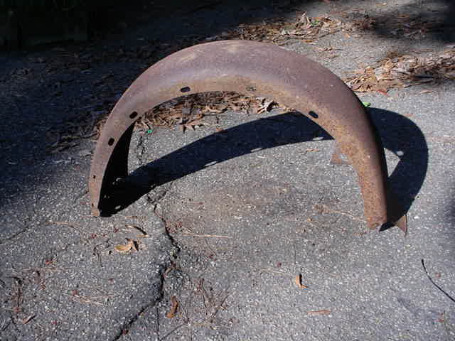

  8. Far as roadster rear fenders go some differences are:
    28-29's are wider than the 30-31's by approx 1".
    The notch for the running board apron is different, I think and don't quote me on this part cuz my 31 is in storage so I can't check, but the 31 has a deeper notch.
    The circumference for 28-29's is the same as the 30-31's which means you can use either fender on either roadster - if you are bobbing them.
    They can remain unbobbed in the back, but the front will have to be bobbed enough to cut away the running board apron notch.
    The fender mounting bolt patterns are different as well, but no big deal to drill some new holes.
    I'm using a Ford 9" narrowed to 56" outer brake drum to outer brake drum and 6 x 15" steel wheels with 3" backspacing.
    Rear tires are 235/80-15's and they sit under either fender style quite well.
    The car is fairly low in back, about as low as you can go.
    The outer fender flange is close to the tire when the 30-31 fenders are used and the additional 1" clearance with the 28-29 fenders offer a little more clearance with the outer fender flange and they are the fenders I'll use on the 31.
    Here's a couple of pics that may help illustrate.
    First one of the 30-31 fender on the drivers side.

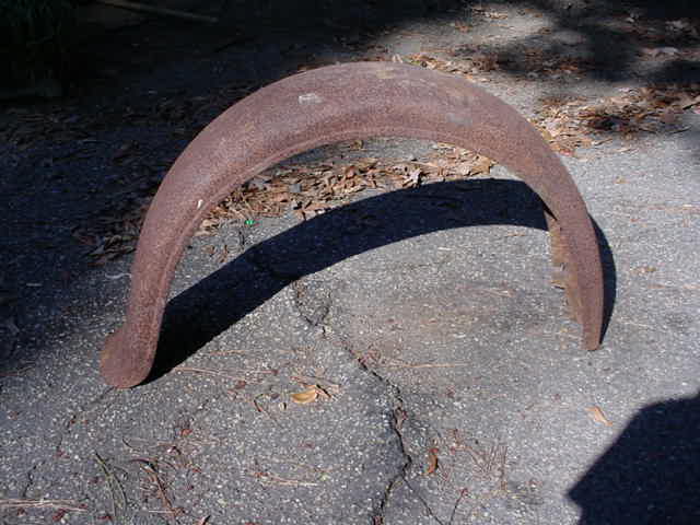

  9. The 28-29 fender on the passenger side.
    Reason I ended up with these is I bought them as a pair and the tipoff should have been how well they nested together when hanging on the wall of an old barn.
    Somebody had bobbed them and used em on an early 50's era hot rod.
    Then I bought a pair of good stocker 28-29's that I thought were 31's cuz they fit the 31 roadsters wheelwells ok.
    Then I realized the two bobbed fenders were a different width.
    The two stockers were run on my friends 28 roadster for a couple of years, he bought some nice re-pro's for it, so I got the fenders back and will be bobbing one or both of them for the 31.
    Sure is a lot of interesting education going on in this here hobby we're involved in.
