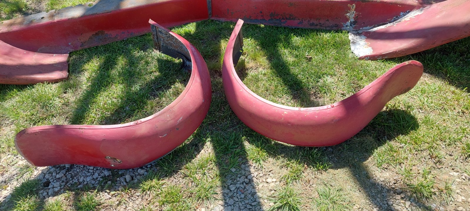

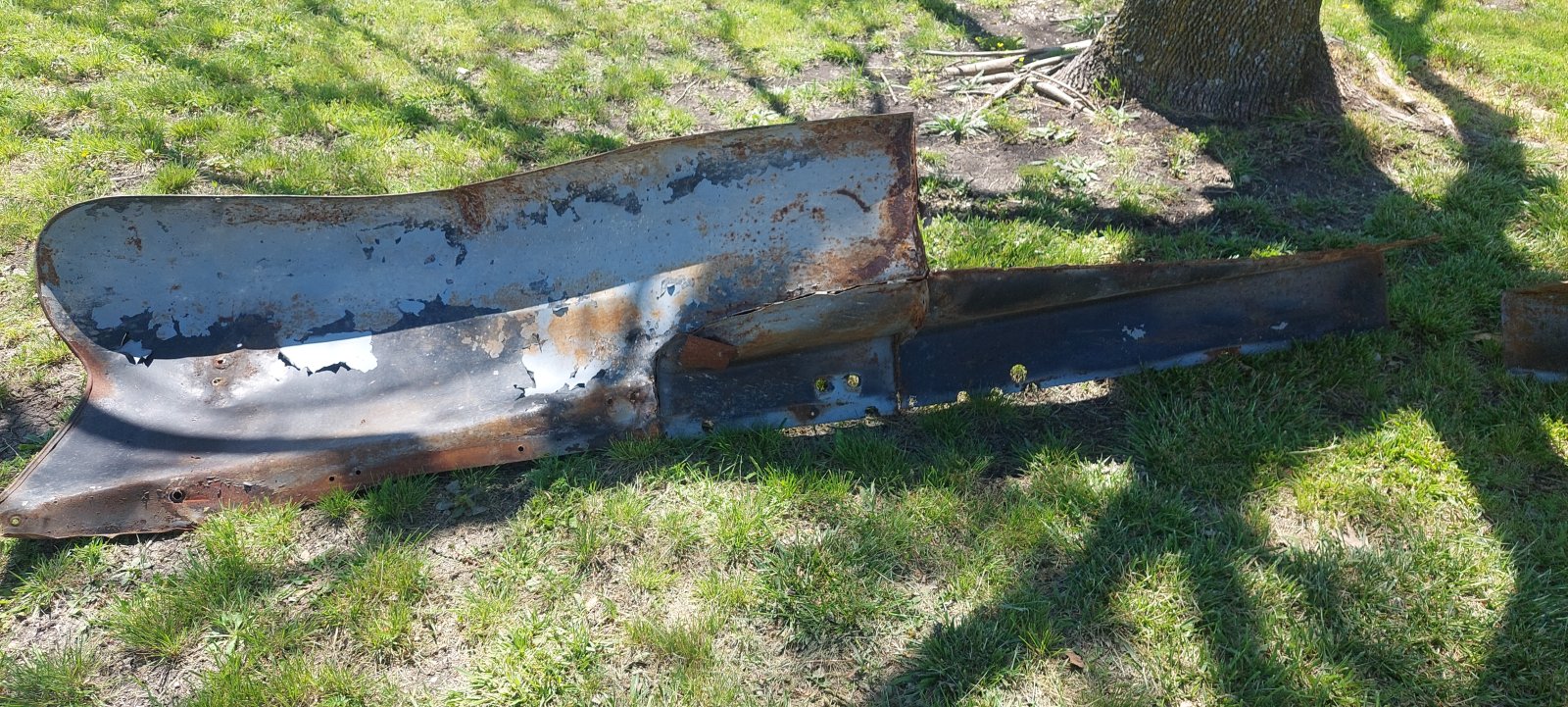

    @lamaison Thanks, can you ID what I have here ? @3 Winda' sorry for jumping on your thread. 20240405_112253.jpg 20240405_133433.jpg
  6. lamaison
    Joined: Oct 21, 2006
    Posts: 147
    lamaison
    from Canada
    Those are 1930-31

  9. Lone Star Mopar
    Joined: Nov 2, 2005
    Posts: 4,220
    Lone Star Mopar
    Well sheeeit... Mr @verde742 I'll ask you then. Can you tell from the ****py pics Ive posted above what year fenders I have are ? They are listed here in the cl***ifieds & Id sure like to make sure they're advertised correctly.
  10. A 2 B
    Joined: Dec 2, 2015
    Posts: 566
    A 2 B
    from SW Ontario
    Lone Star Mopar - They look like 1930 fenders to me. Kind of difficult to see in the pic but the splash aprons look to be the two piece variety, which are 1930 as well.

  11. verde742
    Joined: Aug 11, 2010
    Posts: 6,588
    verde742
    Do you have a close up of the aprons? Are you selling or buying ?
  12. Lone Star Mopar
    Joined: Nov 2, 2005
    Posts: 4,220
    Lone Star Mopar
    I am selling the fenders & using the ch***is for my project. The front fenders have been brazed to the splash aprons, then mudded over. Sorry for the **** pics. I can get better ones after work. Here are some you might be able to zoom in on@verde742 20240405_133313.jpg 20240405_133111.jpg 20240405_133059.jpg 20240405_133209.jpg
  13. verde742
    Posts: 6,588
    verde742
    yep its '30 's
