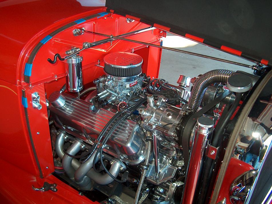

    from So Cal
    We had one made for the A from several pieces of sheet by a local sheetmetal shop. It bolts together. We needed more setback on the firewall for the 347.
