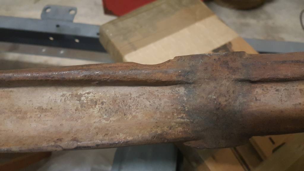

    The pictures show the shackle boss area of a model A front axle. The front shackles wore out so much that the spring was rubbing on the axle and removed a big chunk of material.
    Would you consider this axle still usable or is it junk?

    The axles are forged, fill it with weld and smooth it out. Just don't quench it in water after welding.

    Think of all the holes hot rodders have drilled in these poor axles over the years. As was suggested, weld repair it and let it cool normally. Sand/grind it smooth, and Bondo it if necessary.

    fill it with weld. The dropped axle on my avatar was S shaped. The press made it look good

    Repairable, but maybe easier to find another, better one.
    Wouldn’t recommend putting any bondo in it. Your car inspection people may not like that idea.

    I've done it . Welds beautifully very good quality steel. There would be no way an inspection would reveal the repair if done properly.

    That shackle wear is very common. Probably half the axles I come across have it to some degree. I wouldnt be concerned about running it as is. But if you dont like the looks, you can weld it.

    Weld it , grind it , file it , drill it , drop it , enjoy it you’ll never hurt it . Nothing comparable made today . Henry would be proud to see it still in service and repairable not throw away as in today’s world .

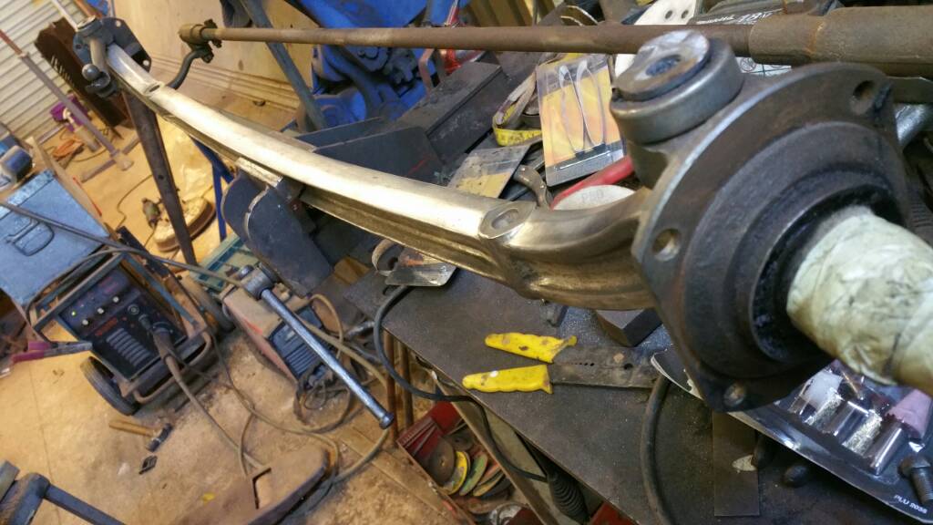

    [​IMG]I repaired this one yesterday. Filled with weld, ground, filed and sanded. Removing the factory imperfections while I was at it. [​IMG][​IMG]
