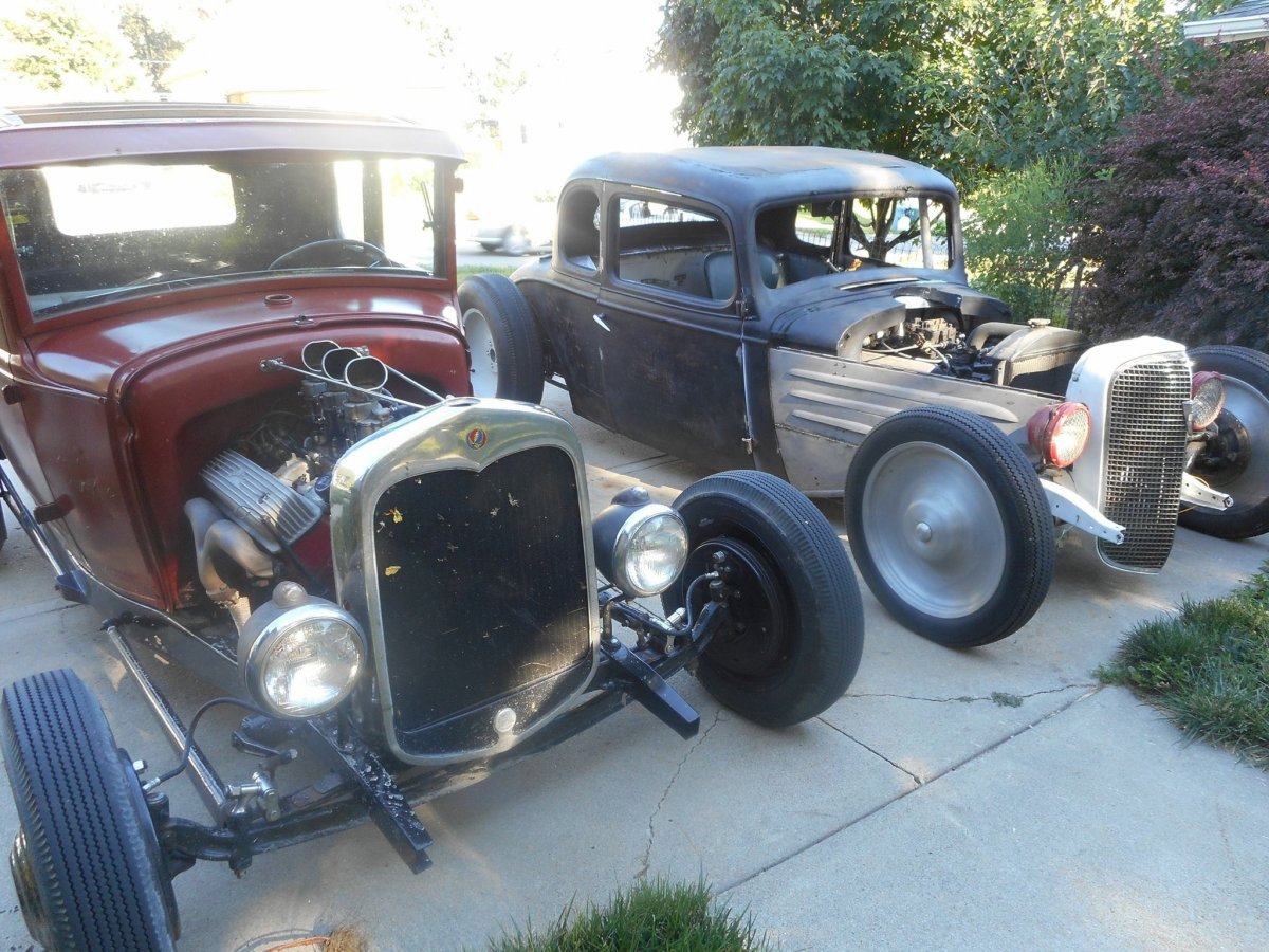

    Got a buddy in Omaha Nebraska with an A on a 41 chassis that’s been cut in abkoutnevery direction possible but it looks great! I’ll see if I can find some photos.
    It’s just metal ;) cut, weld, repeat until it looks right ;)

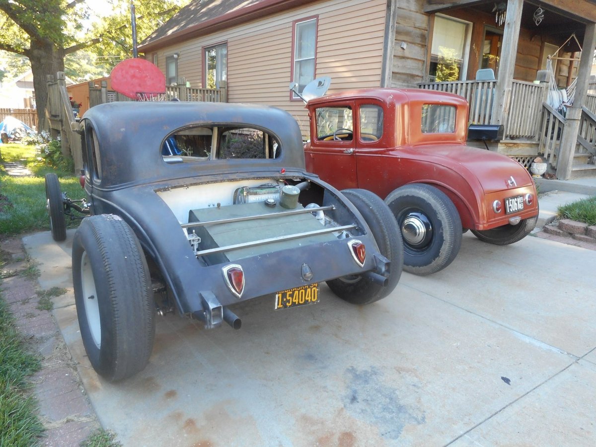

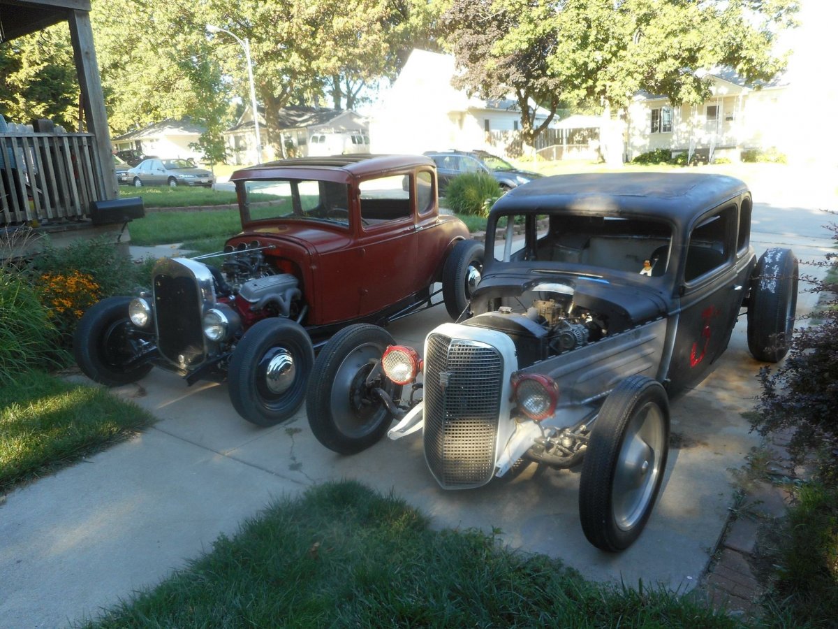

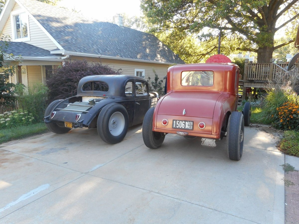

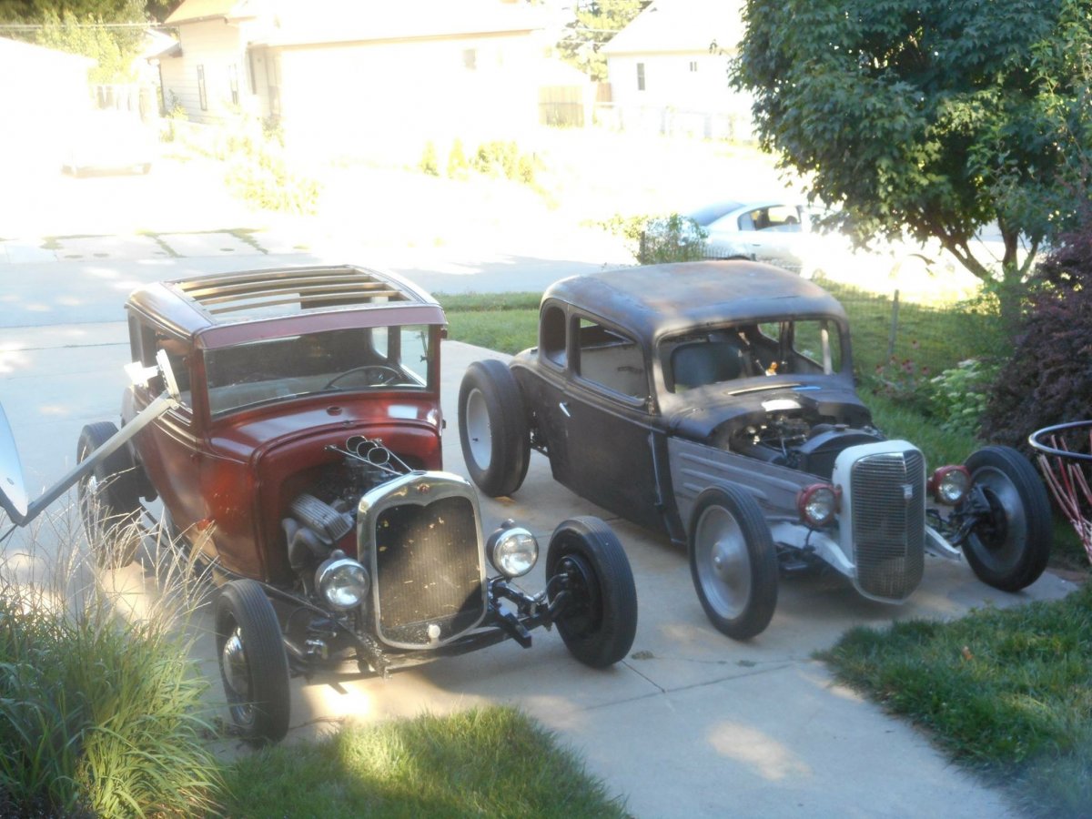

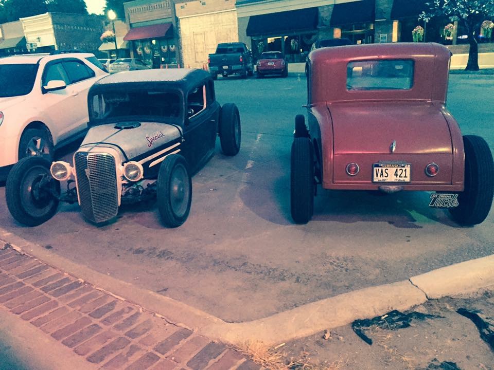

    It’s the red Y block powered one. Best photos I could come up with quickly. 60FF32FE-ED6F-49EB-AC94-33DA7A8590F0.jpeg AB9786F7-0BA5-4504-8D68-710EE5736BF5.jpeg CD690226-069E-4E1D-A641-57283BDE1515.jpeg 93E80EF3-DC11-4AA3-BD58-7D42DA7E0556.jpeg 0D0B0E94-8320-4C5F-BCCC-EDC673C91147.jpeg A89FC1B8-29A3-4B21-BDB1-06179701A605.jpeg

    Given that someone can come up with pictures of this within 45 minutes I'm guessing it has been done more than once. Thanks Tim! That red car looks sweet. I am guessing that the frame rails have been narrowed and pinched to match the body? It doesn't look like the body has been widened, but it does look like the bottom of it has been shaped to match the curve of the frame rails?
