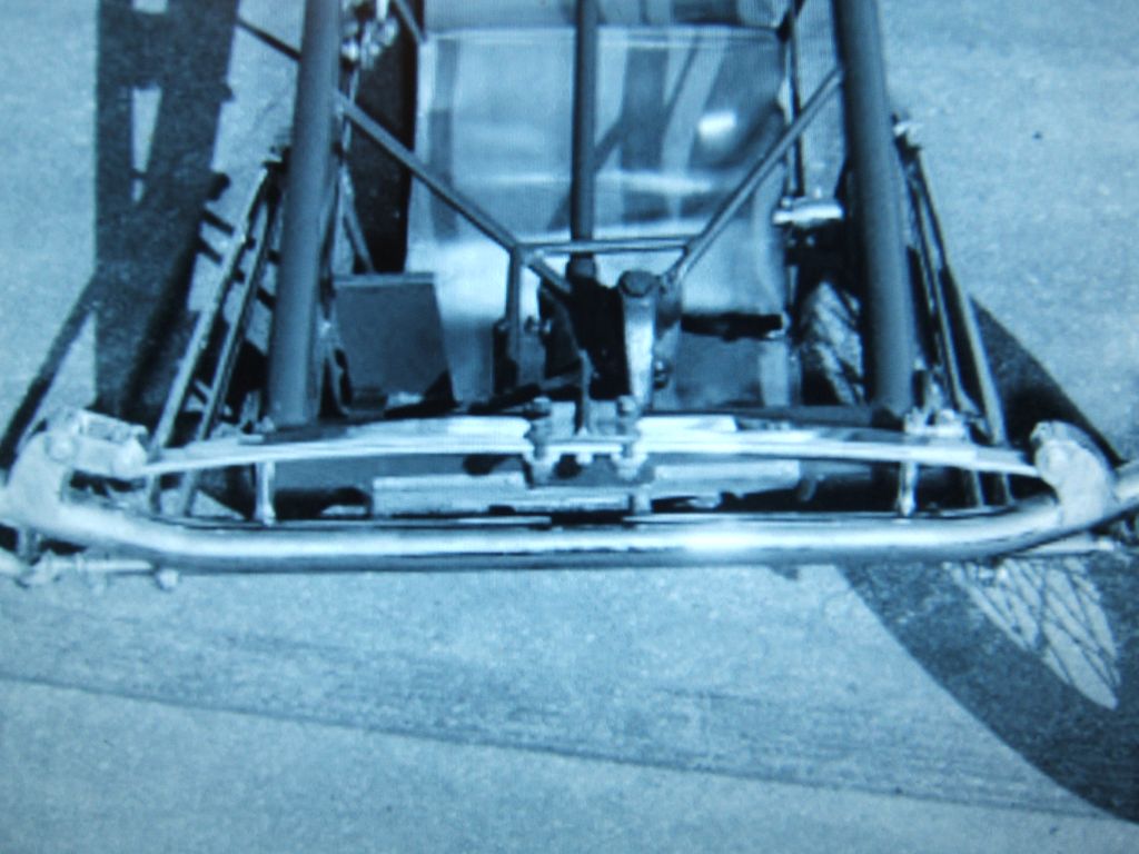

    Here's a pic of one on a center steering box

    Now if you look closely at the picture I posted the pitman arm goes forward and under the center spring perch , it appears that the drag link is to the L/H side of the car [ the same side of the dead perch ] But it could also be split tie-rods in the photo, it is difficult to see clearly
    If you look at most Sprintcar / Midget / Indy Roadsters [ even modern Sprinters] you will notice the all have cowl mounted steering boxes ,so a dead perch would not contribute to any mechanical bump steer.
    All US oval cars and Indy cars turn left on the ovals as far as I know.
    A dead perch should be treated the same way as a panhard bar!
    You NEVER have a panhard bar on the opposite side to a drag link, pivoting on opposing arcs is a recipe for bump steer
