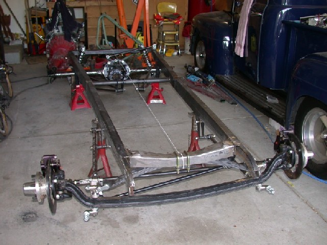

  8. 52 Pickup
    Joined: Aug 6, 2007
    Posts: 57
    52 Pickup
    from Oakley, CA
    I used 2X4 mainly because that is about the same as the original size. I did trim the front to taper into the frame horns like stock but left it full size at the rear and just notched the end over the axle.
  9. road_king
    Joined: Aug 9, 2007
    Posts: 13
    road_king
    from US
    Thanks for the reply I did measure my original frames and it is 4" thick at the widest point like you said thats why I was between the two sizes. I guess either will work fine, btw nice pic of your ch***is.
