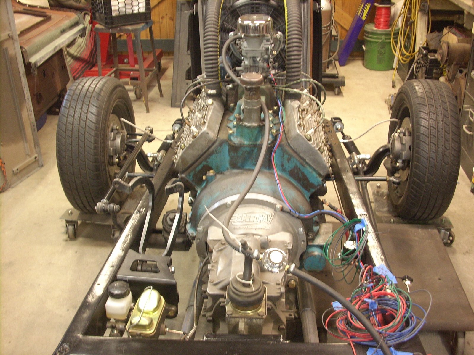

    A modified F-2 Ford truck and pedals in this A-V8
    Pat

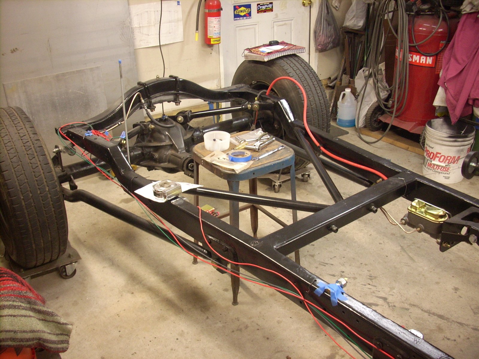

    Built with shop leftovers- Tardel? $500. and wait. This? maybe 40 bucks worth of stuff from the cut-off bin and a days work. Might not look as fancy, but it works fine and the money went to other stuff I couldn't make. ****** mount I made bolts to the center crossmember- basically a "box" made of angle iron, gusseted, with the rubber mount bolted to the bottom ; easy weechie. I don't know when "hot rodding" went high tech/ big buck-- originally cars were made by borrowing, trading, , and trips to the Midnight Auto Supply! Gas welded with coathangers, or drilled and bolted ( I shudder to think!)In 1955 , kids didn't have squat for money; you had to be creative and, yes, sometimes "bend" the rules a little. (e.g. "borrow" tires or a battery from the junkyard, etc.) You can do it!
