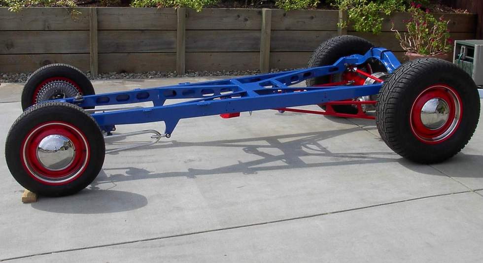

I built a Model A frame and finished is earlier this year. Will be putting a 31 Coupe on the frame and blown flathead. I used a Dagel's Street Rod X member and boxing plates, made oval holes in the boxing plates to match the X member, Z'd the rear 3". Here is a picture or two and link to some of my earlier pictures on another site; http://groups.msn.com/FordFlathead1932to1953/cobraschopped31av85window.msnw So..................what do you want to do?????????????????????????
http://www.jalopyjournal.com/forum/attachment.php?attachmentid=367532&d=1192928461That is a very cool chassis! The head on view is unbelievable. It will be a shame to cover it up.chuck
It sure looks tuff. When you kick up the rear cross member on a model a chassis with the stock spring do you need to cut out and raise the trunk floor or is there room for the 3" kick? chuck
