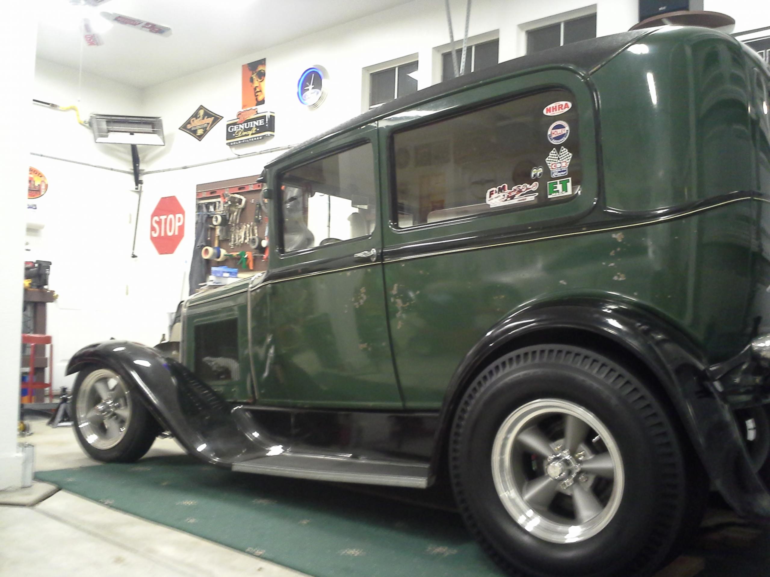

    I have a bbc in my tudor. Of course there is more than one way to do it, but the way I did it severely cut down the gallons the tank would hold if I were to use the original tank. And mess with the original gauge. With my tank gone, that space is used for my gauges , glove box, fuse block stereo, etc. You can check out my build thread to see the way I did it. A bbc in a model a is a tight fit. Good luck! http://www.jalopyjournal.com/forum/showthread.php?t=653879
