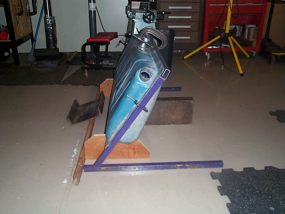

    Smilin Jack. I cut down a late 60's early 70 Ford F100 tank, sectioned about a foot out of the middle and installed it behind the seat in my '29 roadster. Still has room in rumble seat certainly for smaller passengers.
    For what it's worth, I'm very pleased with it and the location. I also moved the filler to the center.

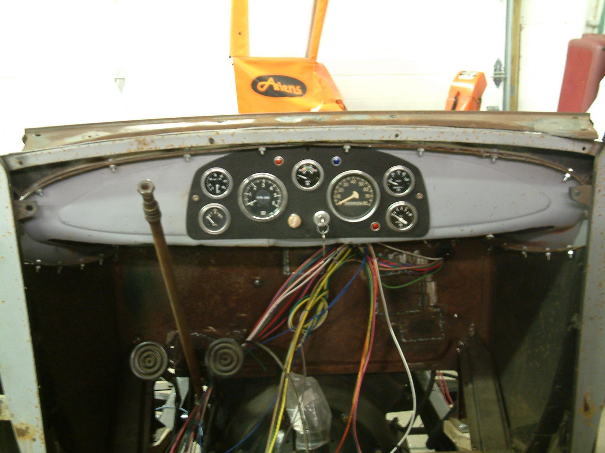

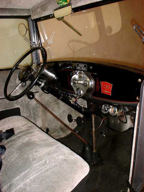

    Looks like you've already made up your mind but I thought I'd add my 2 cents since I'm the only guy responding that's using an A tank.
    There really is no problem using a good Model A tank. I've been driving this car for years with one. Absolutely no fuel smell at all. I replaced the old shut-off valve with a good quality stainless ball valve and I shut it off when not driving. Reason being, the tank is above the carbs and there is always a little push on the fuel due to gravity. It's not enough to seat the needles in the carbs and they weep a little otherwise.
    As far as fuel gauge goes, I turned down a SW sending unit mounting plate to fit in the original gauge opening. This cuts off all the holes around the edge. Then I bent the cork float stem 90 degrees to reach the bottom of the tank...works like a charm.
    Counter to what's been posted here, there's still enough room to use a 32 style dash in front of the tank with lots of guages. All my wiring is routed behind the kick panels and under the seat. the fuse panel and the dry cell battery are behind the seat. ..leaves alot of room for trunk storage.
    It's hard to tell from the pics but the firewall is recessed 4". The recess is all below the tank.

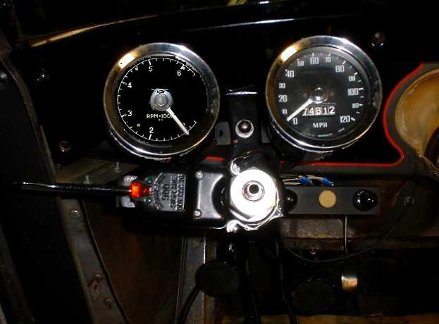

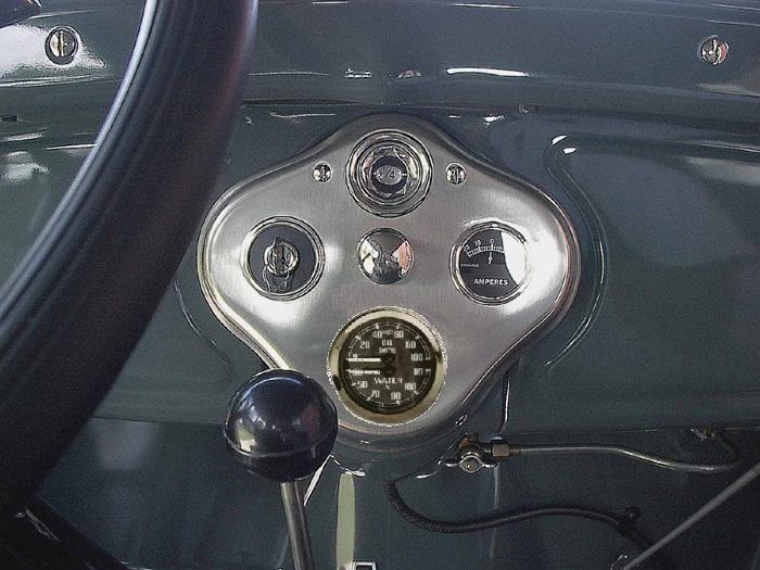

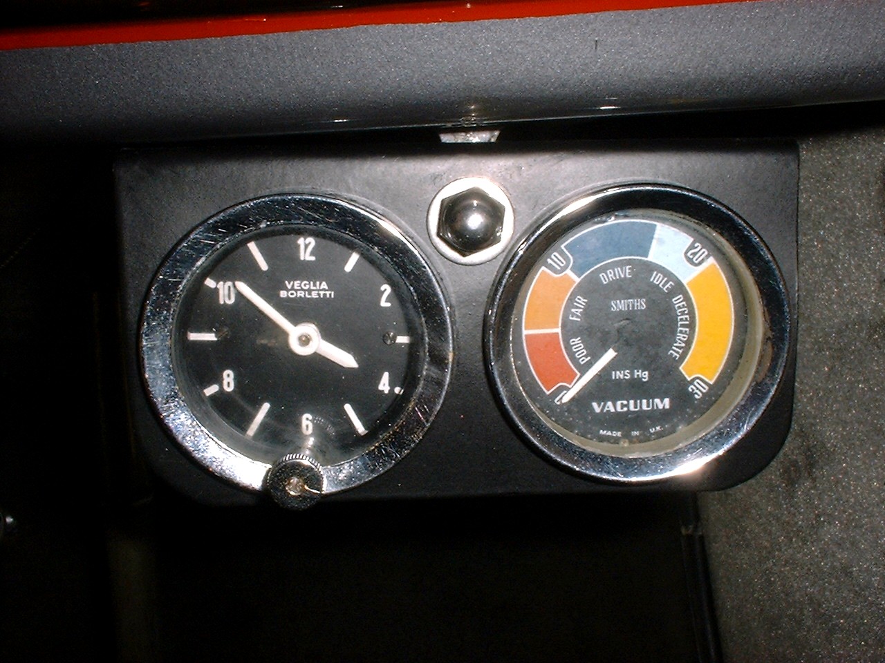

    It took a little finagling but I used the original tank in my 29 coupe (running a flathead), even kept the stock fuel gage and ammeter. I made a new face plate for the instrument cluster, replaced the stock speedo with a Smiths dual mechanical temperature/oil pressure gage, mounted a Smiths tach and speedo on the column and hung a Veglia Borletti clock and Smiths vacuum gage from the old choke mount (The instrument cluster and and tach/speedo pix are early photoshops but the final product looks just like them). IMHO, still the safest place for the tank in these cars and the cool factor was worth the effort.
    I tried to convince myself the gravity feed would be fine for a flathead but there just isn't enough head with the stock tank to even keep up with the 2 psi Holley 94 supply requirement and the flow demand at highway speed. Ended up putting a stock mechanical pump back on the engine.

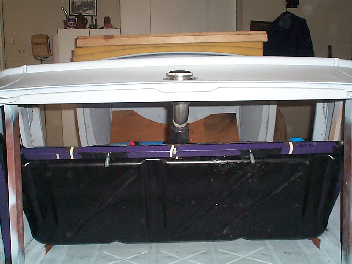

    Save your tank and resell it. Buy another that perhaps has already had the tank portion removed or leaks.
    Here are some shots of my F100 modified to go behind the seat. There is room underneath for passengers toes. I built a frame work out of sq. tubing.

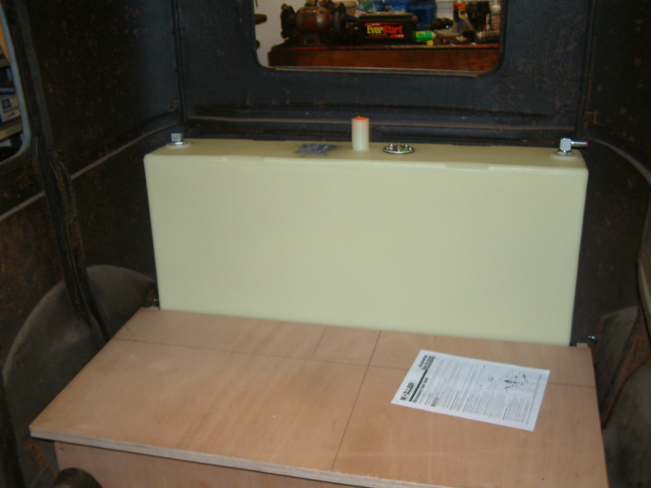

    I have been working around the same problem. Stock tank was already cut out so I filled the dash hole with a gauge cluster and put the electrical system back there.
    Found this tank and got it today, should work great as it's 18 gallons and I'm going to build an enclosure for it. Need the room for a rear seat of some kind for the grand kids when they come over.
