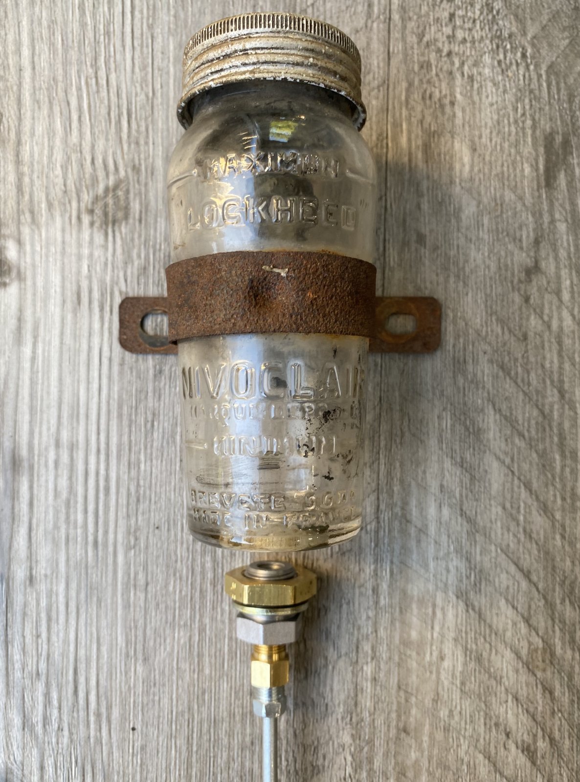

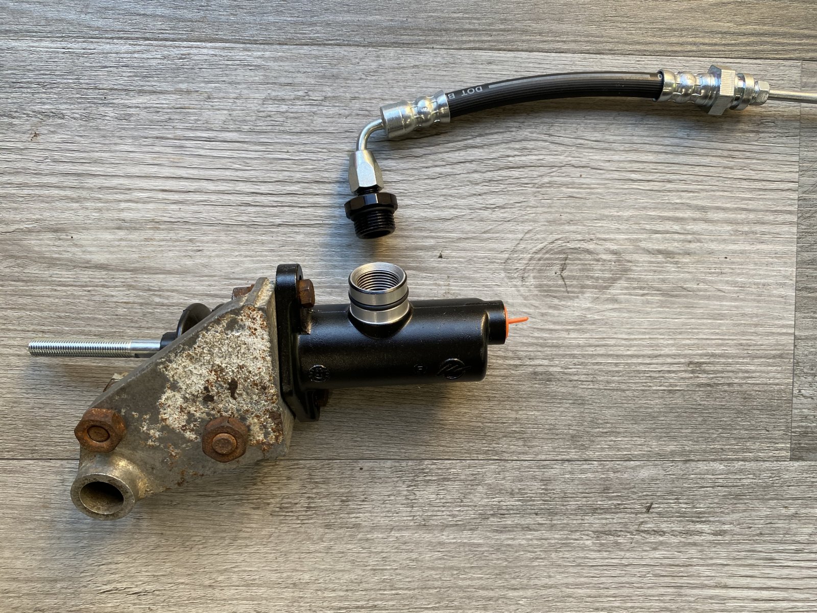

    Picking away at it. I’m having trouble finding a fitting that will work from the old gl*** reservoir to the new master- but will figure something out eventually. The hard lines are next. I’m waiting on a buddy to make them up then onto the rear end.

    sdluck
    Did you try Royal Br*** in San Jose?
    BRENT MAGGI likes this.
  7. BRENT MAGGI
    Joined: Sep 26, 2021
    Posts: 216
    BRENT MAGGI
    Yeah I’ve been down there three times. They were going to have to stack a bunch of adapters to run a solid hardline- so I ended up having them make up 4”of soft-into a hard line where you will see it on the firewall. it should look- work good. What a pain in the *** though!

  12. BRENT MAGGI
    Posts: 216
    BRENT MAGGI
    I would have liked to have found a old master cylinder but couldn’t figure out what was in the car. Hopefully not to many new parts will have to be used but I can’t save everything.

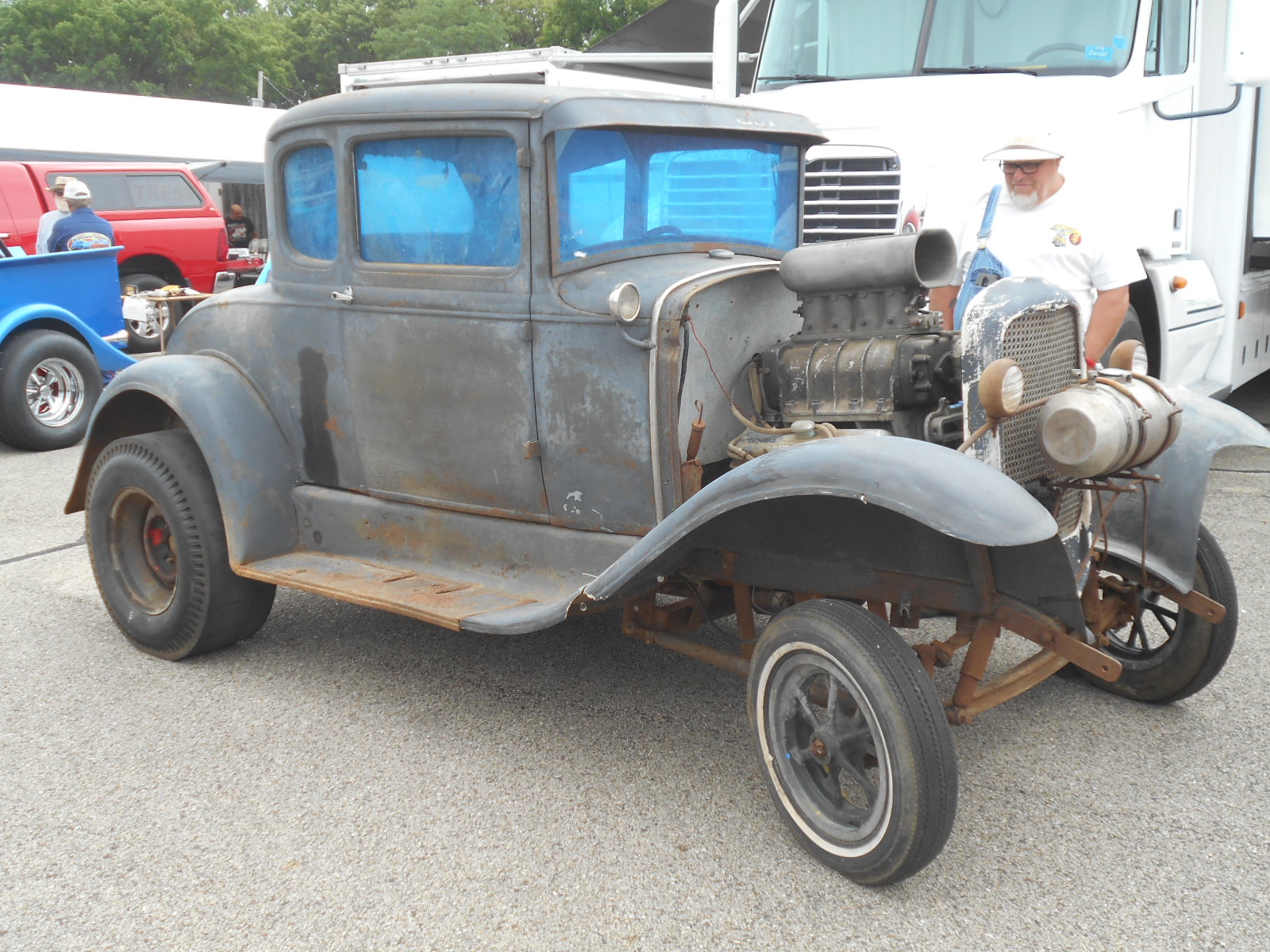

    yes, this was at 2017 Meltdown Drags,...awesome car!

    I saw that coupe at the Meltdown drags. I aske the then owner if he planned to restore it back to it's original race condition or just get it running. His reply was it was to far gone to do either. Im sure i was shaking my head as i walked away.

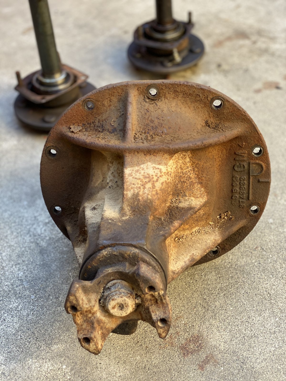

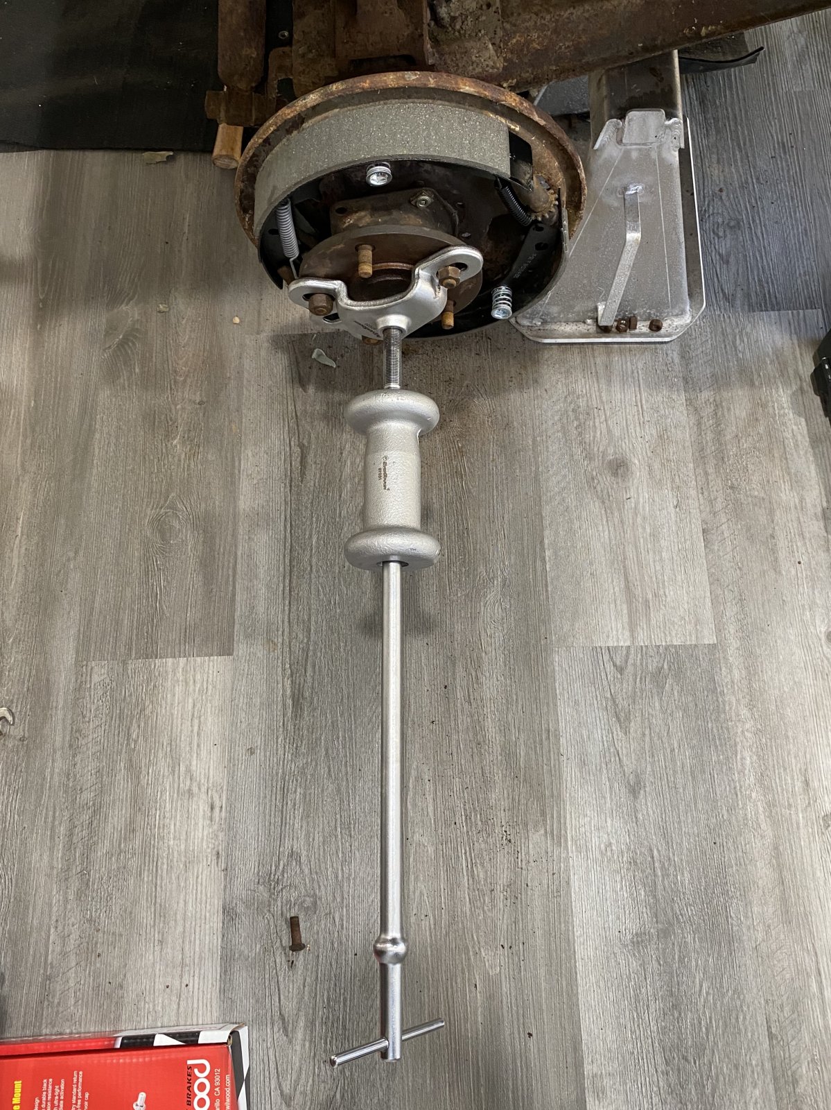

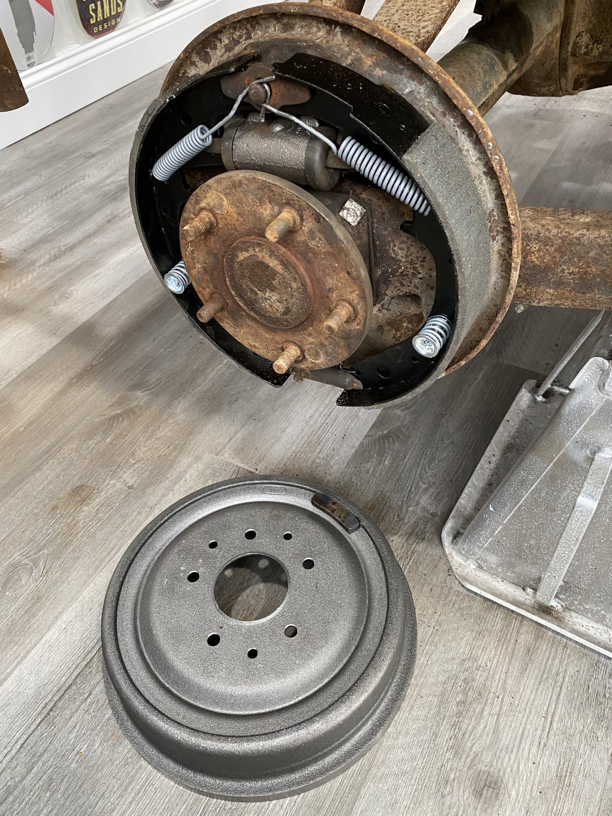

    He actually called me when I first got the car and said he would like to buy it back! Got the axles out today.. one came up easily- the other I ended up having to rent a slide hammer. The bearings and seals will get replaced. I haven’t decided if I’m going to do it or just drop it off and be done with it.

  21. sdluck
    Joined: Sep 19, 2006
    Posts: 3,332
    sdluck
    Axel tube may be bent,you couldn't reverse the brake drum with the lug nuts loose and use that?

  22. BRENT MAGGI
    Posts: 216
    BRENT MAGGI
    It came out just took a few hits

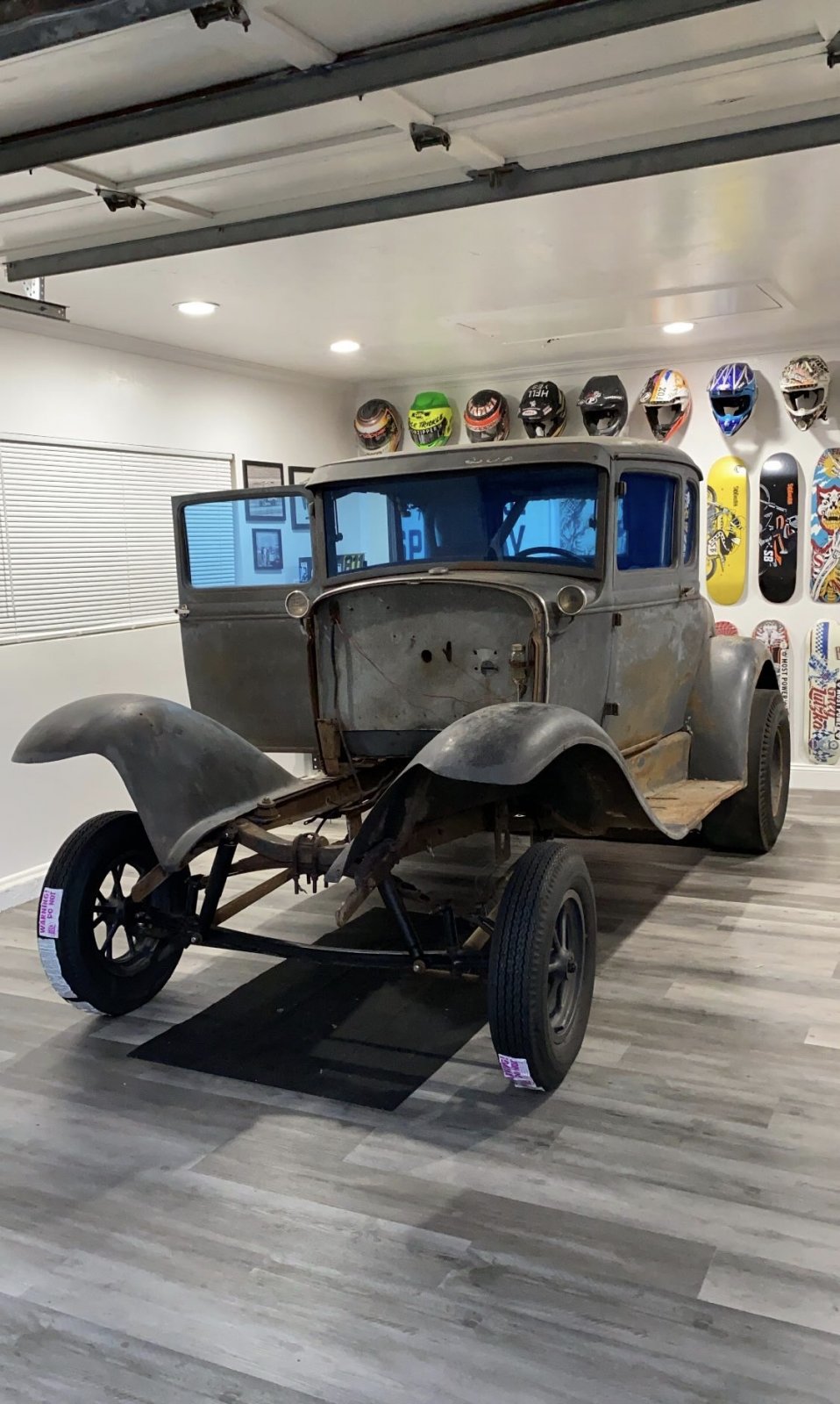

  24. BRENT MAGGI
    Posts: 216
    BRENT MAGGI
    It rolls, stops and steers now. The rear end is rebuilt, the axle bearings were a pain in the ***! The rear brakes seem like they should work good. I didn’t want to put new shocks on but the old ones were blown out. The blower got completely rebuilt. The injection just needed new lines, I haven’t heard anything else on the motor yet. I want to mount the radiator and grill shell next. Has anyone came up with a way to mount them without the struts? 6AEB3C60-EFD5-43DC-97C3-7F68718466DB.jpeg

  27. mad mikey
    Joined: Dec 22, 2013
    Posts: 9,532
    mad mikey
  28. BRENT MAGGI
    Posts: 216
    BRENT MAGGI
    I like that way better then running them to the firewall.
