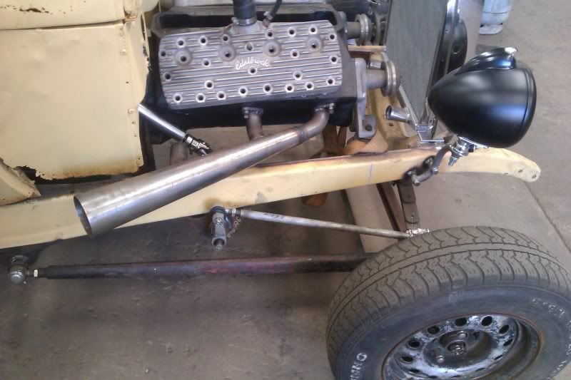

    Okely Dokey...
    So today I decided we needed to hear it with pipes on... So lets make a set of pipes......
    Sweet we now have pipes....... So we fired it up me an Poiter (Ol Man) playin around number 4 still givin us the ****s when low and behold she coughs and says no more....great spray of oil out of where the fule pump should be and nothing..............

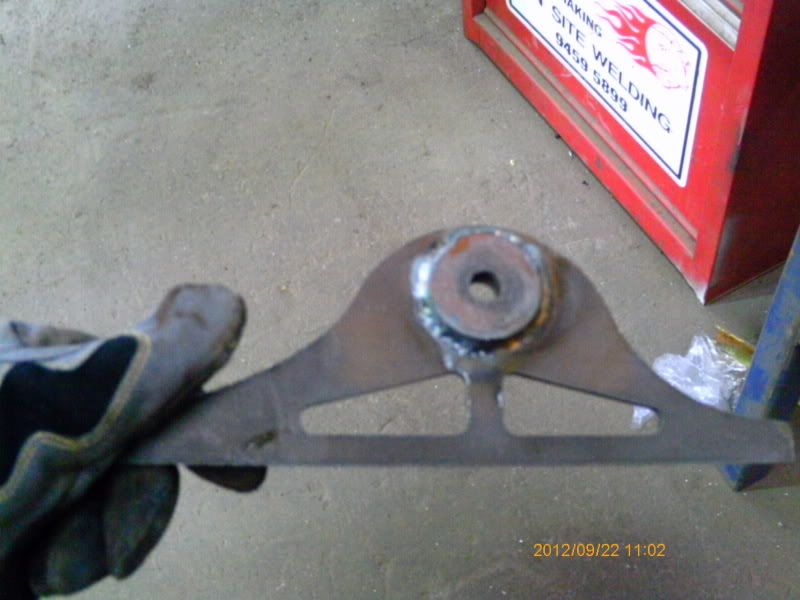

    Welcome back to your latest IKEA flat pack rods a subsiduary of LONG DONG RADIATOR company Tm.
    Here at flat pak rods we are considerate of your time poor society. So while your all tucked away in bedy bies with ya hand on ya gland dreaming of all things traditional our worker elves are slaving away getting sh it done!!
    Ch***is welded up lookin for the next piece of the puzzel...

  25. what front crossmember are you using and what are the specs on the front spring? Looking good by the way!!
  26. SniffnPaint
    Joined: May 22, 2008
    Posts: 434
    SniffnPaint
  27. cakes
    Joined: Sep 29, 2008
    Posts: 570
    cakes
    Neat, keep it up
  28. draggler
    Joined: Jan 6, 2007
    Posts: 238
    draggler
    Looks kinda purdy sittin there in all her unfinished glory.
    That piston reminds of when you eat hard candy with a decayed tooth!
  29. benflathead
    Joined: Nov 15, 2007
    Posts: 249
    benflathead
    front cross member is from about a 40's truck. Spring is made to suit the axel width.
