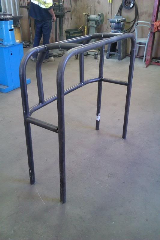

    Now due to my lack of skill when driving I thought some protection might be in order.........

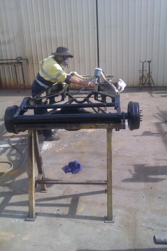

    Bit more on the old girl.
    Had to brace up around the booster and put a couple of gussets in the bone mounts and finish a couple of welds and then a coat of reconditioning black.
    And yes if you look closely in the last pic you can see the RAG filtration system in use.

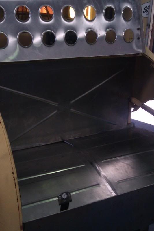

    Air powered punch and joggling tool. Works great for spot weld holes!
    Floor in and battery box and fuel cell mounted.
    Filling in some holes as I need to run it this weekend. Will go back to the body later in the year.
