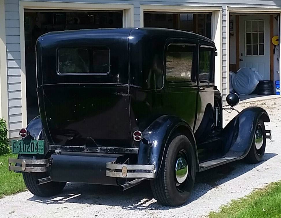

    I've seen lots of variations on the theme.
    Home built, purchased, '32 tank on the rear and Model T tanks in the trunk area.
    I have a '32 at the rear on my '28 Tudor and stock tank on my '29 coupe.

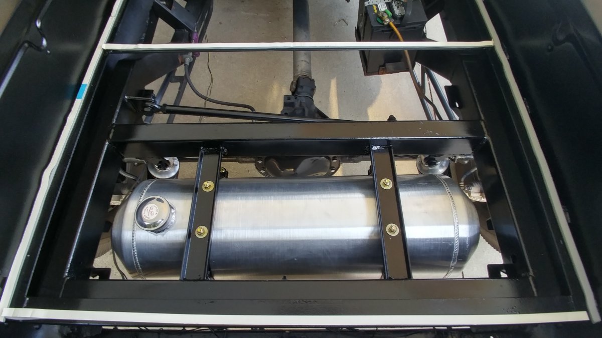

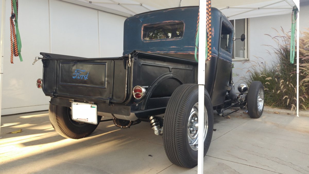

    I didn't want to put the tank in the bed of my truck, because I actually use the bed to haul stuff once in awhile. I mounted it instead behind the rear crossmember, and put an access hatch in the bed floor.

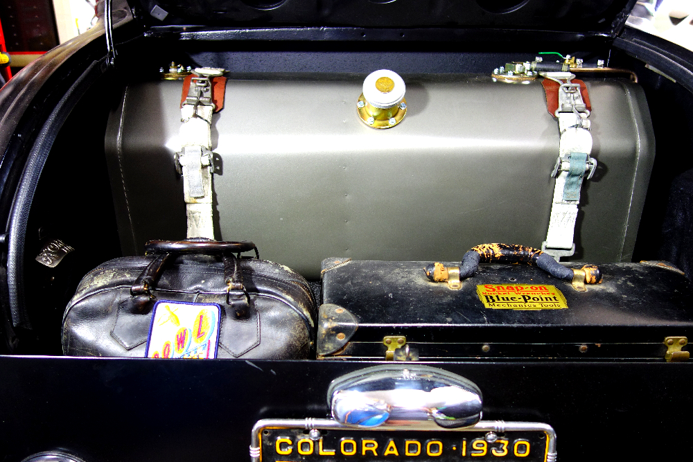

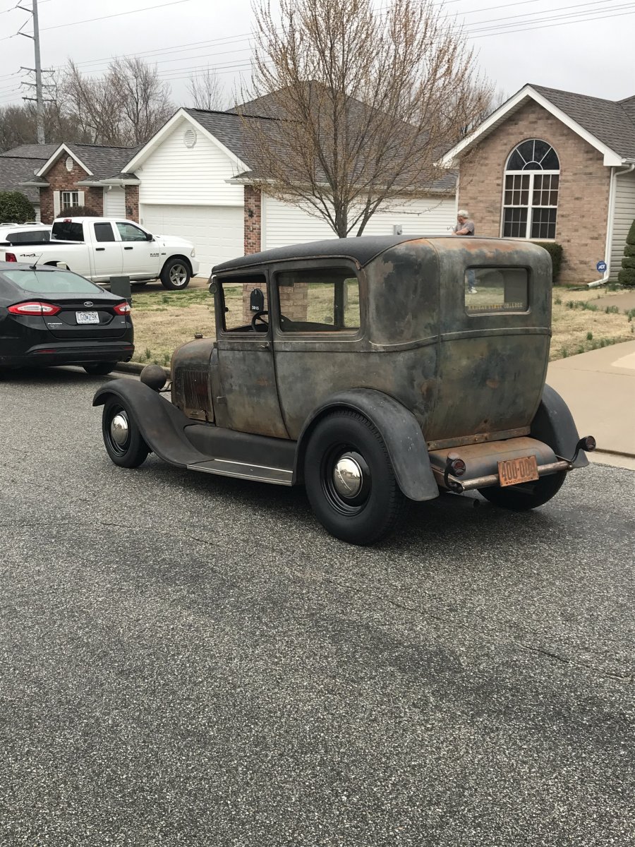

    My 29 has a homemade 14 gallon tank mounted in rear.
    Came with the car and was just a square box when I got it. It just didn't look right square and all when the cars lines are rounded.
    After considering a aftermarket 32 tank, I bent up some 20 gauge sheetmetal to cover the tank and make it appear more 32ish.
    To make it seem a part of the car, I brush painted it with Rustoleum as the rest of the car was brushed years ago.
