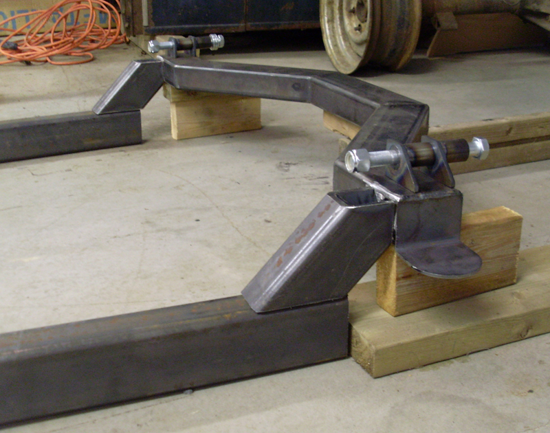

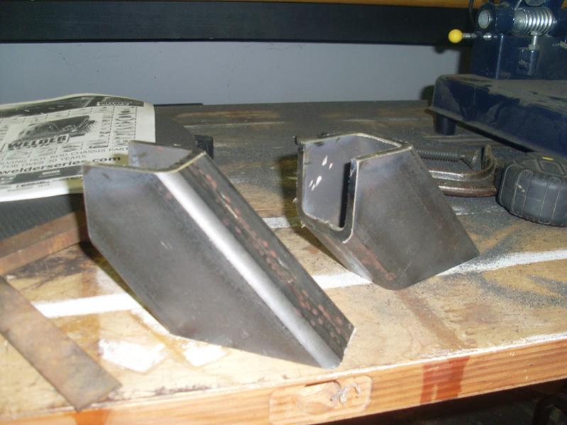

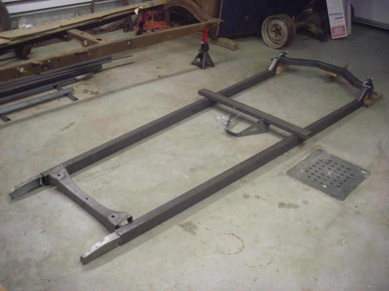

    Hi, I have a question concerning the rear section of my model A frame. First I wanted to reproduce the "TCI" repro frame type with a model A 28-32 front crossmember and adj.coilovers in the rear but I'd like to have just a bit lower than all the repro frames out there without "Ze'ing" it. A friend of mine suggest me to make a 2 inch kickup in the rear. I made brackets to join the rear crossmember but I'm wondering if the front is gonna be higher than the rear if i'm doing it this way. Am I gonna have to lower the front more than a Xmember/reverse eye/4"drop axle setup? Your advice please.

  2. One of the first things 32 guys did to lower the front of the 32 chassis was to transplant a Model A crossmember. The picture looks like the front crossmember is even flatter than a Model A piece.
    You might end up with a car with a flatter stance vs. hotrod raked by having the Z in the rear. And also the Z in the rear will also create the need for more rear body mods in the subrails, etc vs. having a flattop frame.
    Pick your poison. Tack it up and mock it up if you need to see to answer some more of your own questions. Make yourself happy and then deal with the flack if ..................... you know the story. Your car and money. Learn and build wisely.

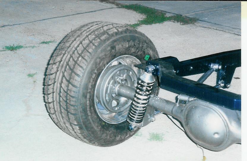

    I don't think you will have a problem, it will still sit down in front. I have an older Chassis Engineering frame that has a 3" kick-up in the rear and a reversed eye, 4" drop axle in the front. It has a stock style Model A front crossmember. It looks like the one in your picture. It sits with a front down rake. It will also depend on the wheels and tires you choose. Your main problem may be, as stated before, is with the sub-rails. The Chassis Engineering frame is narrowed in the rear, so the frame fits between the sub-rails.

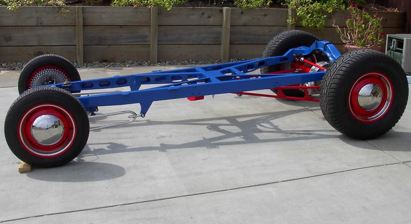

    Here's some pictures, not the greatest, they were taken before I had a digital camera.
    Red

    I think the rear Z you have and the '32 front crossmember will give a good stance with the right tire sizes. But I don't know what kind of stance you're after.

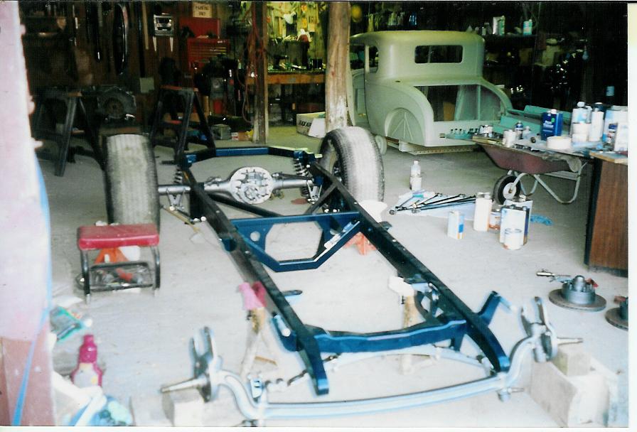

    This was my stock Model A frame with a '32 Front Crossmember and stock rear crossmember. I used a 3-1/2" dropped Model A axle and a standard eye Model A front spring. It had 7.50-16 rear tires and 5.50-16 Front Tires. In these photos the rear of the frame was just sitting about 4" over the 9" rear axle. I planned to Z the rear, but never got to it before I sold the project. Even after Z-ing the rear only 2-3" it would have sat at this stance you see in the photos after the suspension was complete and the body was on. I could have brought the front down lower with the reverse eye spring but felt it already had the rake I was looking for.

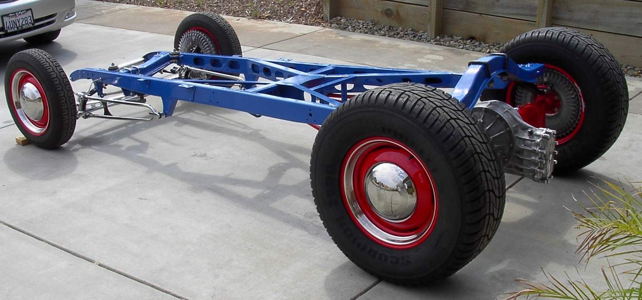

    Here are pictures of my Model A frame with Daggel's X member. It's Z'd 3" in the rear and the used the stock Model A cross member, reverse eye springs both front and rear and 4" dropped axle.

    The way you have it there (stock front crossmember, kicked 3" (?) in the rear) will sit great. Remember coilovers have a designed ride height (yours are probably 13") but you do have three options on the lower axle bracket mounting hole. That looks very similar to hundreds (& hundreds ?) of Horton Model A chassis we built over the last 30 years or so :)
