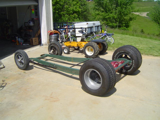

    Yes, this is my first "A" frame. It was totally stock and I used Dagels Street Rods X member, boxing plates and brake setup. Since I am using a C4 I only have one pedal.
    I don't know about a work of art, but it is built to withstand a ton.............and the body/cowl or radiator shell will not flex at all................I wouldn't be afraid to put the motor out of the boat into it and put the pedal to the metal............

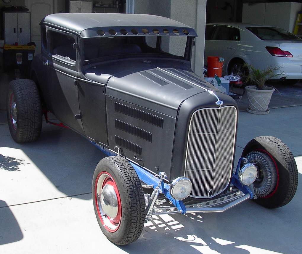

  8. It's all preference my man, what ever floats yer boat! I like em all... My personal 29 roadster will stay on its original frame. I want it to have an earlier feel and think the A frame makes it look more bare bone, or a kid with less bread.
    I dig a lot of 29's on 32 frames as well, Keith Weezner, Zach's, etc...
    This Sedan happens to be the 1st car I ever bought and my very 1st chop. I just bought it back from the guy I sold it too... sat for a bunch of years inside, weird that she is back home. The primered 30 chop was done by someone else, and I hate it.
    My customer wants a 32 frame, so thats we she's getting. Luckily I had a 32 frame with out a front crossmember in it, and I saved the K member for a future project.
    In the pics you can see that you need to narrow the front crossmember a few inches, we opted for a little channel as I too think the 32 frame is a little wide for a narrow A body. Just my taste. Plus, with this mild 4 inch chop, we need to get her a little lower to give the car some toughness.
    Good luck with what ever you do! Its all cool...
