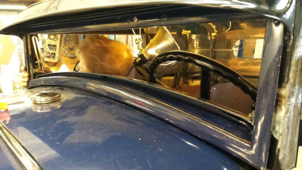

    Loudpedal got the windshield frame all lowered to spec! And mounted

    Kris finishing up the windshield frame.

    What did you guys do to line up the A pillars as you look at the car from the front?
    With the three I have done, as you lower the lid down, it is about a half inch wider than the posts coming up from the cowl. I know guys porta power them out but I always thought they would have a kink in them.
    My solution is to cut the ends behind the dash rail and that allows the cowl to flex outwards to match the top without putting an angle on the posts.

  30. JOBCORP
    Joined: Jun 16, 2004
    Posts: 297
    JOBCORP
    We used a port-a-power and unbolted the tank. Then split the dash rail( under the inside dash) I don't have that picture. Then we had the problem of the actual dash. It was now 3/8 too narrow. We debated on moving all the holes but still would have had gaps on both sides. Our solution was to split the dash in two places so all the holes would still line up. See photos! ImageUploadedByH.A.M.B.1392268285.084093.jpg
