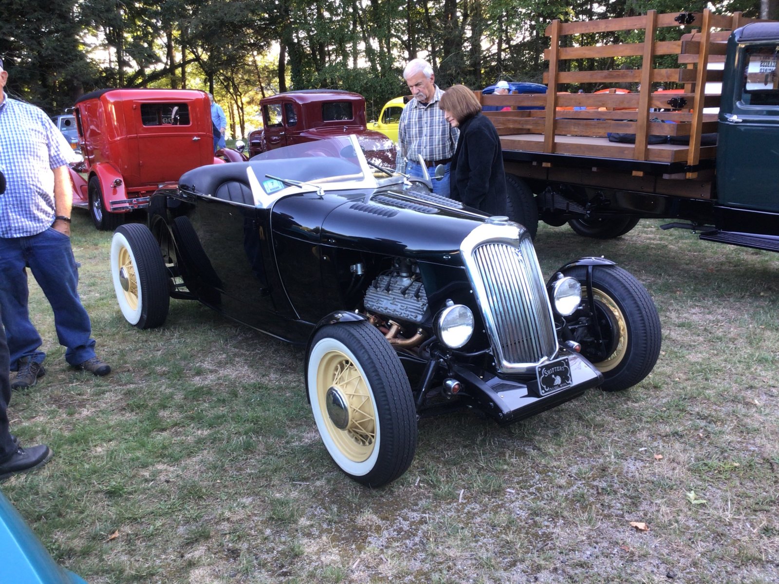

    Although two piece windshields on roadsters do not seem to be popular items here, I love the look and have loved driving behind mine for many years. There is much less air turbulence (noise) in the ****pit than with a flat windshield. The disadvantages are getting yourself to sit low enough in the car so that flowing air goes over your head instead of in your eyes, and the difficulty of designing a top that provides headroom inside, attaches to the windshield in a good way, and still looks nice. I encourage you to purchase a windshield, and make it work. Enjoy the journey. HFH. 3ADA05FE-7E6A-4538-8742-7DEEA1792DC2.jpeg

    Is that a Riley grille? your car looks super nice.

    Yes, it’s a Riley grille that was given to me many years ago. I’m also not very tall. I made my windshield out of wood, got a pattern maker friend to tweak it (for shrinkage) and brought the pattern to a local foundry for casting. Good luck with your project. It would be great if you could post some pictures of your progress.

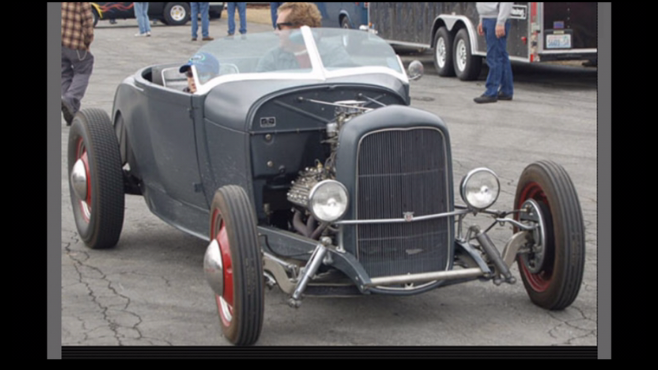

    Here’s one I built about 23 years ago
    Rob Miller windshield
    His pattern was taken off an original Duke Hallock frame Most I see don’t have a nice sweeping curve on the top edge of the gl*** 838CEEDC-4FB0-480C-9D3E-1AC964EE6804.png

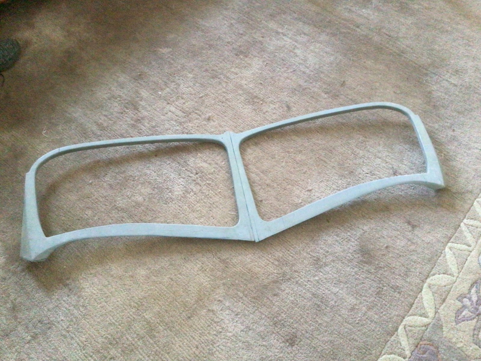

    Evening. There was once a Model A RPU body builder. Let's say his name was Last Refuse. I bought a body from him, that was a story, but it came with his "Halleck, Duvall, style" windshield. That was not what I ordered, I wanted a regular gl***. I have straightened out my issues and have a flat gl*** windshield but have never taken that one out of the box. If this would help you I would be in for $200. and freight.[​IMG]

    By the look of it I understand why you didn't take it out the package. Sorry.

    F-head, that’s a beautiful roadster that you built! I’m wondering if you still have it and if you ever worked at making a top for it. I have to also say that I loved seeing pictures of your ‘41-‘47 transformation. The chop improved the lines of the car immensely. You certainly got it right. Thank you for sharing pictures of your work. HFH.

    Thanks for the compliment, I sold the roadster around 10? Years ago, it lives in Spokane now
    Never built a top
    Still love the Hallock W/S though

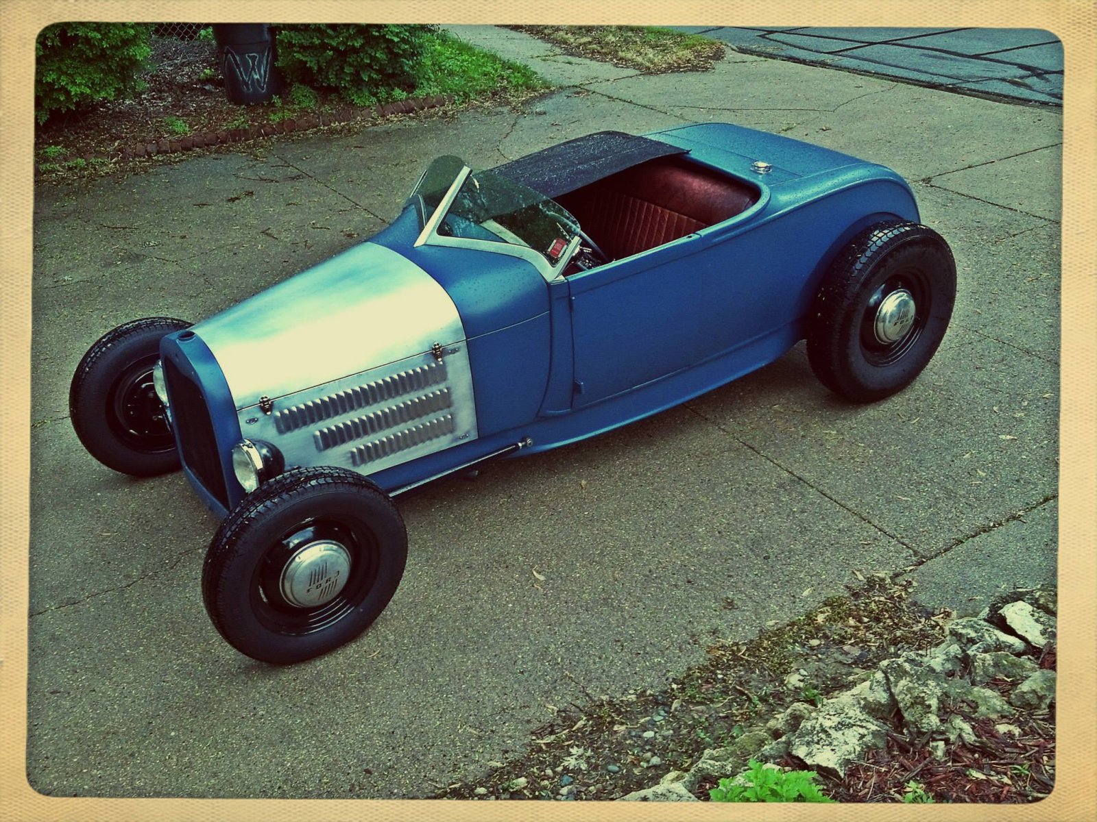

    @jackandeuces Is that an O'Brien?

    Yes it is OBrien...

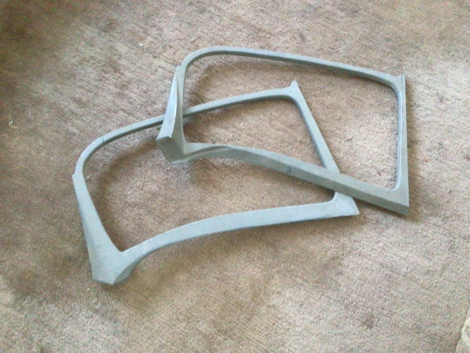

    B2143347-0719-4E70-A4FD-79FD586DB3C1.jpeg These are the patterns I made about 30 years ago. I’ve made three windshields. The first one was bronze and the others are aluminum. On the windshield I’m currently using I cut the tops off the castings so there is no metal over the top of the gl***. Milling for gl*** is done after the castings are made.
