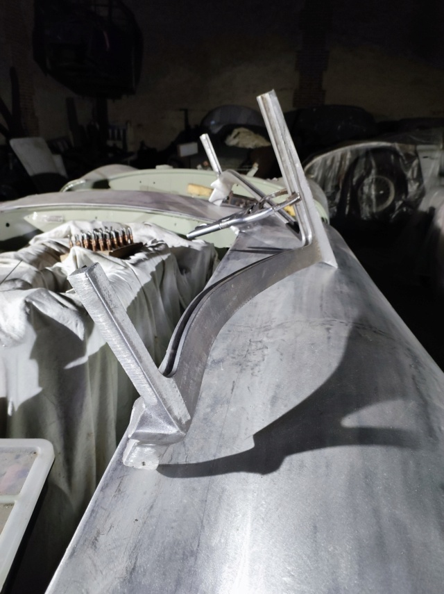

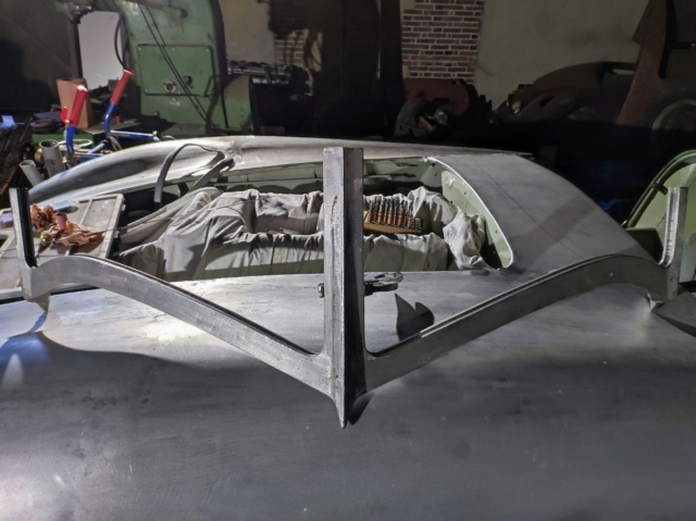

    Beautiful. An amazing amount of work to make those. Do you remember how many hours you spent building them?

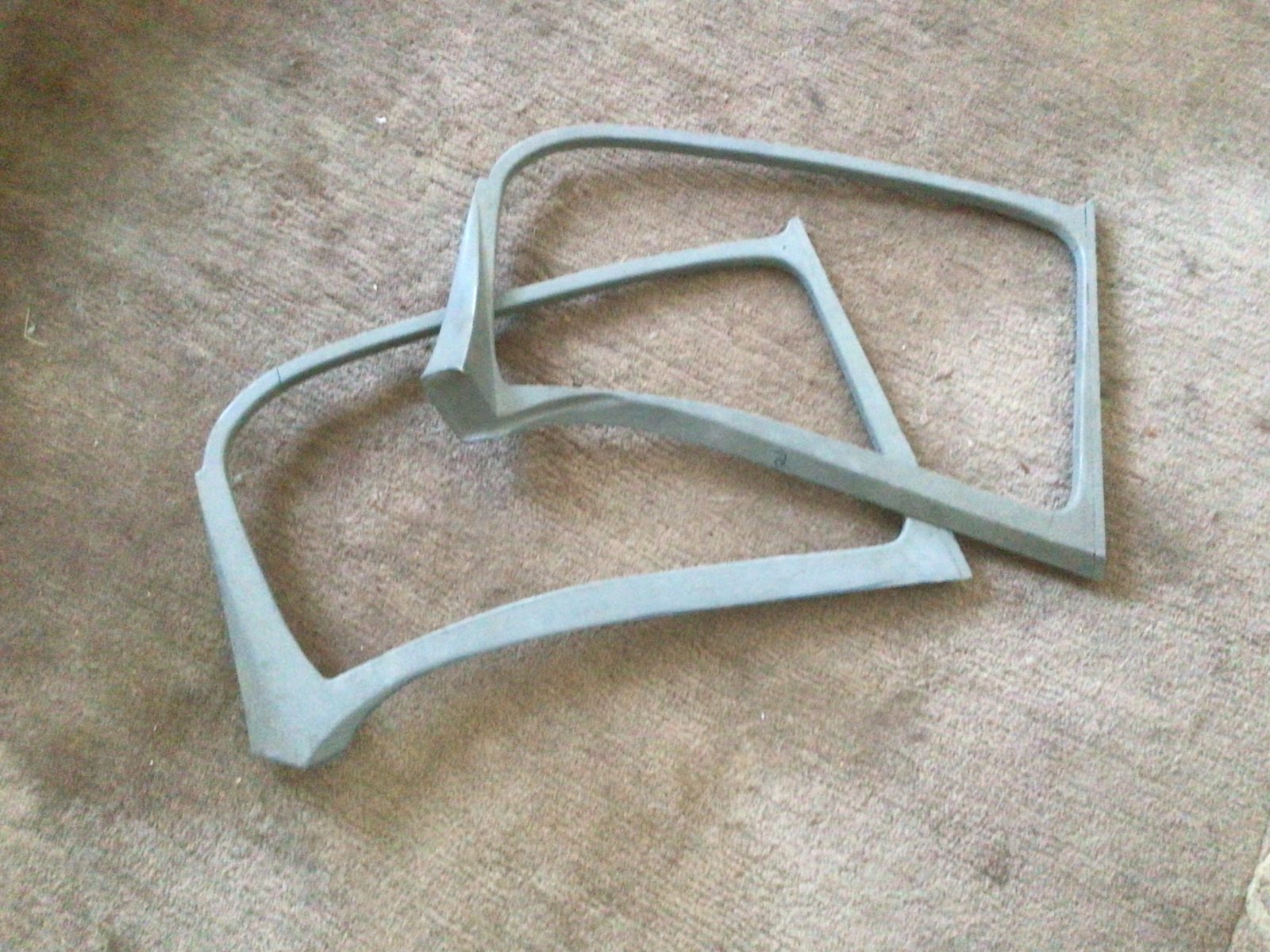

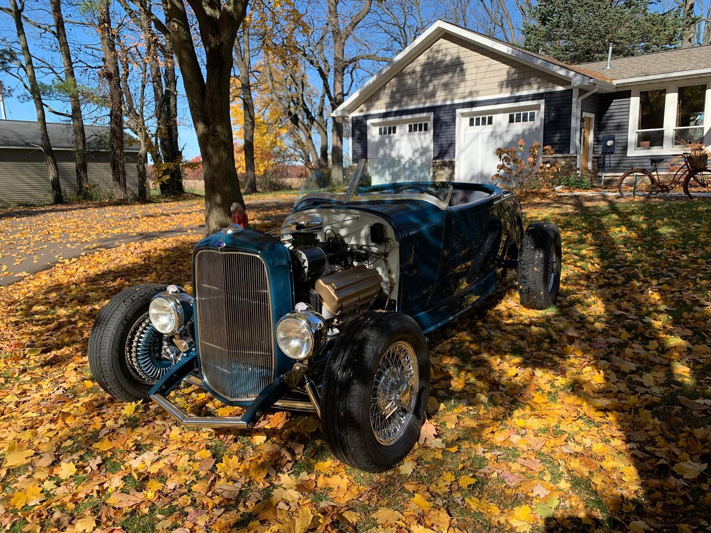

    From O'Brien Truckers. Totally agree with these making the ****pit less turbulent and noisy. I can't attest to how the other might be to fit, but Hallock from O'Brien requires the w/s riser to be trimmed and the of the cowl smoothed, rather like a '27 roadster. My car had already had the cowl reshaped to fit a similar style w/s frame, for which I have the wood pattern. The cost to have one cast from my pattern was exorbitant, so I bought the O'Brien and modified the top of the (already modified) cowl to meet it.

    I don’t remember how much time I spent but it was really a lot of fun.

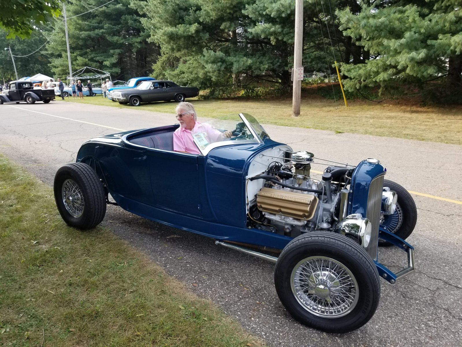

    This one is made of s**** steel and cost around $10. I made templates out of Masonite and used an angle grinder, drill press and a mig welder. It took a bit of time to fit it to the cowl but after that…it was downhill. Don’t mind the 3 tone paint IMG_4113.jpeg
