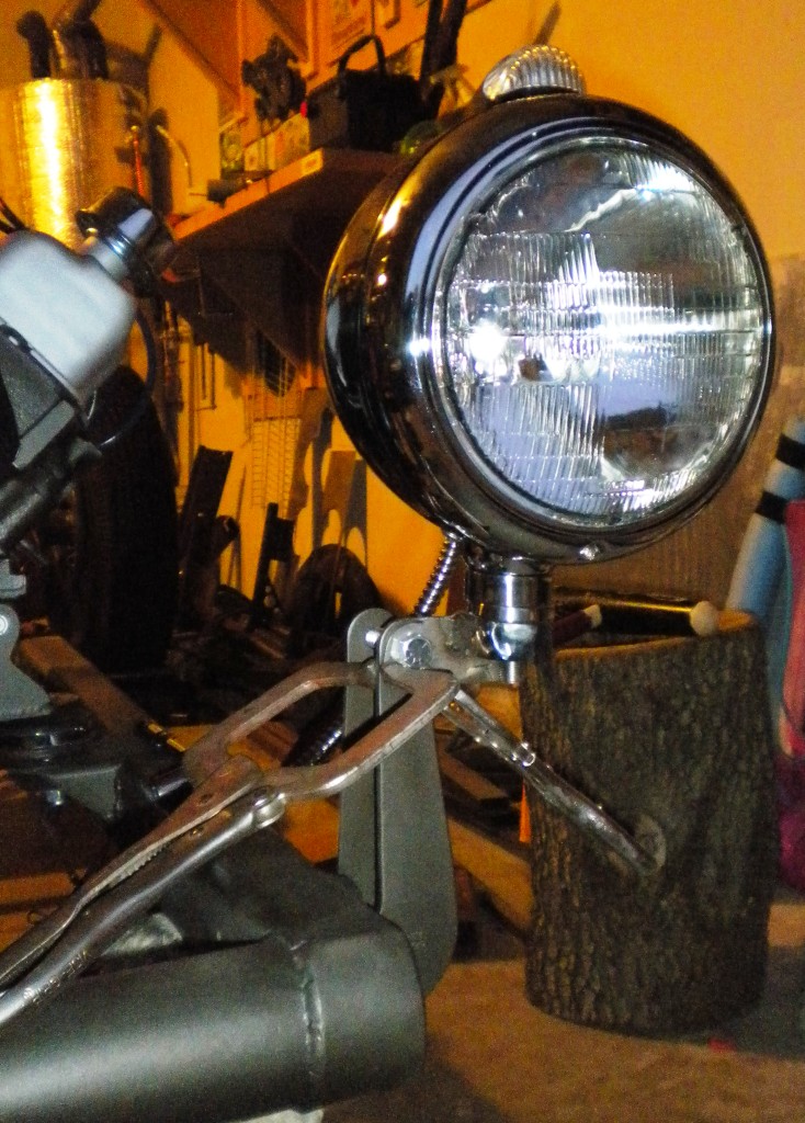

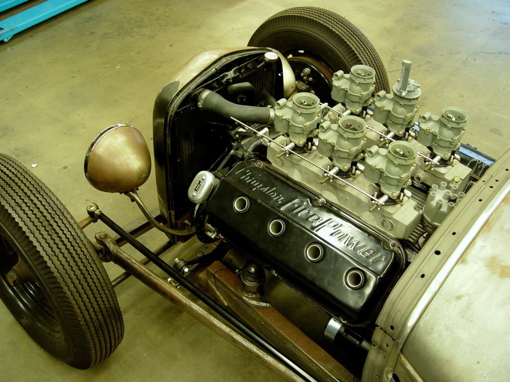

    Here's how I did mine. They're attached to the back of my radiator support. I used some cups from a stock headlight bar that were donated to the cause...

    are they strong enough to mount shocks to?l
  10. scootermcrad
    Joined: Sep 20, 2005
    Posts: 12,383
    scootermcrad
    Are you asking me??
    If me... No. Lights only.

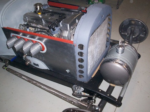

    Here is what I made... Welded right to the shock mounts...

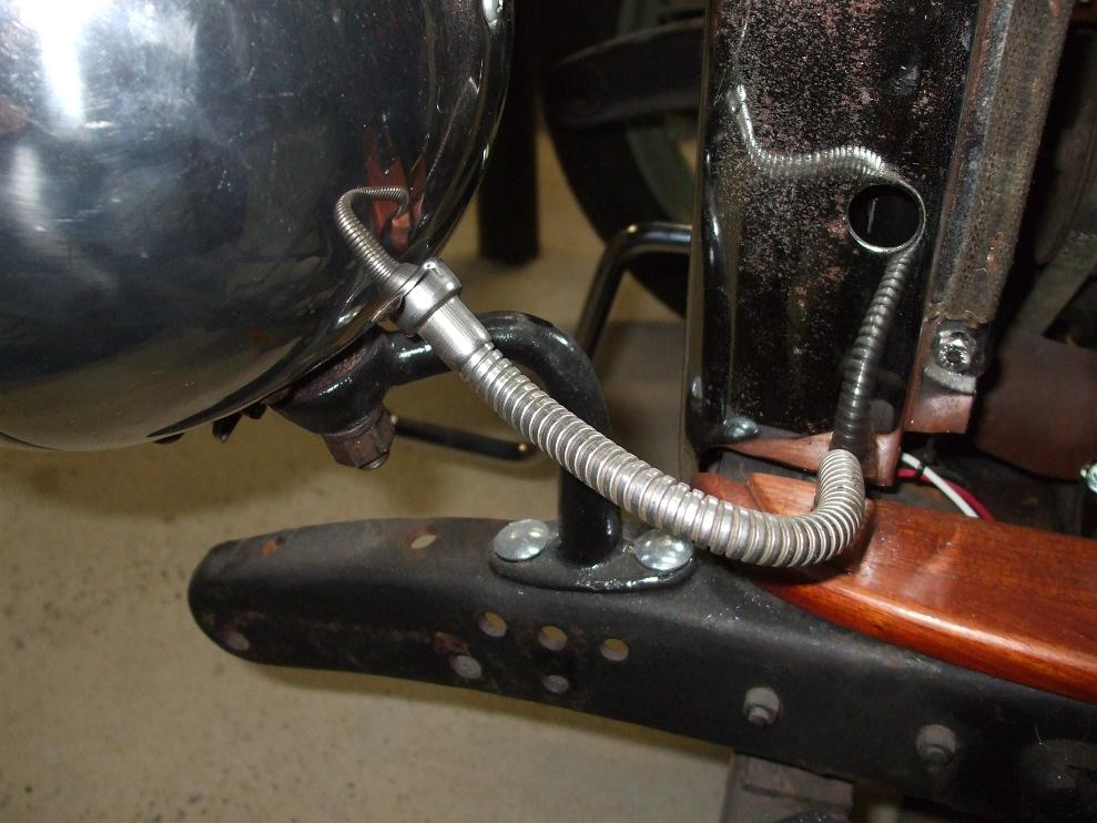

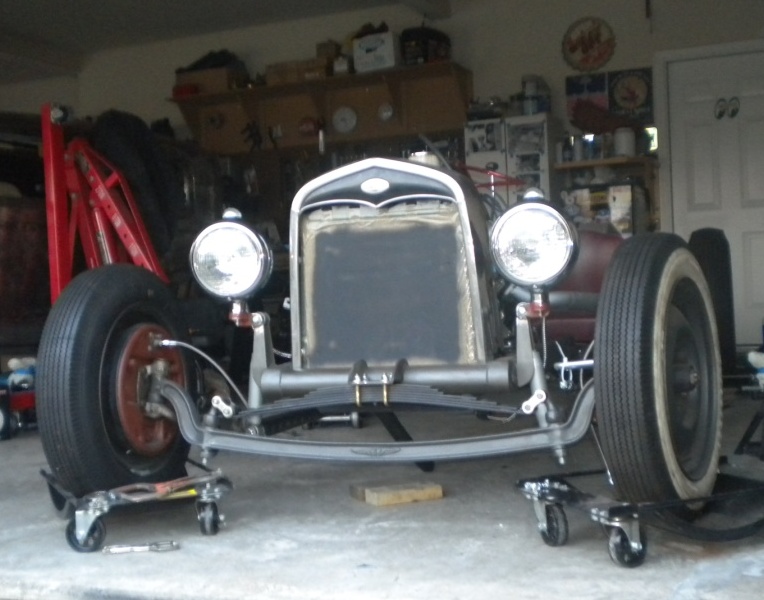

    Here's what I came up with,all bits from my 'parts box'.........

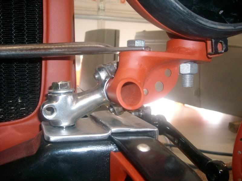

  17. After building some free standing mounts in the past and having a short life on my Bulbs I decided to do these a little different. With them tied together side to side it seems to make the bulbs last longer, I haven't had one go out yet. I also mounted the shocks to the rear of the axle just to keep the front end a little cleaner. Nothing fancy here but they sure work well.

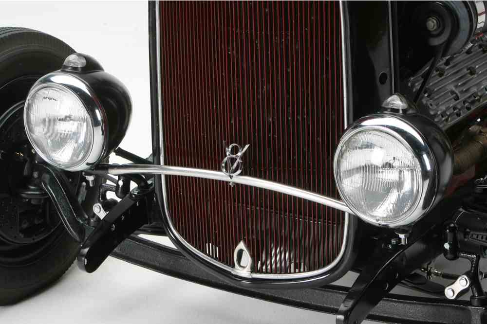

    Made mine out of a 5$ swapmeet '32 headlight bar. Cut 'em, spun 'em around, heated 'em and bent 'em. Spent a month polishing them. I can get you a better pic if you need to but this gives you an idea.

    Thanks guys, they all look good and doing the job ;)
    The parts I used are all 30's & 40's English Bicycle parts , seat stem , handle bar mounts & for the brace ,2x NOS fork legs......(40's or 50's)
    These are all good & strong ,to handle the task,had them here ,so thought 'why not' ,those headlights are of a Czech brand that Im told come from a railway jigger thing......;)

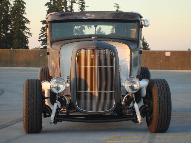

    The headlight bar on my A. Just modified a stock 32 bar. I built a brakcet to keep the cross bar centered while i bent the stachions.

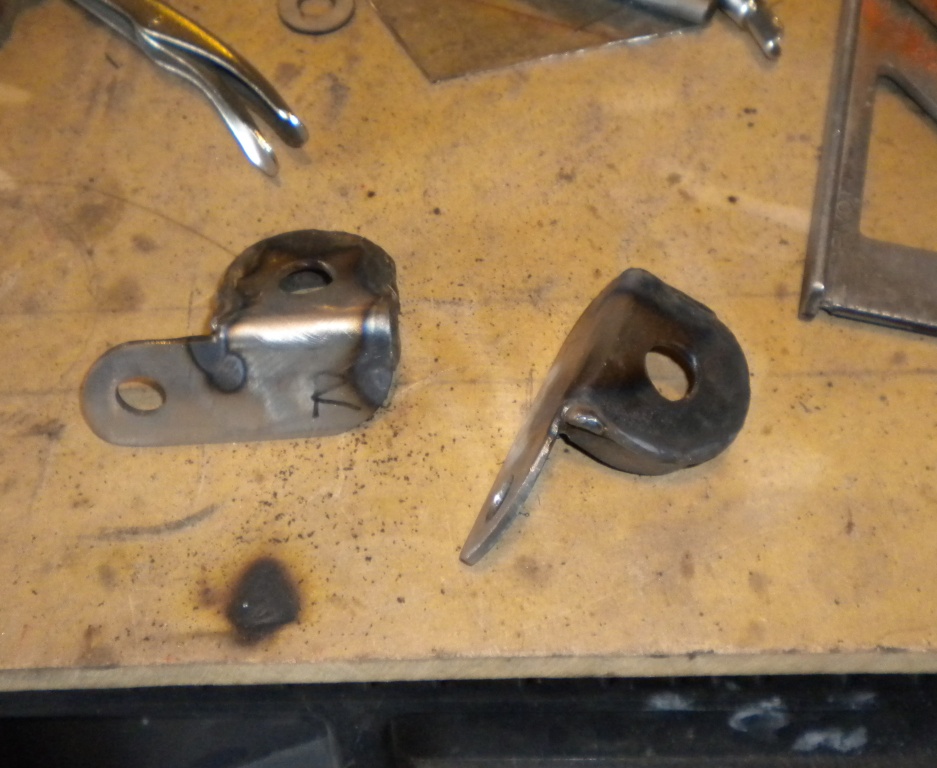

    Bent stock bar. Cut.
