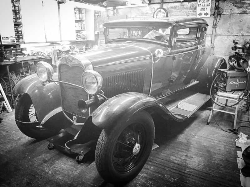

    My 1930 Model A, in all its glory...
    As you'll see this is not my day job, i'm just having fun at home and this build is going to take some time to finish… too long i'm guessing !

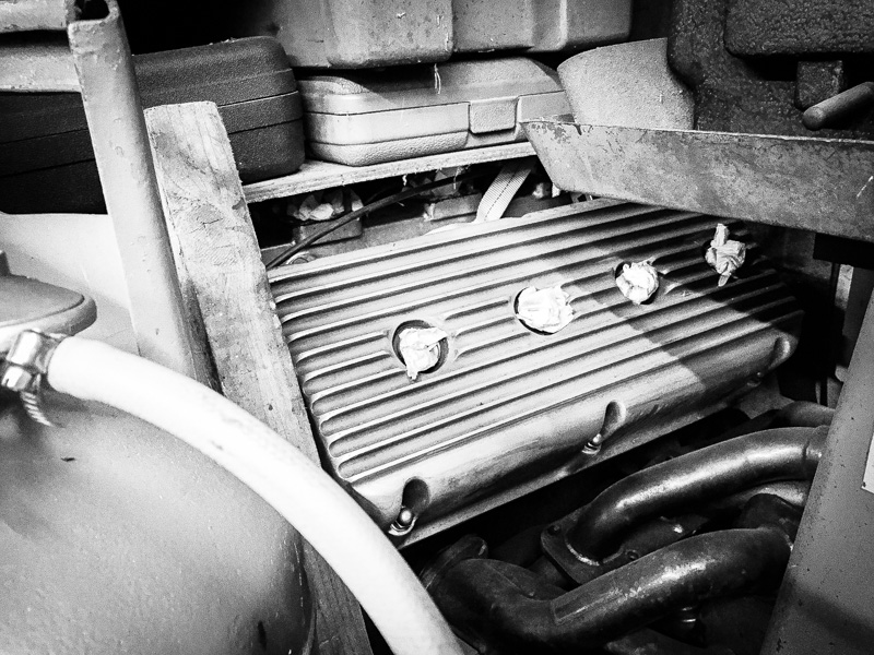

    I couldn't bare to sell my Hemi 32 pickup… so i swapped the motor and kept it, it wasn't so hard to sell on the truck without the hemi.
    I now have what i've wanted for years a 1930 Model A, totally running and driving stock car and pretty much rust free… from what i can see…. what to do… the choice is all mine !

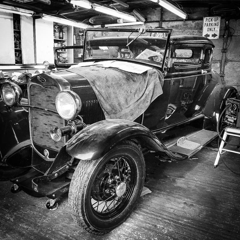

    And now i'm about to destroy it...
    The idea is to fit the Hemi and keep the car looking as close as possible to what it looks like now, obviously i need to change a lot, but that's my goal. Going to keep the fenders on, i may change it in years to come as with anything else, i like to change things around as i go. I'm planning on keeping this one... as usual !!!
    And something i've always wanted… to hammer the roof down low. My first car was chopped the usual amount, but i always wanted more. I don't have worries about fitting in 'cause i'm a short ass !
    When i got the car the roof had a droopy look to it and the windshield hit the cowl. So i began stripping the interior to have a look and also if i could find any rust damage.

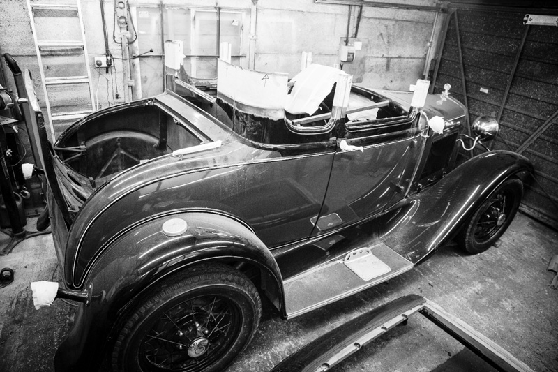

    And now i've gone and done it… It's the roadster moment !

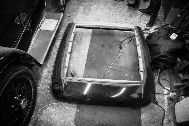

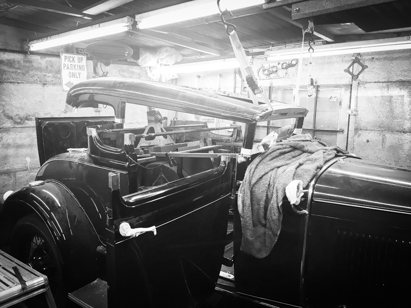

    Its the roof on the floor shot !
    It's that stand back in amazement moment… what have we done !
    Quick… get the roof on lets have a look !
    Expecting it to come down straight… nothing lined up… aarrggghhh

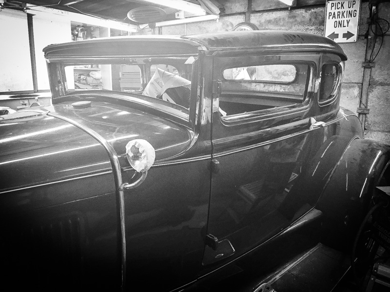

    All seemed straight forward until i whacked the top off… Wow chopping six inches out really adds to the work load and throws everything out of alignment !
    Ooops… i was a bit worried, it sat with the roof resting on top for about a month, how the hell was i going to weld it back on ?!
    But it does look mean !

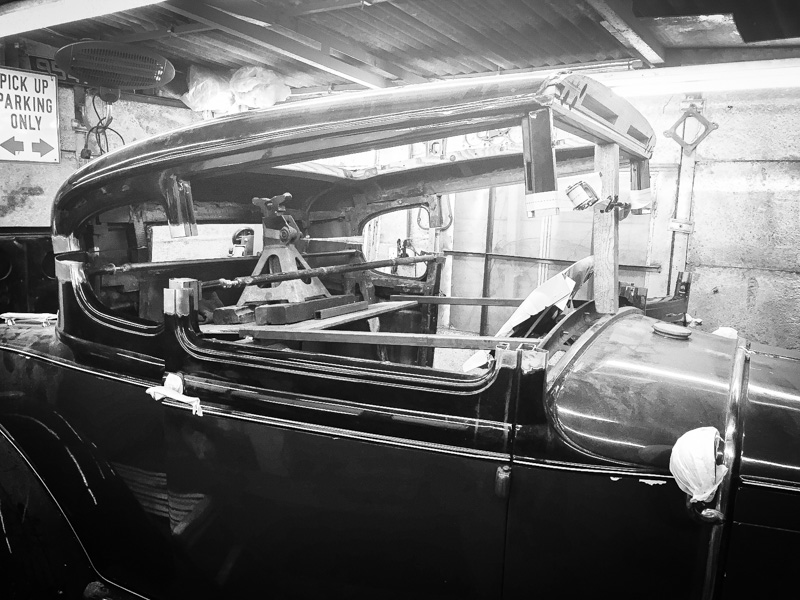

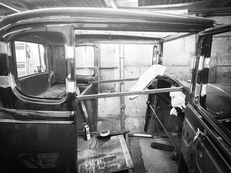

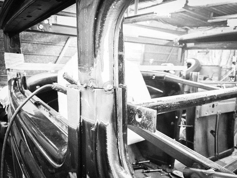

    Trying to figure out what next, tried some ratchet straps on the pillars… looked better !
    This pillar wasn't looking right at all, leaning forward ?!!

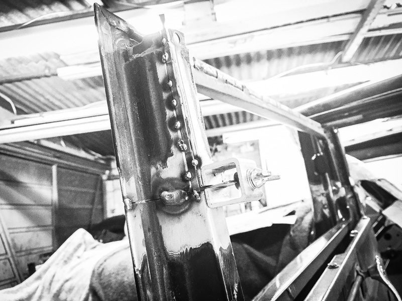

    More bracing… pushing out the B pillar
    It was going to need a bit of forcing back in to shape before i could start welding. So i chopped up some tubing and welded some nuts and bolts to make some adjustable props. I pushed out the B and C posts as the roof looked like it had grown a few inches… ooo that looks miles better, i'd made a leap forward at last !
    The back of the roof also didn't line up when the B post was aligned. I was expecting it to come down straight, yet the roof had become longer !
    I tried the bracing trick again and pushed the back out on the car. Yee haw ! Wrong or right, it now looked like i could finally begin joining it back together.
    C pillar needs shoving out too
    Back kind of looked ok, apart from the sides sticking out and then the B pillars were too far forward !
    More bracing… push that sucker back out

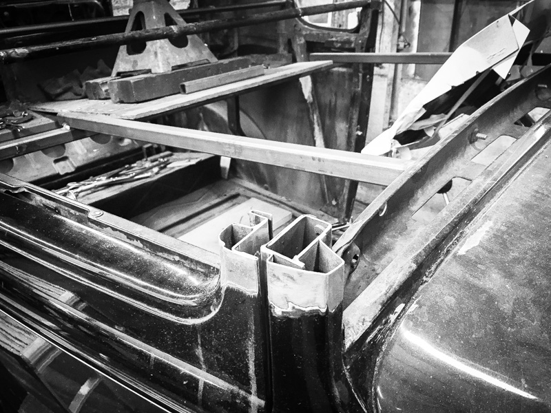

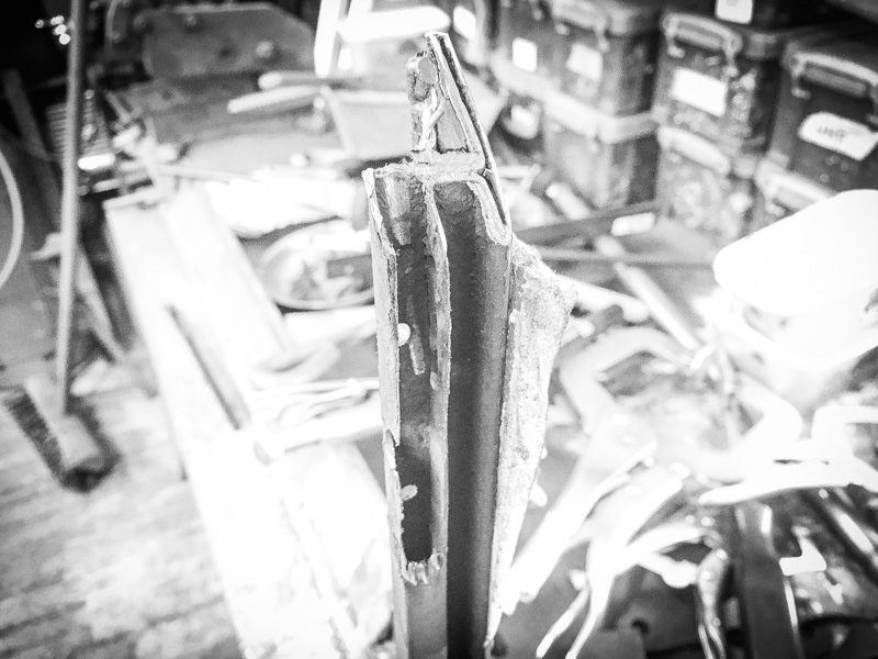

    Hmmm i wanted to dowel the posts, i couldn't lift it off to drill so i tied it to the garage roof incase it fell off !
    Just as the video I drilled out wood in the pillars and glued in some dowels. I was going to have to speed up… glue it, and get tacking !
    Holes for dowels
    Dowels glued in
    I did the back too, but then i removed the rear wood. Still to fit back in.

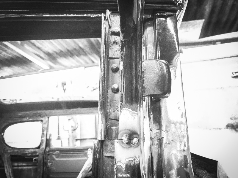

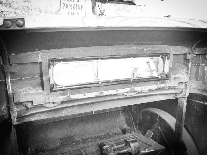

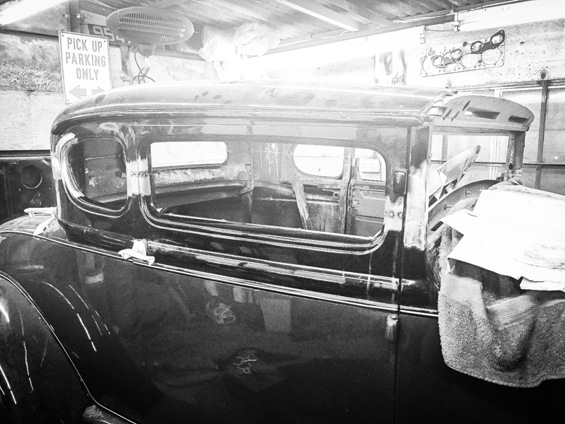

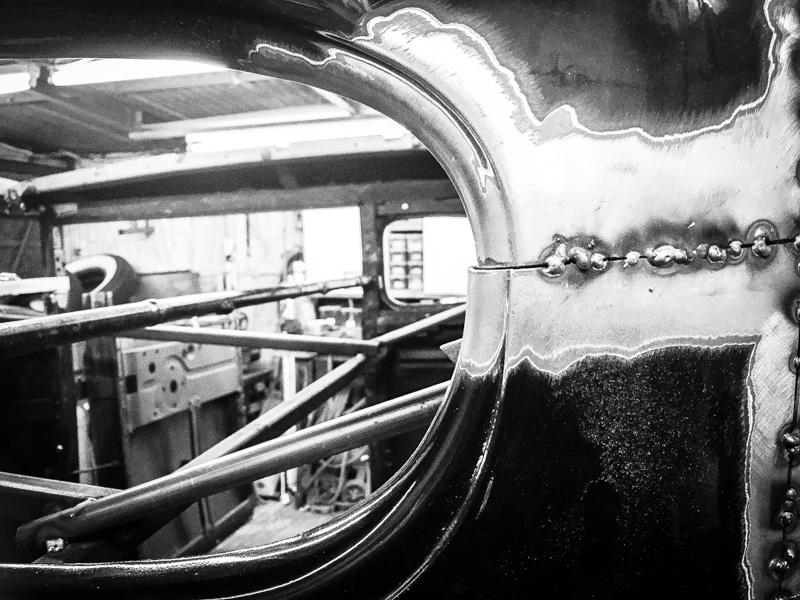

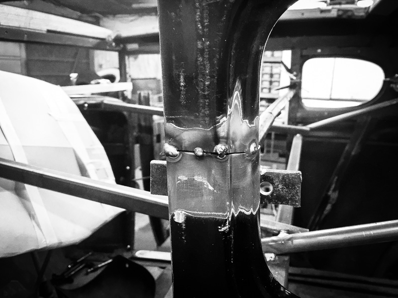

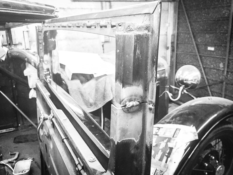

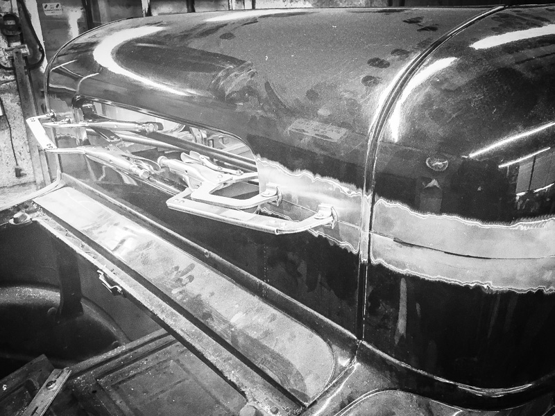

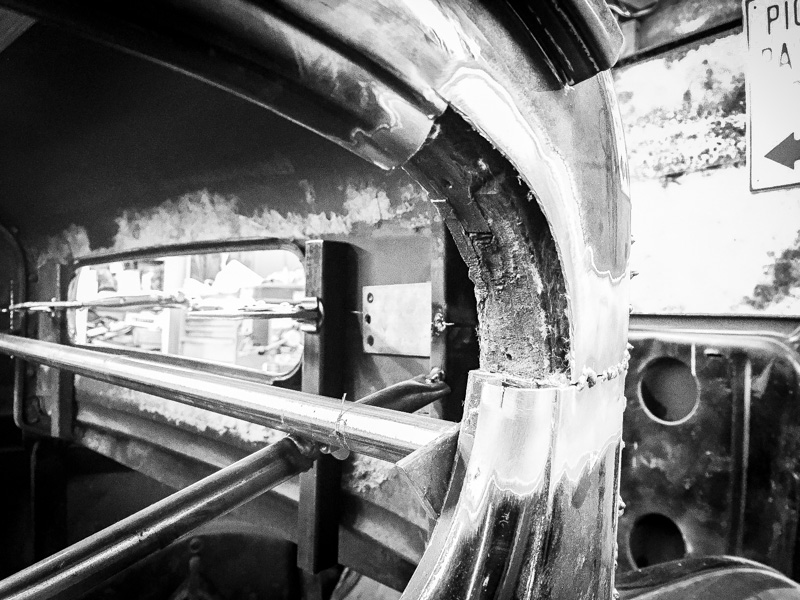

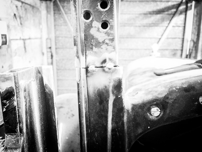

    Welding time. I started at the back, trying to keep the back window and t strips aligned.
    Once i got the back aligned i had a quick zip on the B pillars
    A bit hasty, i was thinking about the glue drying !, i cleaned off some of my tacks later and went round again !
    C pillars next, nice shot of how it don't fit !
    Coming round the side, oh heck i'm going to have to start slicing
    Pure guess work, i've seen three before, so i just went for it, what a mess to have to sort out. Does the job though !
    Those dots are multiplying !
    Done one, not so fazed about the other side this time
    Those darn windows are going to need some magic, the pixies haven't yet been in and sorted it.
    Only one thing for it… more slicing

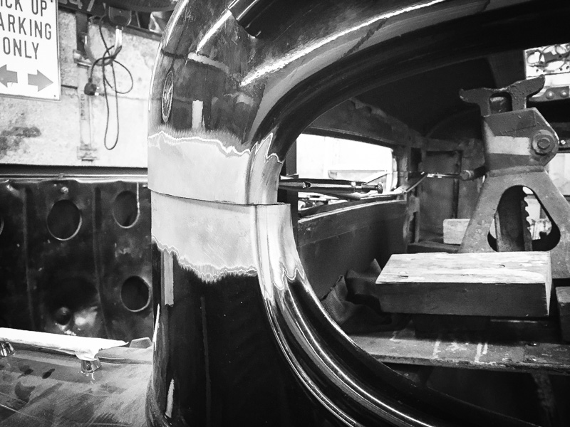

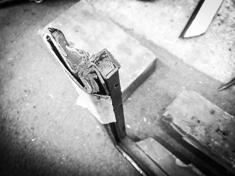

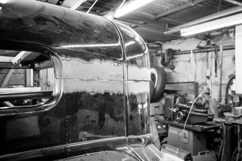

    The top is now thinner than the bottom with the slight taper on everything. Started slicing up the sides now too !!
  8. v8paul
    Joined: Dec 17, 2008
    Posts: 182
    v8paul
    from england

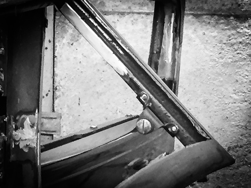

    Its the ol slice up the side, squeeze in the bottom and push out the top trick.

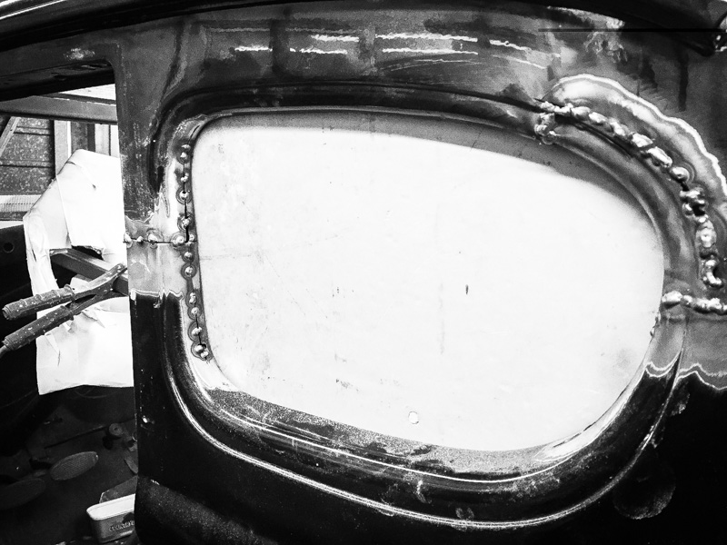

    Get that glass channel straight !
    Starting to look ugly !
    A little dab here and a little dab there !
    Some one opened the garage door and a whole flock of pigeons came in :)
    Hard to tell if the glass channel was straight, so i chopped out a window shape in some wood.
    Getting fed up looking at all that do do, started grinding it down
    Back round the other side… same again
    The butcher's hand, how can i hold that and weld it !?
    Checking its vaguely straight

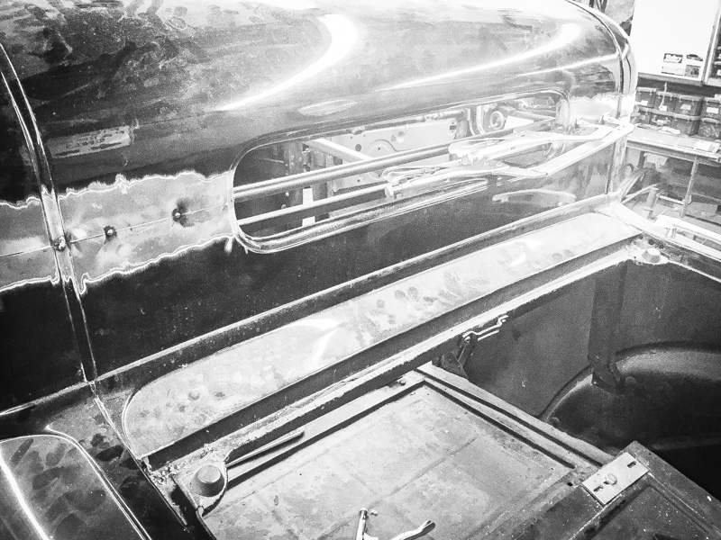

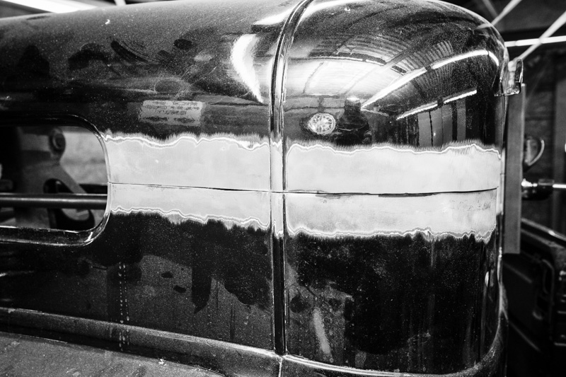

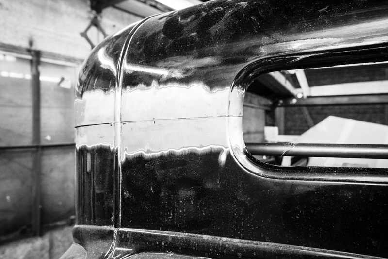

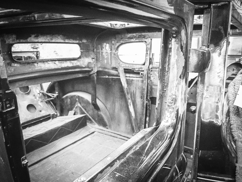

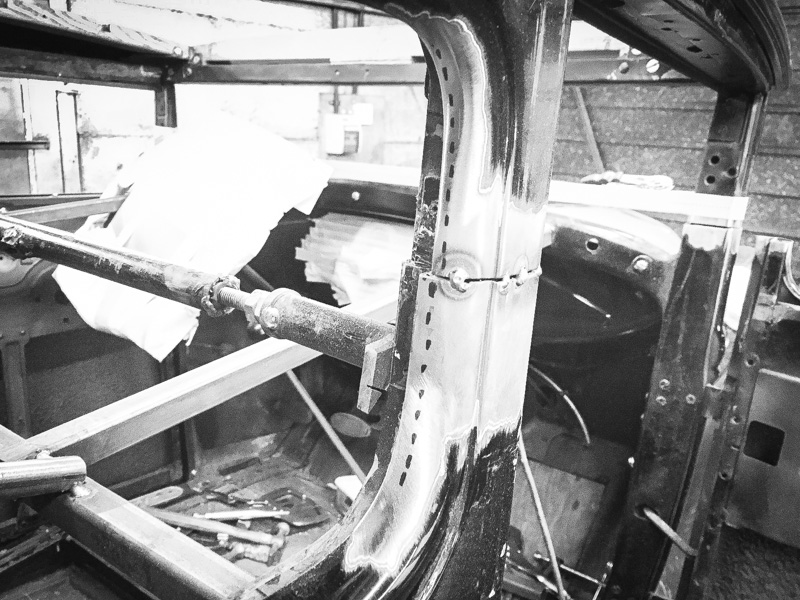

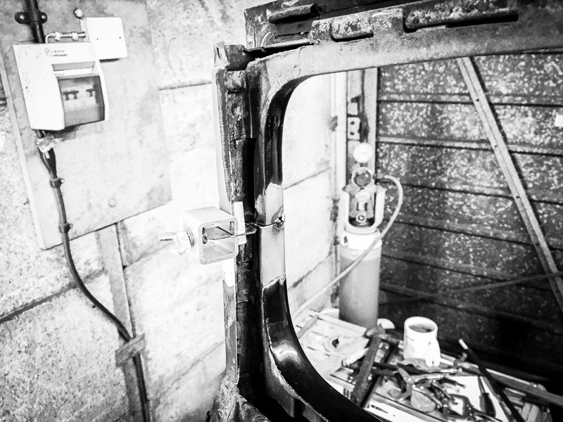

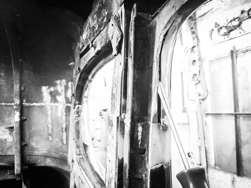

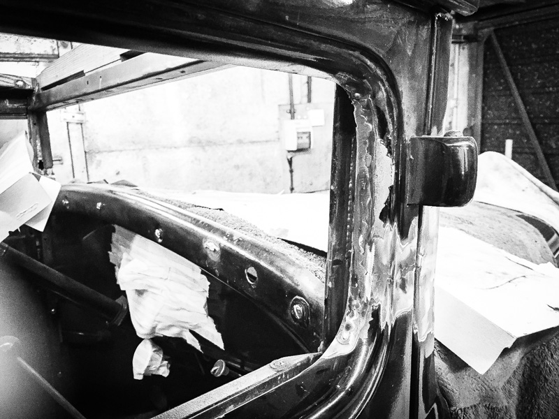

    Oh what a mess, had a fair ol gap to fill as the bottom needed pushing out… loads a grinding !

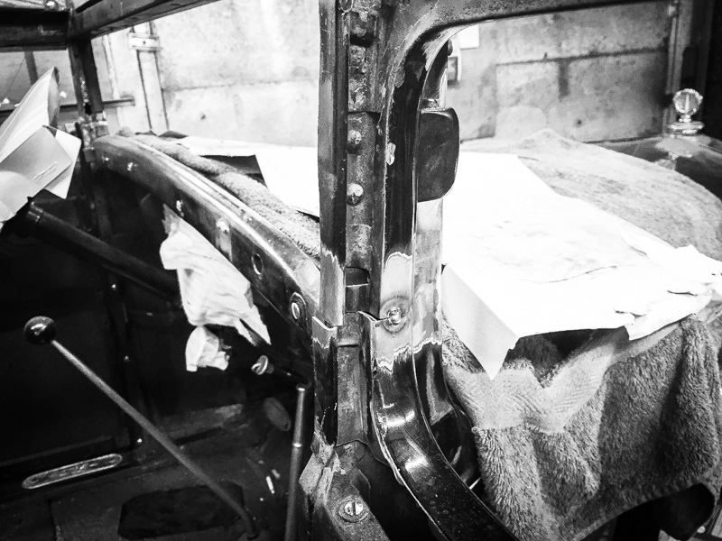

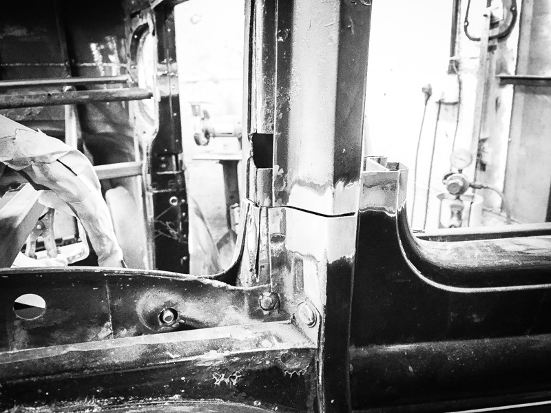

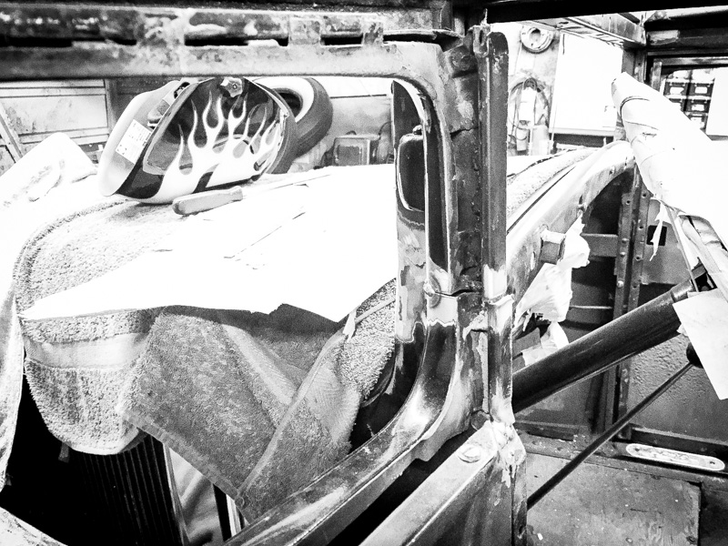

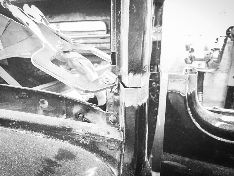

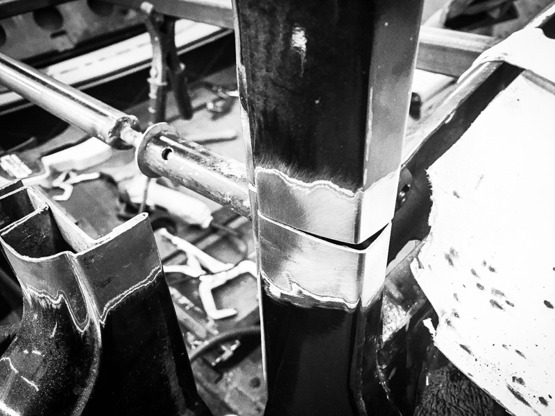

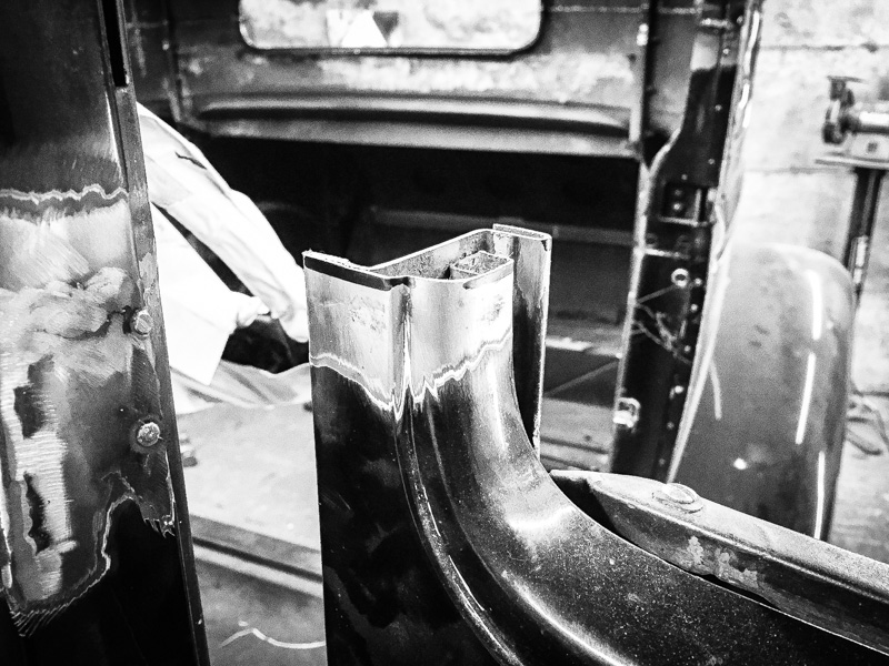

    Next… its A pillar time.
    Not been looking forward to this as the two halves looked way out !
    Started on the easy side as the other side needed some straightening.
    The top points inward at the bottom and the pillar still on the car points straight up ?!!
    Not sure how that happens !
    Seeing what happens with both sides clamped

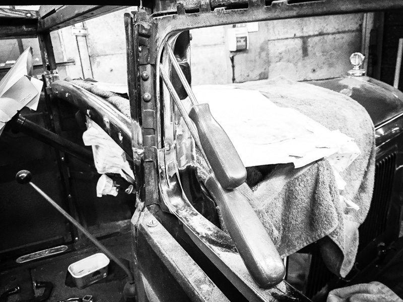

    Decided to put a spoon on left side of the pillar on the car a give it a whack
    Back view is close
    Slice up the side on the top half… open wide !!
    My big hit pushed the pillar over quite nicely !
    Sliced n squeezed in the lower pillar

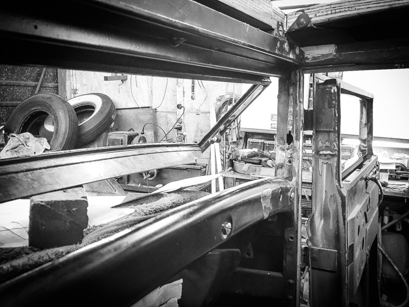

    Almost aligns, apart from the front edges are at different angles
    The other side was way out. My bracing didn't hold it in place, the bottom moved backwards about 5mm and made the top look really bad.

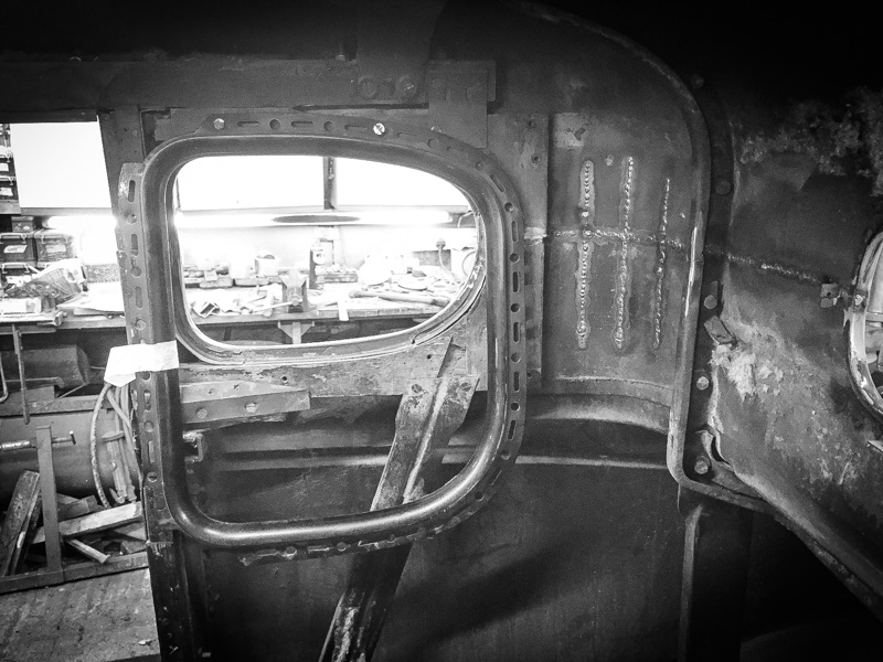

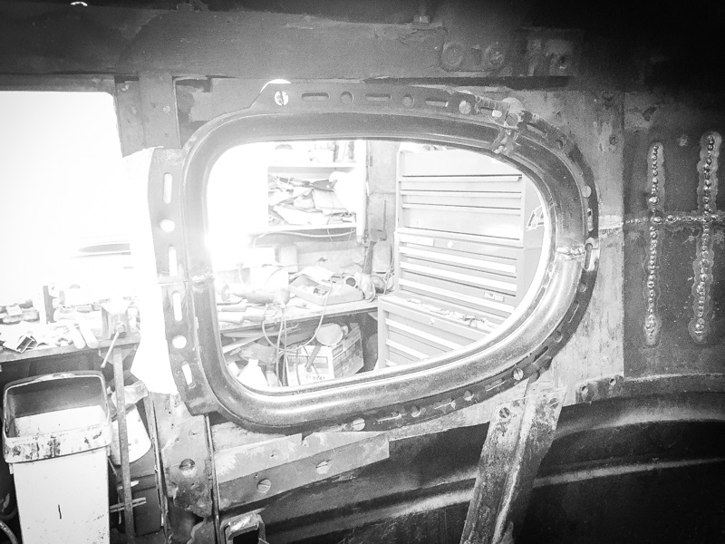

    I waited until the B post was welded and braced off of it. Welded some more nuts n bolts n bits of tube into an adjustable prop and tightened it up. Yee haw… success !
    Time to squeeze in the sides.
    Props, clamps n ratchet straps !!
    I like to work in a tidy fashion… not

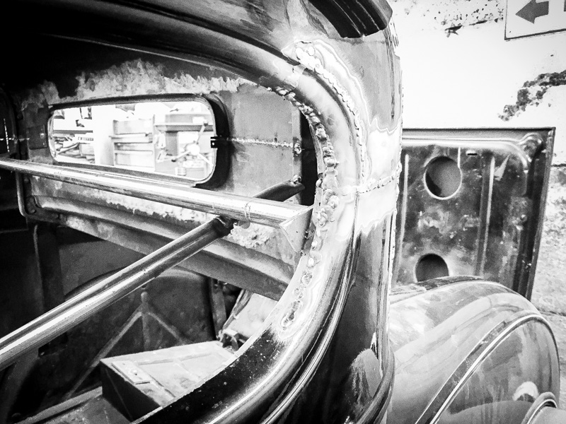

    After a few tacks behind and a few more clouts with the spoon n hammer, my nightmare B pillar was looking pretty good !
    More slicing up the sides
    Deep in surgery… beep… beep

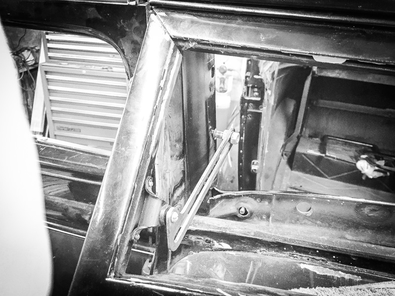

    Next on the hit list… the dreaded doors !
    Would they ever fit again ? would i ever be able open them or even wind down the window ?
    Would they line up with the A pillars ?
    Find out in another thrilling episode… zzz
    Don't look too bad from that angle.. lol
    Needs a little widening

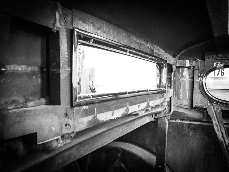

    Totally throws off the glass channel
    Just resting in place… still trying to make a plan of attack

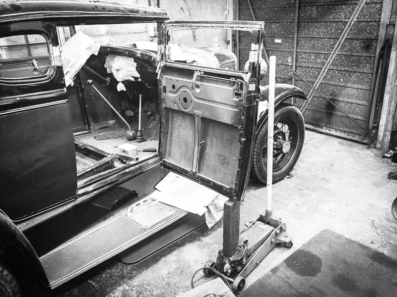

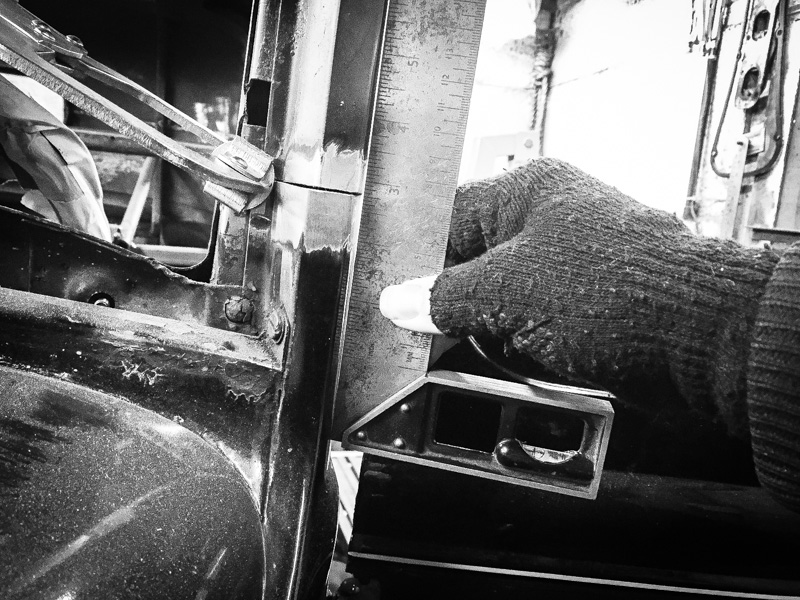

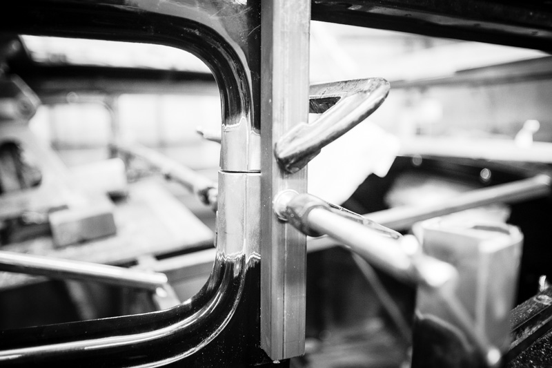

    Needed a bit of wrestling so i decided to do it on the jack
    Straight edge clamped on the front and a few tacks
    Who the hell cut that !
    The top was slightly longer just to be an extra pain.

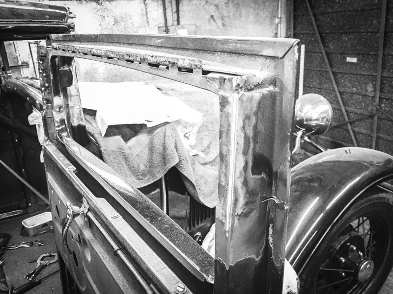

    I squeezed the top with my ratchet straps and zapped it with the mig
    Well that wasn't so bad… its back on and opens and closes !

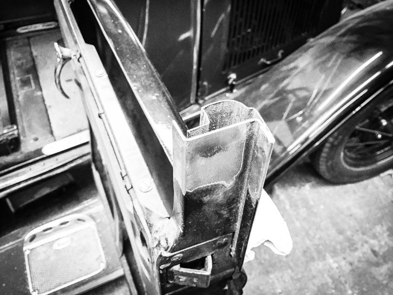

    Now for the back. Extending straight up to keep the glass channel straight
    A few more dribbles of snot

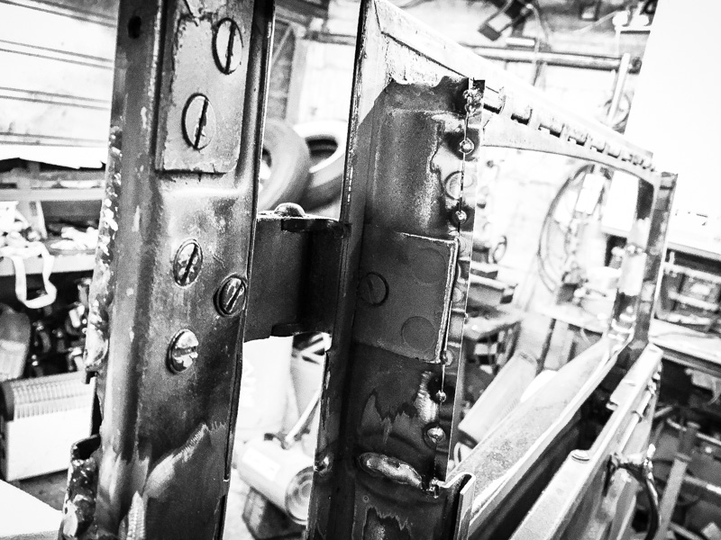

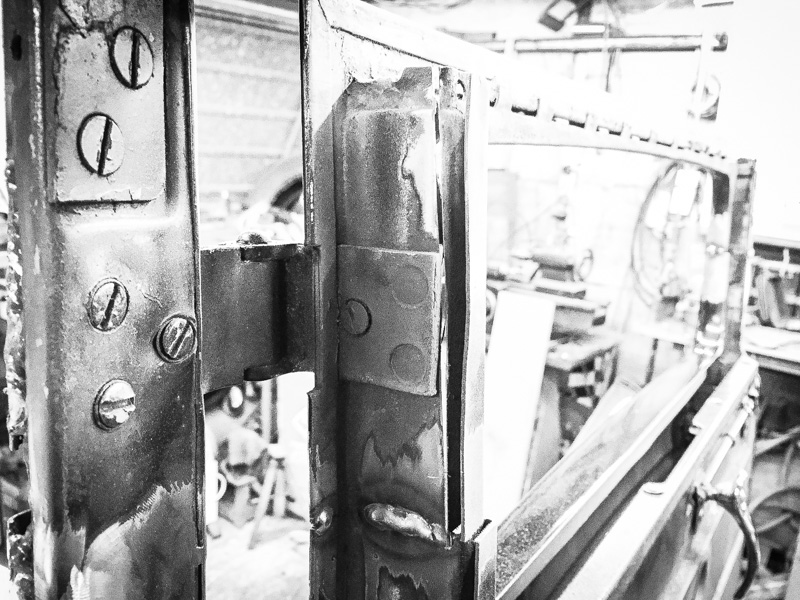

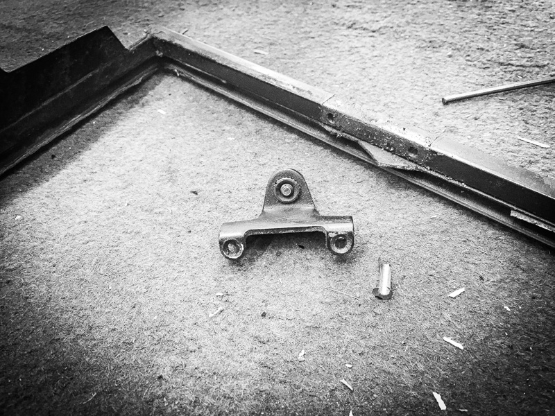

    Same to do on the other end. Darn hinge is a bit in the way. Riveted on so that'll be staying.
    Slice that edge off !
    A bit of tidying
    More dots… trying to miss the hinge, weld on the inside !
    The ol slice trick, i couldn't decide to pie cut or just slice the whole top. No i couldn't be bothered so pie cuts with a wide start !

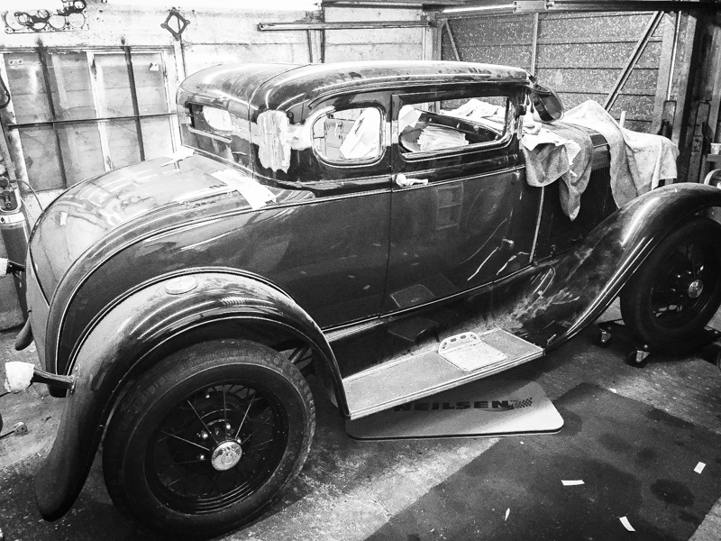

    from england

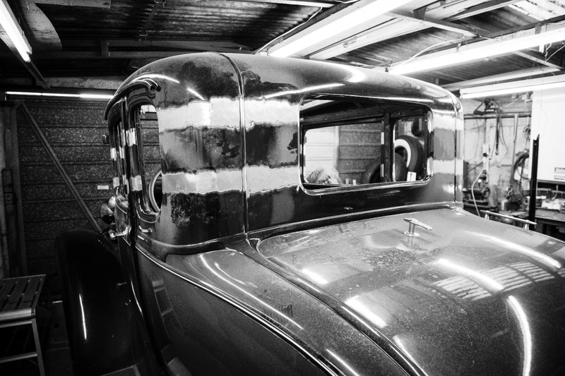

    Back not so bad, just a little slice
    Holly smokes its back on !
    Tidy tidy
    I've roughly knocked down all my welds, i'll leave it for another day, just getting it back together
    I thought the door tops would need slicing, they are a separate piece, some how it fitted on the wider door… well pretty close. Decided to leave it and see later if it needs doing.

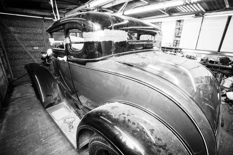

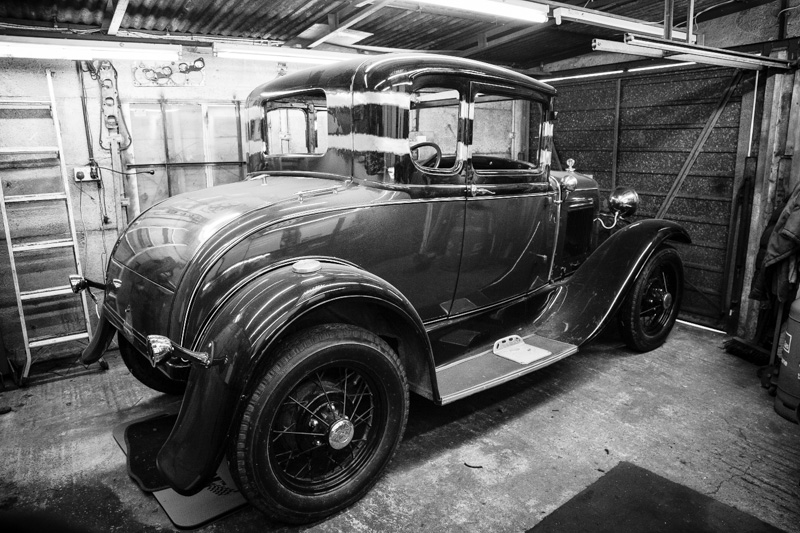

    Blimey, after all the worry of how to get it back together.. the main stuff is done, apart from a repeat of

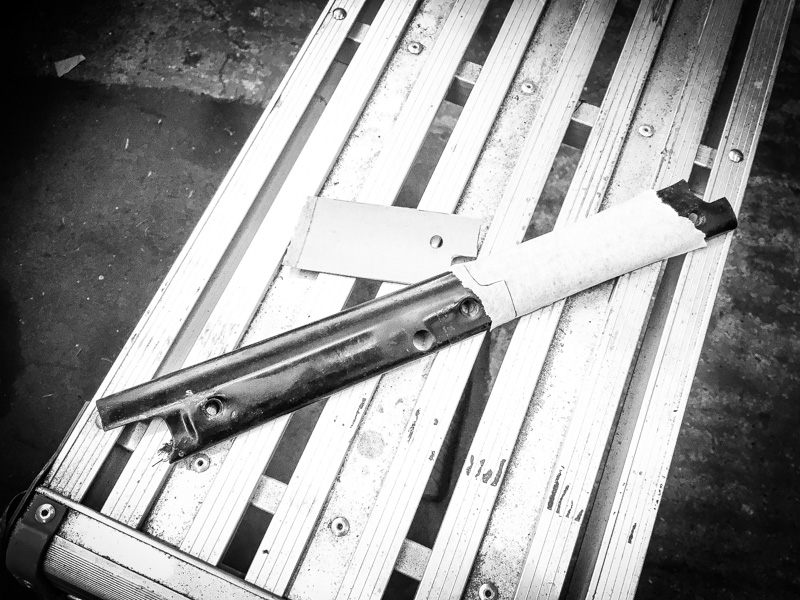

    And you at the back… open up !

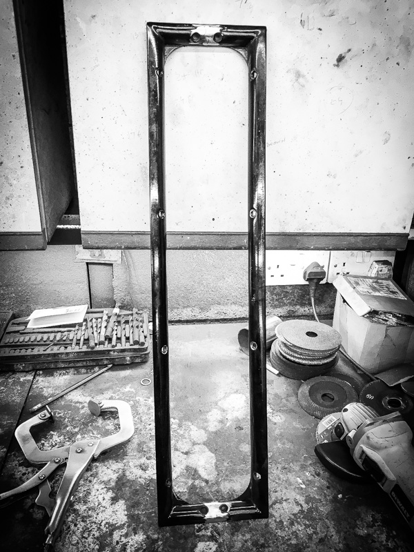

    A little slither held in place with a handy magnet i forgot i had
    Stitched back together
    Out came the grinder for another tidy up
    Hey presto… the doors are finished

  27. v8paul
    Posts: 182
    v8paul
    from england
    This time i'm thinking… windows !
    Step back in amazement moment… what have i done to my sweet little car !
    Time to fit the windshield… would you believe the size of that thing !!!
    Must have saved half the weight of glass !
    ][​IMG]
    After a bit… a lot of bashing with the mallet, it all came apart. Even the glass is in one piece !
    Its got the horn !
    Want to keep the windshield opening, but the brackets are now right in the way of fitting the top back on
    Drilled out the rivets, stuck solid
    Out came my chopper
    Oh bugger… there's some steel bar down the tube where the top brackets need to slide in to. And its darn rusty !
    Easy enough i thought, just drill out the spot weld
    Fat chance, it wasn't going anywhere. Decided to just grind it out !
    At last… its out… whats left of it !!!
    Same on the other side... little devils !
    Try it on for size… a little more trimming
    A bit smaller than it was !
  28. v8paul
    Posts: 182
    v8paul
    from england
    I thought i'd better put the square bar back in for the bracket, i didn't have any so i whittled down some thick plate that i had. Poked it down to the bottom of the frame.
    And repaired my sides i chopped out
    A bit of grinding later, its back to normal
    Really want to rivet it back together but screws will have to do, maybe a dab of weld later will make them look like rivets
    Just happened to be hole left over in the pillar. I was hoping i could use it for the bolt for the bracket
    And bolted them in
    Seems like the more i bolt in, the windshield gets smaller and smaller
    Seems just right, opens out enough and the brackets still fit straight up when closed, with a few mill to spare !

    v8paul
    from england
    Time the interior trim.
    A pillar haircut
    Hmmm… i was expecting to cut it in half and join it back together. Then i had a brain wave and noticed i might get away with using the top or bottom
    Telmplate of the top, marked out to use the bottom half. Going to be close, with the screw holes !
    After a bit of trimming backward and forward, it fits. The screw holes at the top are slightly out. One side has lost its thread so i'll re drill the pillar, sometime, save cutting the trim.
    My lardy ass aint going through that in an accident… :)
    Rear side windows next
    Got some trimming to do !
    Roughly chopped out for a trial fit
    Going to need another chop
    Sliced in three
    Time for a puzzle
    Not sure i chose the best place to cut first time around, struggled to get a nice bend. Not too bad though
    Posts: 182
    v8paul
    from england
    Its the other side !
    Chopping up window trim in to three bits, til it fits.
    Funny how the second time goes quicker and better, my curvy bits flowed much nicer.
    Out side looking in
    Next on the hit list…. is the back window trim
    Glued and popped the rear wood back in, ready the window trim's wee chop

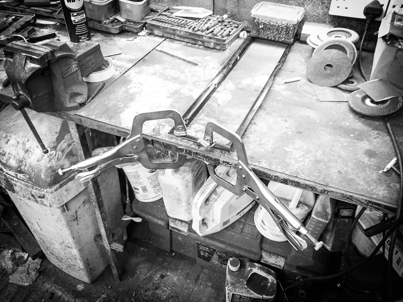

    Another six inches of metal on the floor !
    Clamped on the bench to keep it flat.
    Does my back window look big in this… lol
    Hmmm couldn't decide what to do with the holes up the side… keep em, keep one and move em or delete them
    In the end i just welded them up
    Back in its spot
    Came back to the front as i wasn't too pleased with the fit.
    When i got the car, the wood was so rotten, the windshield frame was resting on the fuel tank. Not sure how well it would have fitted. The new wood seems a bit big. So i thought i'd chisel a slither off the front edge.
    Which became quite a big slither !
