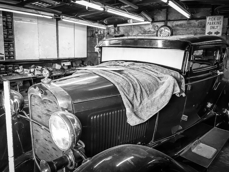

    Holy cow Dude, that's patience. Setting the old windshield up in front of the new opening sure gives a great perspective on how much you whacked that top! I like it!

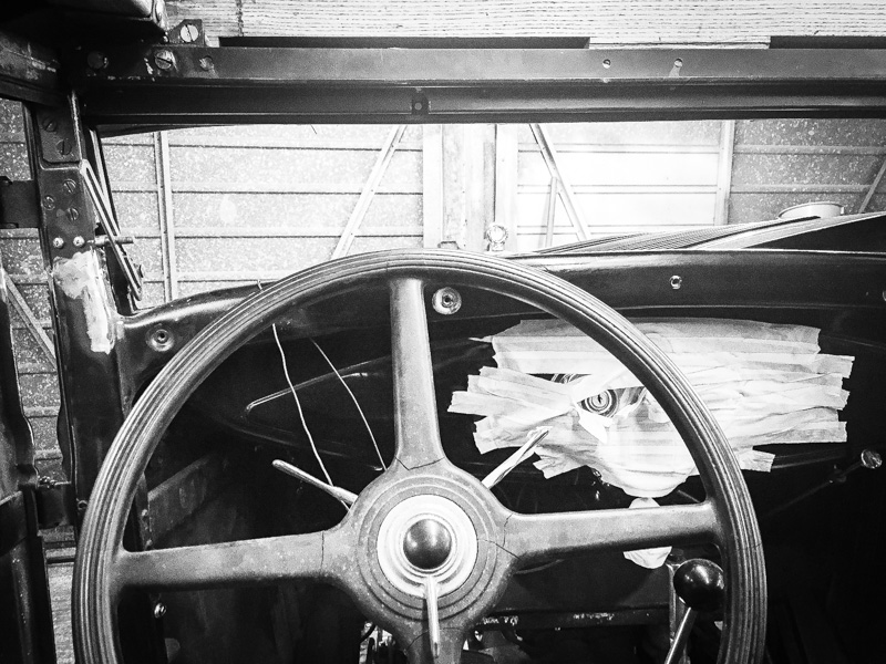

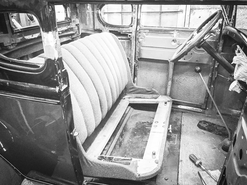

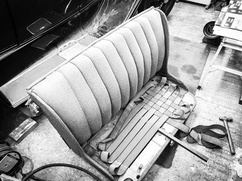

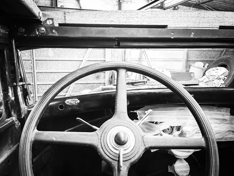

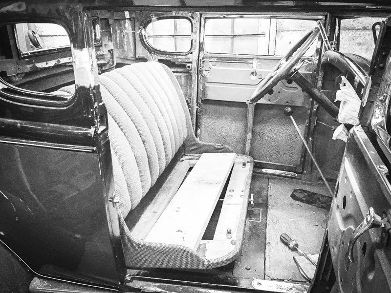

    So i've been thinking of having a drive, though i can't until i get some decent tyres. But when i do i better try and get it usable. Seeing out the windshield is always helpful !
    I have a good view of the steering wheel and that's about it… lol
    Plus the seat is too high, even for me !
    So i guess i'll be losing the seat cushion and try and use the base. I'm thinking let my rear end hang down into the parcel tray under the seat. Bought some webbing as a test and threaded it along the base and sat in it, expecting it to collapse… and it didn't, mmm might work. After that i bought some foam to bung on top, and that felt like a good seating position.
    Just right sat on a plank
    Tester with some webbing
    So the steering column needs dropping. First time to fiddle with the oily bits, hmmm not exactly built to be pulled apart in a hurry, took me ages just to get off the tin trays next to the engine that stop spray and dirt being chucked up… or are they aerodynamic under trays… ha ha !?
    Whipped out the floor as it was going to be in the way
    At last i could get to the steering box, but that won't come off till the starter is off, and that only just comes off with a lot of wiggling as the water hose is in the way !

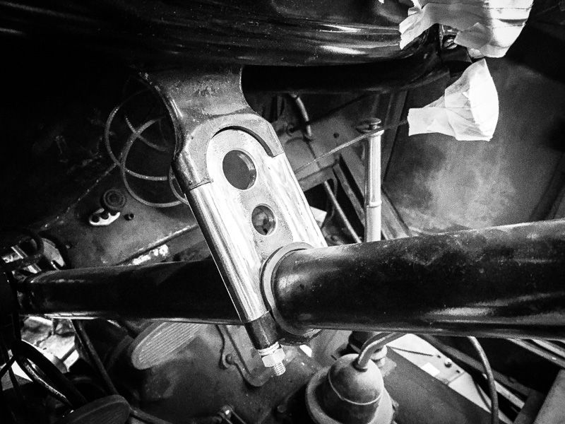

    Got the column off and filed out the mounting holes in the chassis. After a lot of filing and trial fitting eventually the column swung down enough to see out.

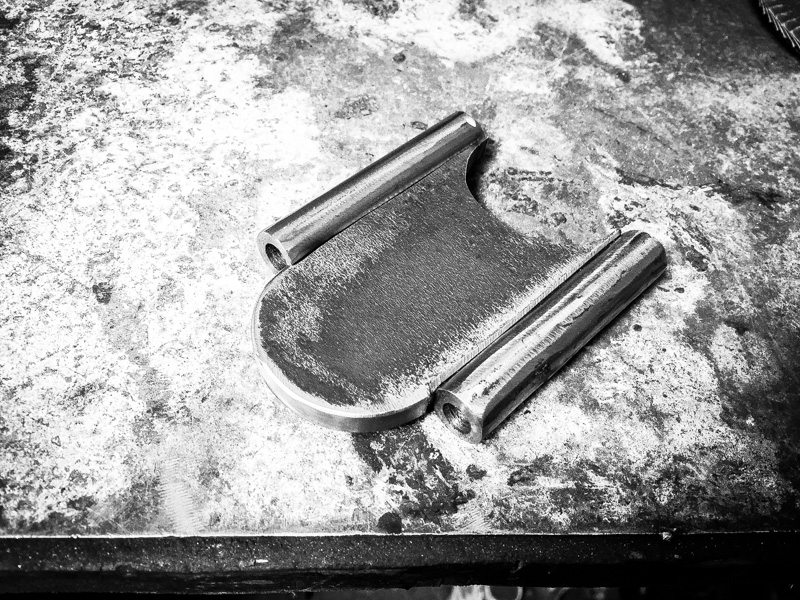

    I've seen some spacers for sale but 1 3/4" aint going to do it, i need a 3" drop spacer. Time to make something…
    Started off with a bit of plate
    Looked around the garage for some round bar and couldn't find anything, then saw an old wheel brace lurking… and out came grinder. And bored out a hole.
    Some long studding
    And tack to taste
    I meant to leave it rough looking, but got carried away
    That'll do me

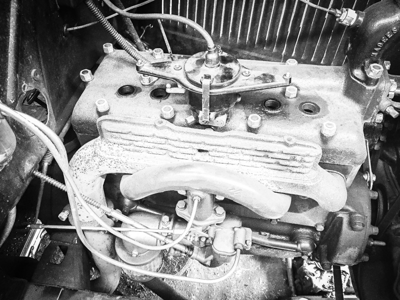

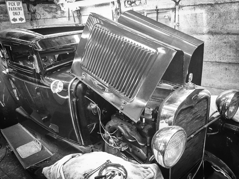

    So now i moved the column down, the advance adjusting rod was never going to clear the top of the engine to the column. Found a piece of rod and made it longer and bent it to suit
    The heart of the high powered beast. I wondered why there was a little oil around the plug holes…. not been tightened up would do it ?!!
    At last, after hibernating in the garage over winter whilst being butchered and after quite some time… it eventually started. Time for a pic out side !

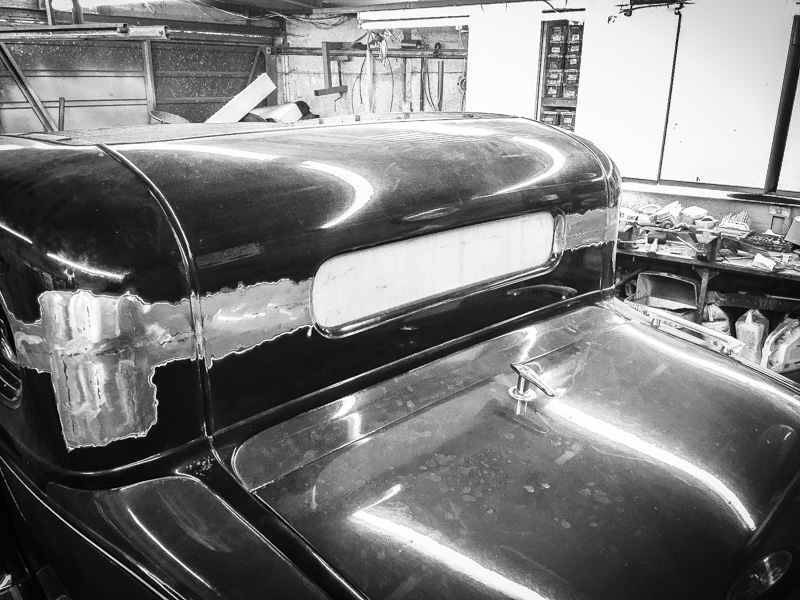

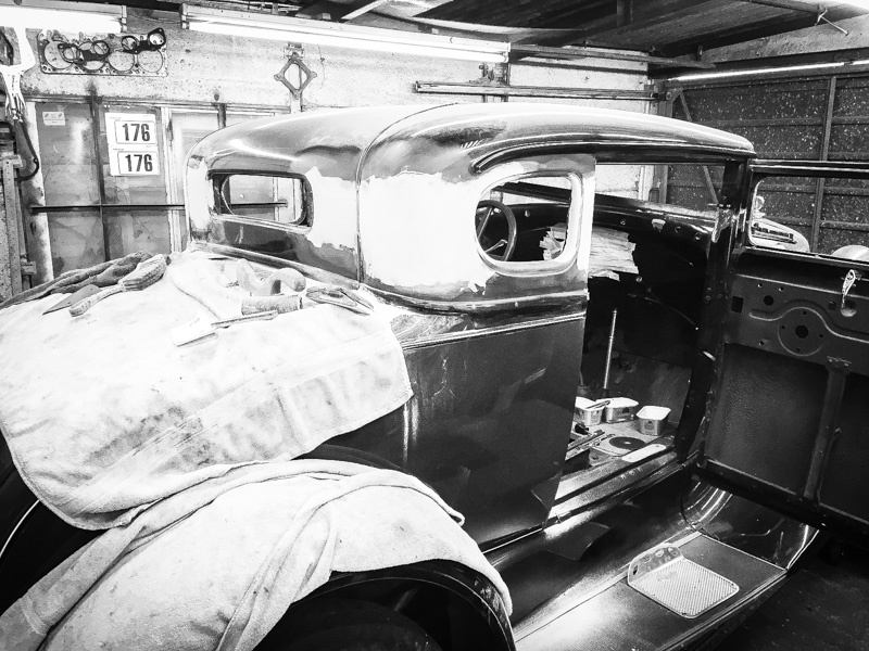

    Meanwhile i did some more tidying on my welds
    And broke out the the tub of lard to hide my sins
    Funny how a small dollop spreads and spreads over a larger and larger area

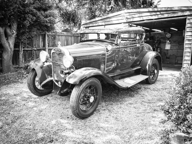

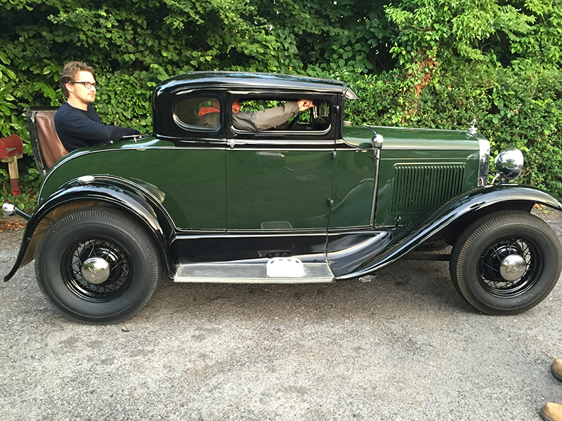

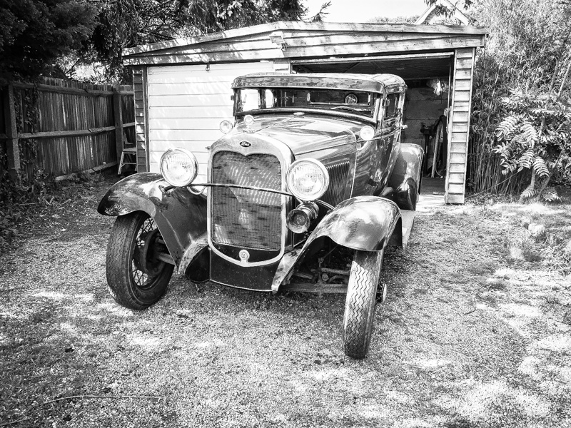

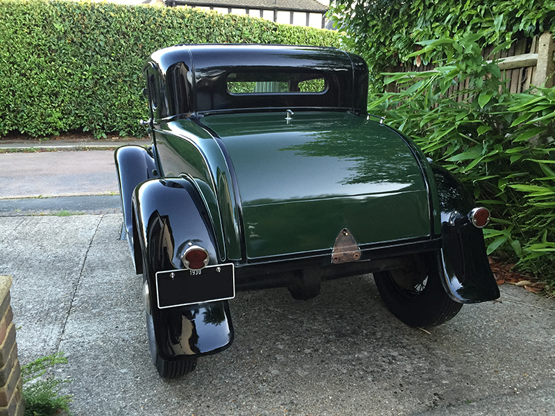

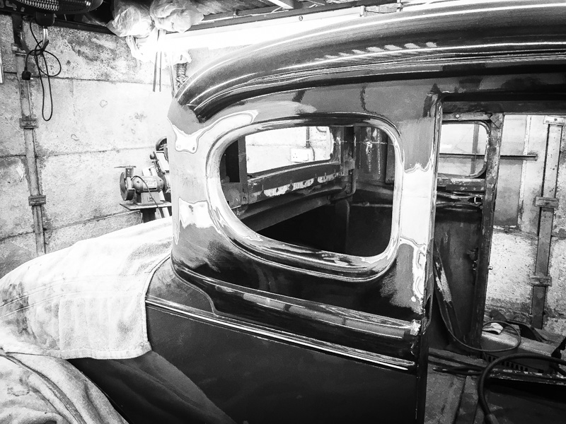

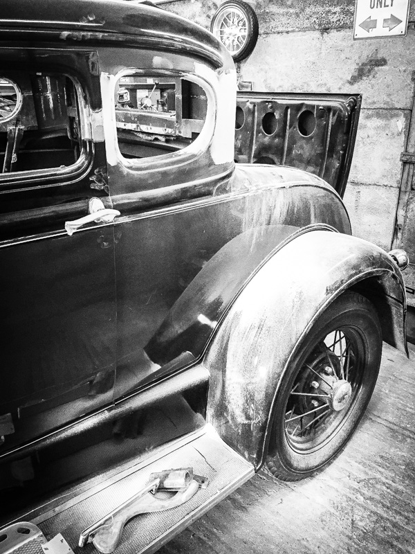

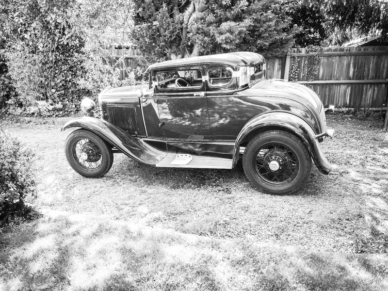

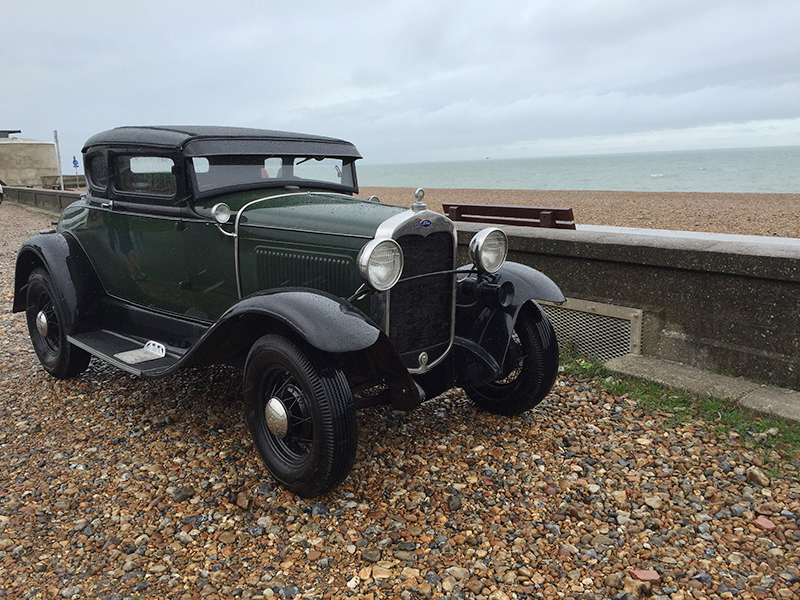

    Just noticed i’ve not posted any pictures of the end result of my little chop. First picture is what i started with… or ruined as some will say… lol
    Been busy out n about, i love it !

    Thanks ! I will post some more monday. Yeah bone stock apart from the chop and 16" wires. Stock interior.
    I've really enjoyed driving it with the banger motor, so much so i was in two minds weather to carry on with the Hemi plan. Too late now though as it's into it's Hemi phase... i've stuck with the plan !
    The plan is to change as little as possible, yet strengthen it up and pop the Hemi in. Should be simple... lol

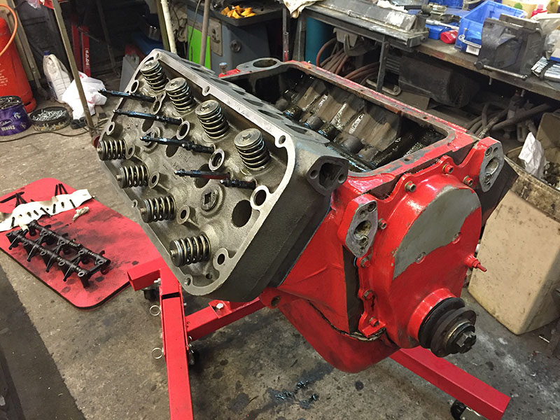

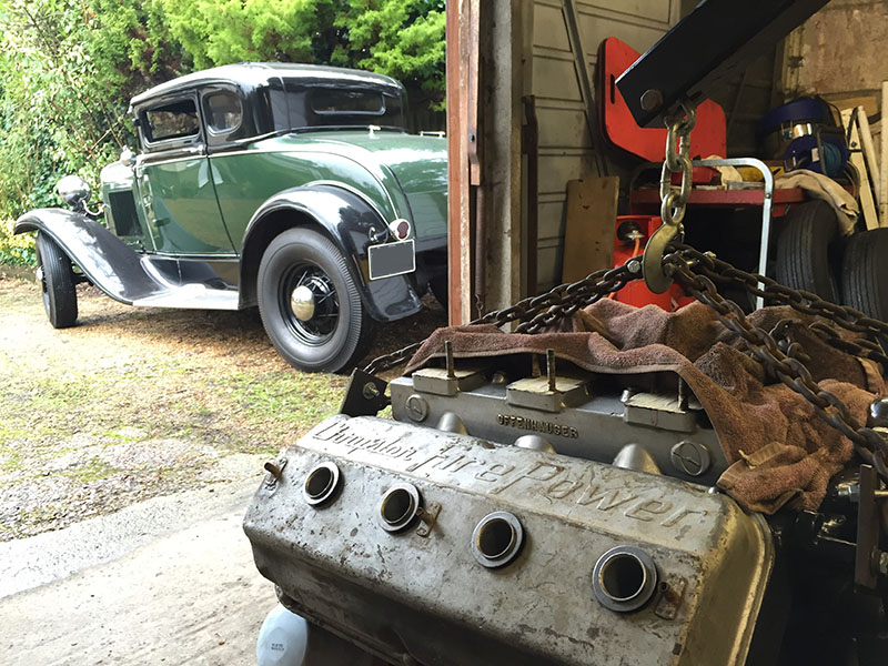

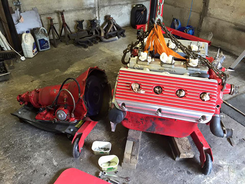

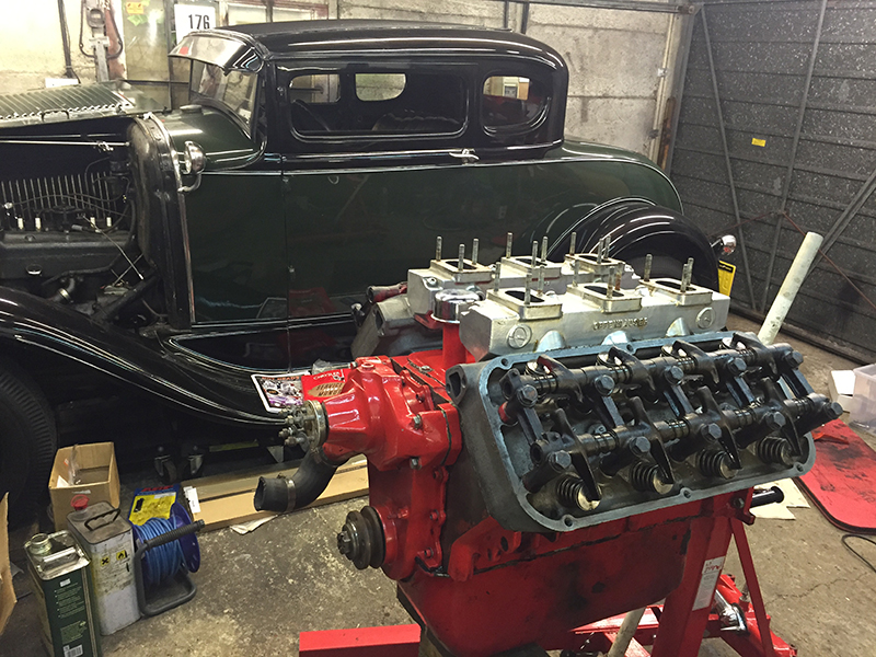

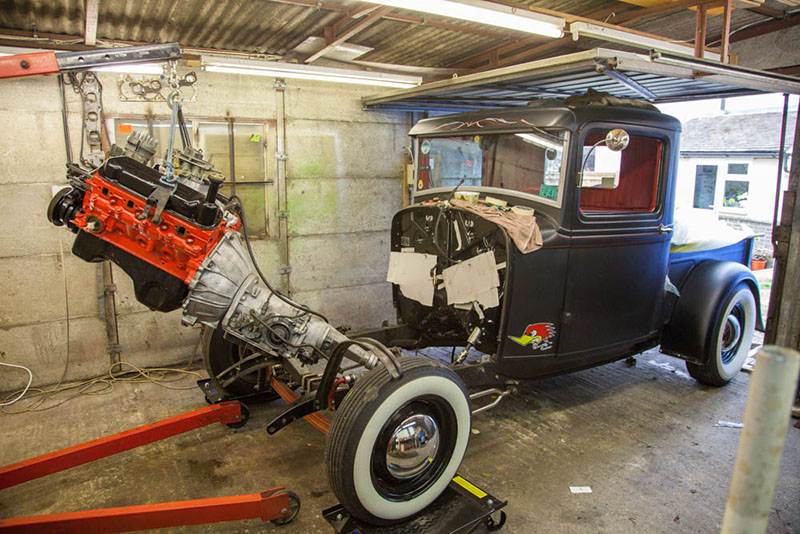

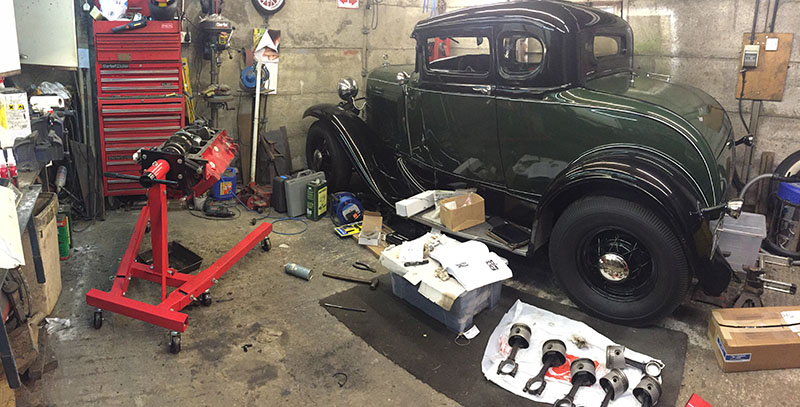

    So i had this truck i bought with the hemi in. I’ve been using it the last 6 years, although i liked it and changed loads on it, it just wasn’t quite right. Then i had a the bright idea, or stupid idea of pulling the hemi and buying a Model A coupe…
    Ford in a Ford… seemed quite novel. Slapped it all together and sold it on.
    I’d bought a Tremec 5 speed and a Wilcap adapter kit, so it was going to be bye bye to the GM700R4.
    My Nephew came to stay for the week and helped with the motor swap. Trial fitting the Tremec

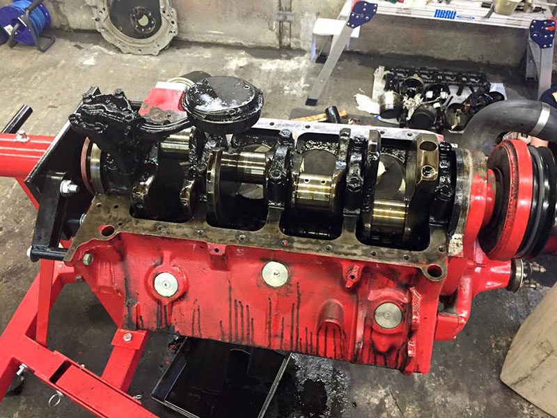

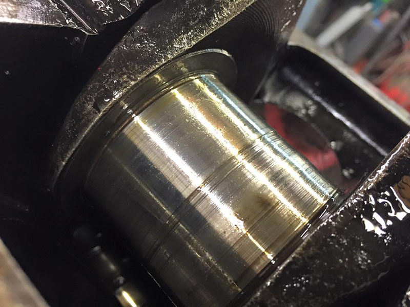

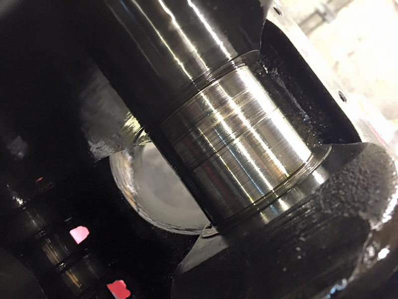

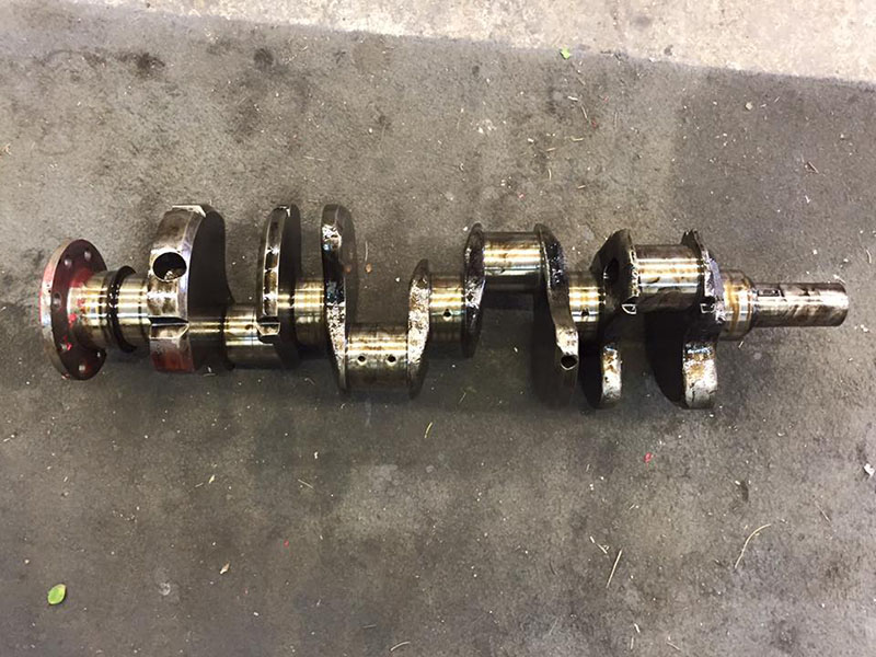

    Seemed like a good idea at the time to pop it on a stand and have a look inside
    Dang it, two big ends were a little wobbly
    Bit of a nasty step aaaarghhh !

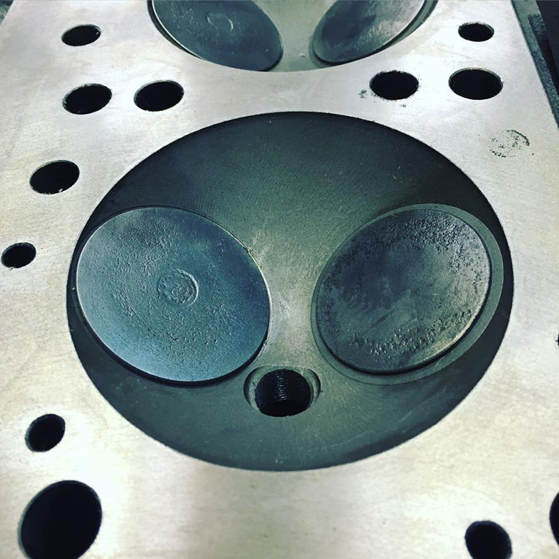

    Out came the crank and was sent off for machining along with the heads for new valve seats and a good check over.
    Like it or not… you’re having it !

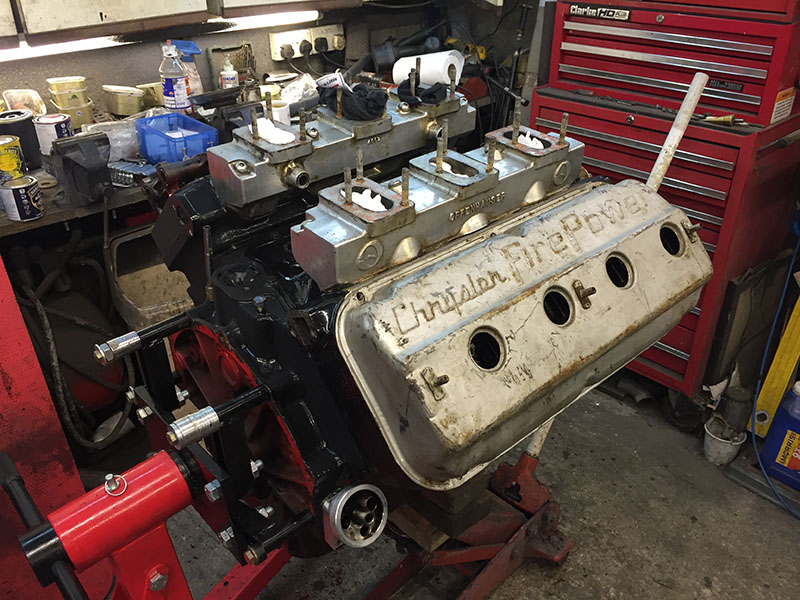

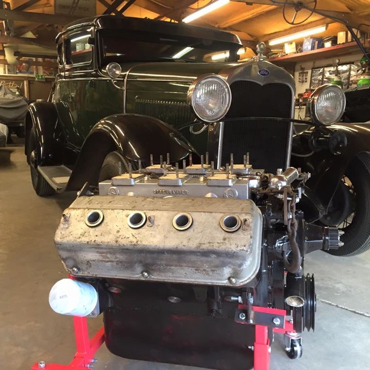

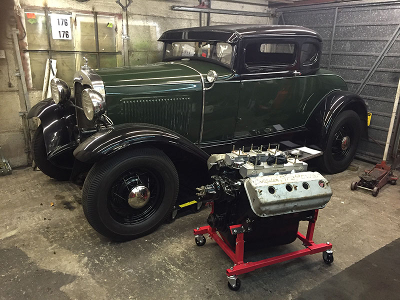

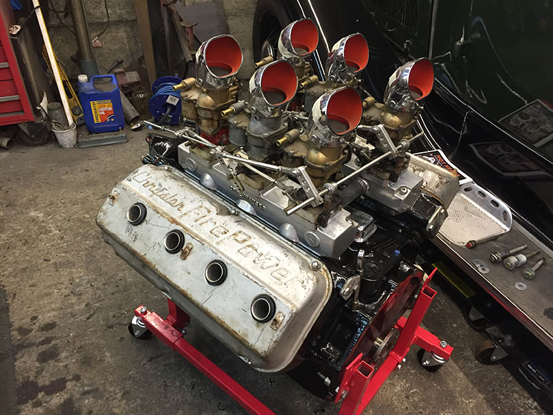

    Thanks folks, here's a little more hemi porn:
    My old valve covers
    My new old valve covers. Then i just stood and stared at it !

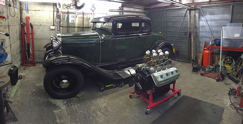

    Then it had to be done… stick the holley’s back on for a look… as you do
    And there sat the happy couple waiting to be joined together

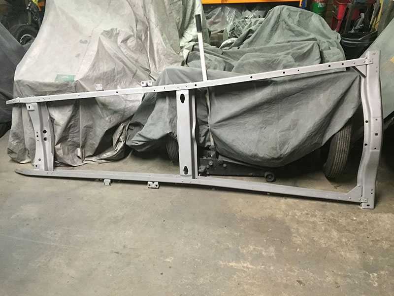

    Frame back from being blasted

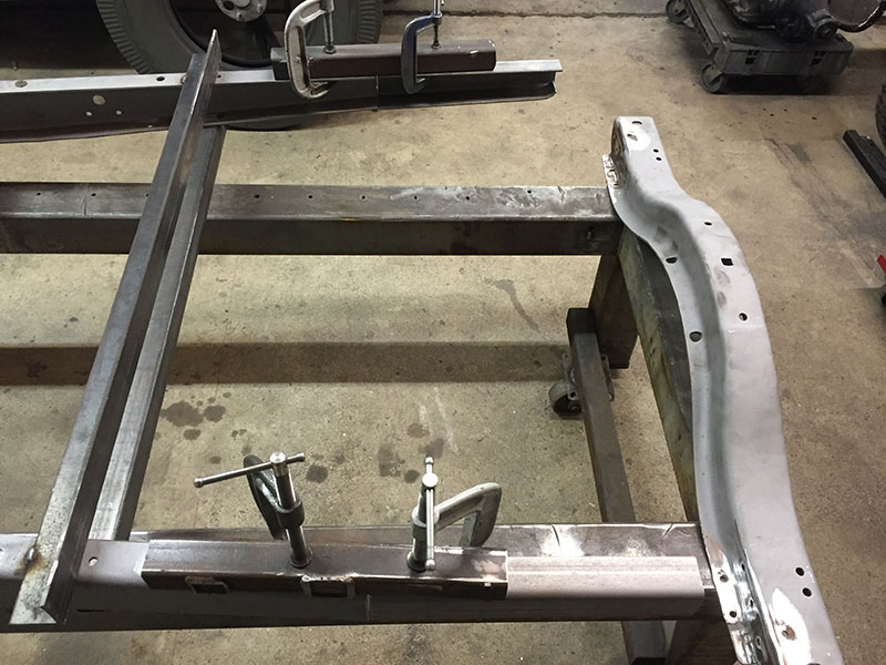

    Frame getting extended ready for spring behind the axle
