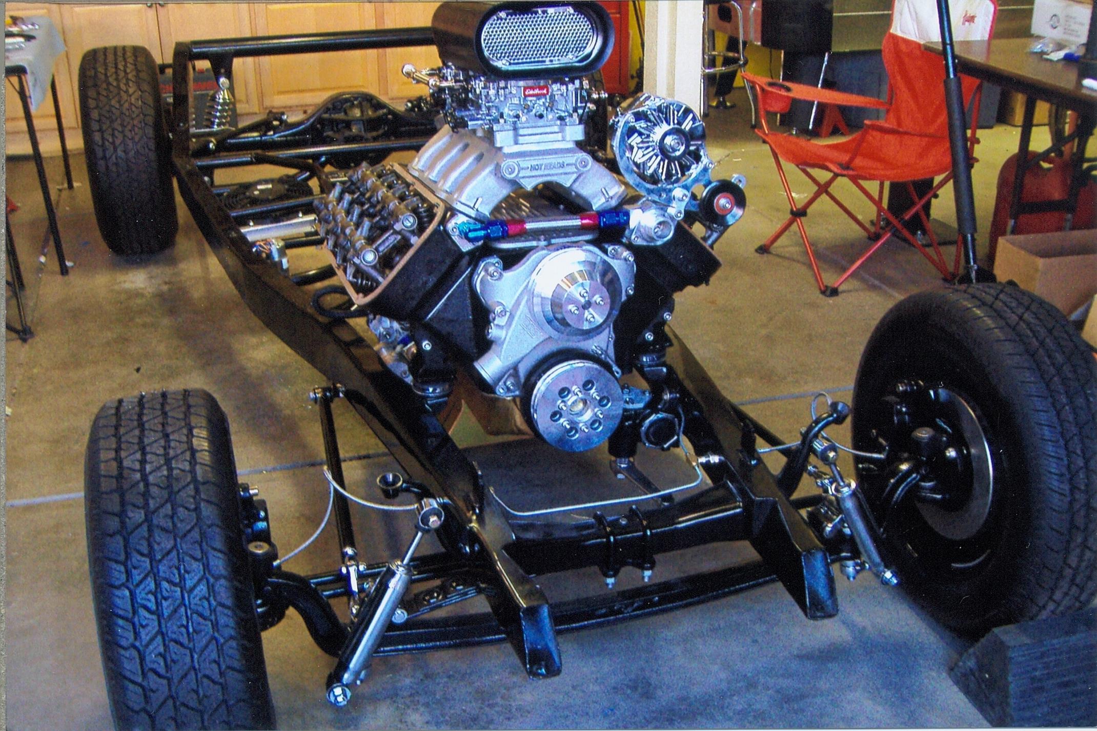

    @ ghost have you a pic from the side?
    hers my frame

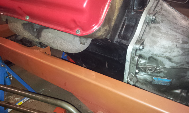

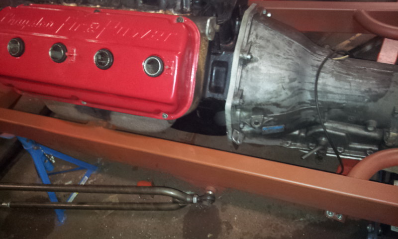

  7. Ghost28
    Joined: Nov 23, 2008
    Posts: 3,195
    Ghost28
    This is as close to a side shot that I have showing the placement of the vega box.
