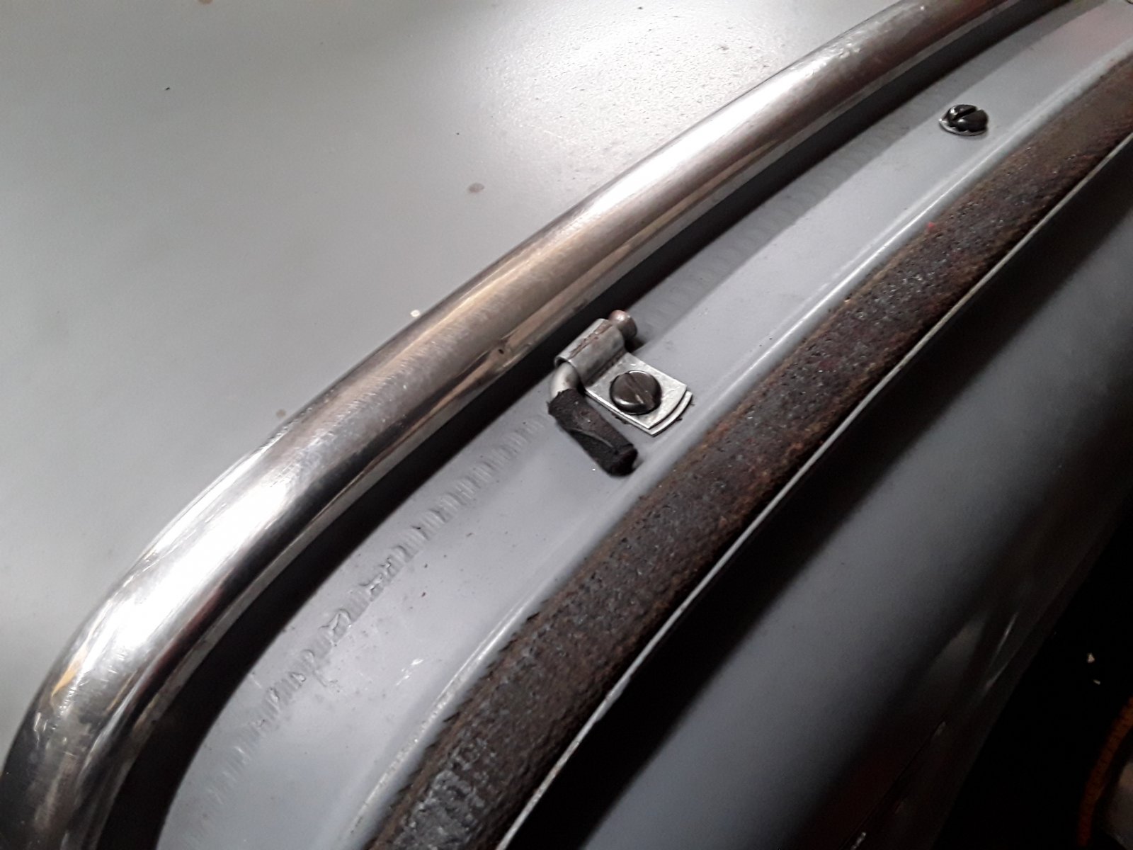

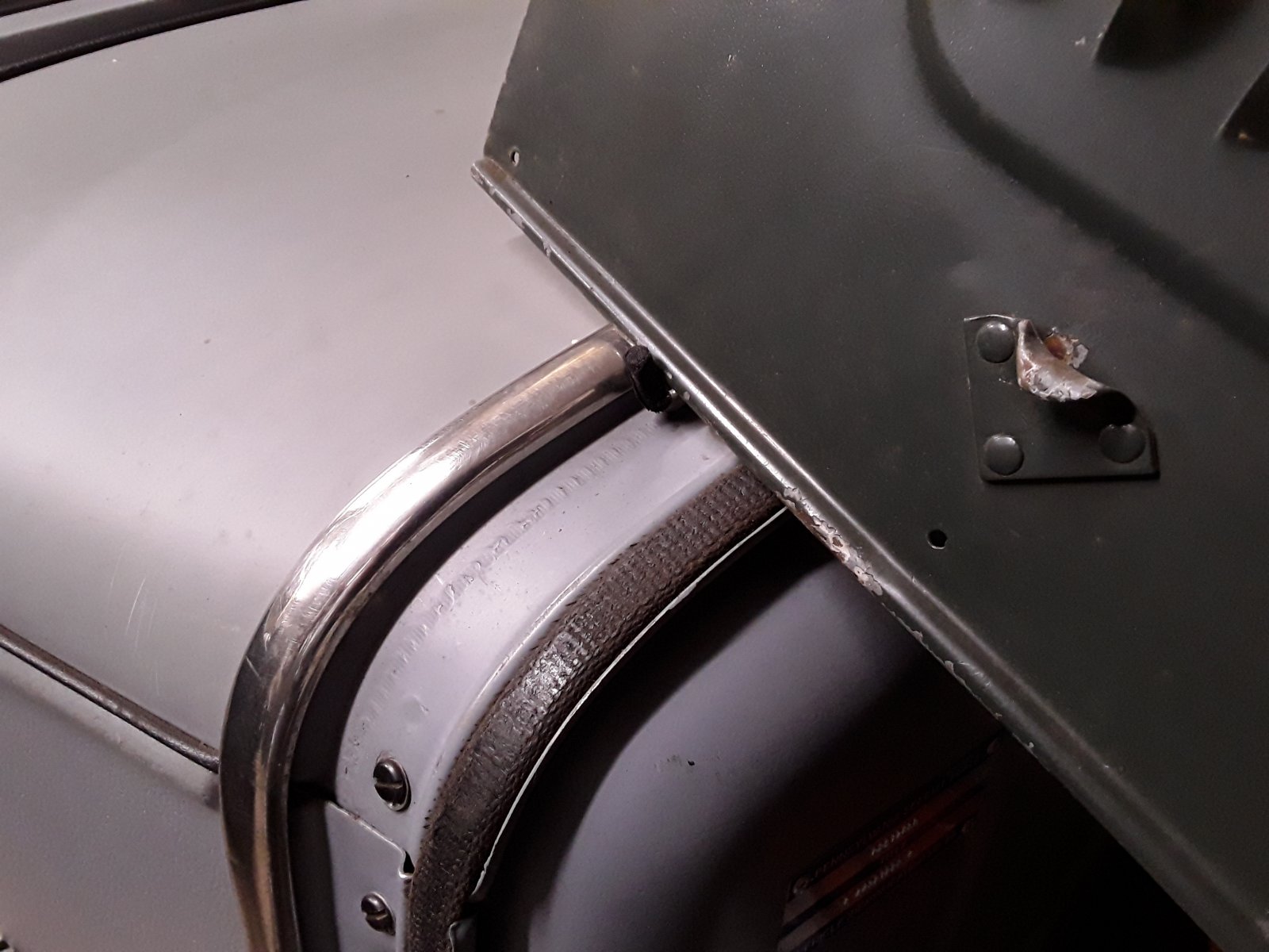

    Here’s the scoop on mine.
    I wanted something no one else had, so I fashioned these out of some left over shop materials. Minimalistic but they work fine.
    Made a trunk mounted bracket to hold the rods.

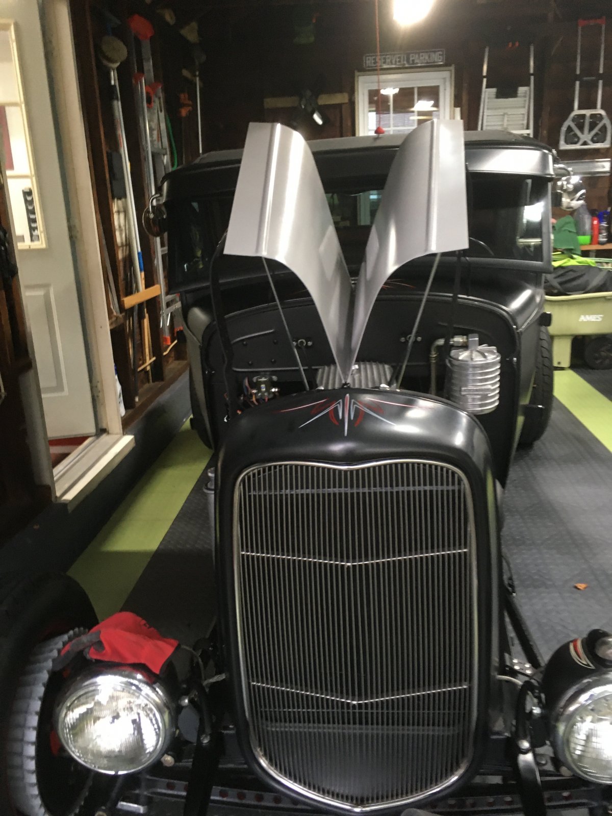

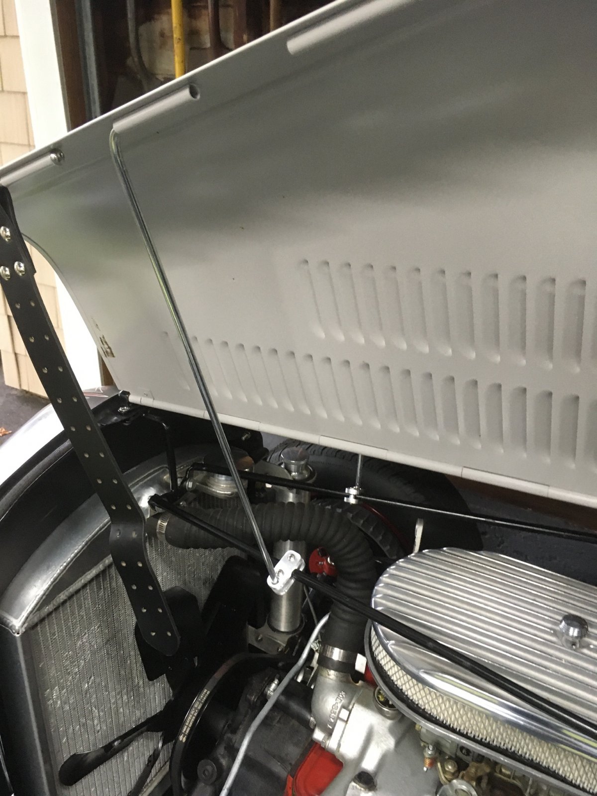

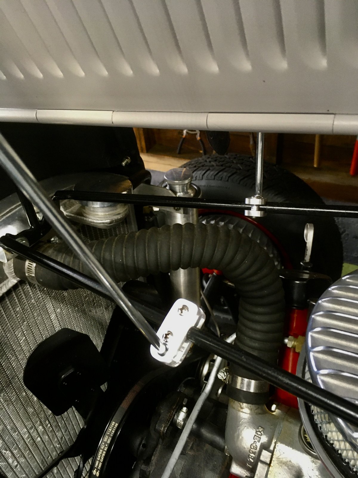

  12. There just round stock swedged on on end. I flipped them side to side from the last photos to show the best opening you would get using the existing gas tank mounting holes.

  13. scoop
    Joined: Jul 4, 2001
    Posts: 1,524
    scoop
    Thanks alot,this is what I'll be doing.
