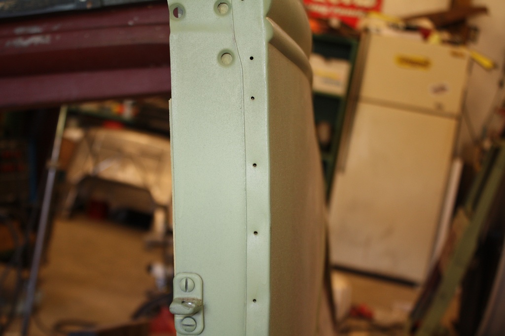

    All you at home Model A builders out there, I have a question.
    What did you do with the seam for the rear quarter in the door opening?
    The rear quarter was nailed thru the door post. Anyone welded this joint, or did you leave it alone?

    I replaced all the wood in my Sedan with square tubing and welded up the seam shown in your pics, after I took all the panels off and blasted the rust away.
    There is no seam there anymore on mine just like there is no seam between the back and side panels anymore.
    My body is super rigid now.

    I think that area looks like shit,with all the dips in the metal around the nail,are you just smoothing with bondo or what,i think smooth would look streetrod,i dont like the dips but i think it would lood more traditional?
    Any pics of what you have done in this area?
  16. i welded the door jams on my `28 tudor , filled the nail holes and smoothed it all out with dura-glass filler. the wood in the door post was glued in with PL400 construction adhesive. i wanted the wood so the upholstery could be attached
    sorry..... to lazy to take pictures, but i think you can visualize how it looks
    been that way for 16 years and it's fine
