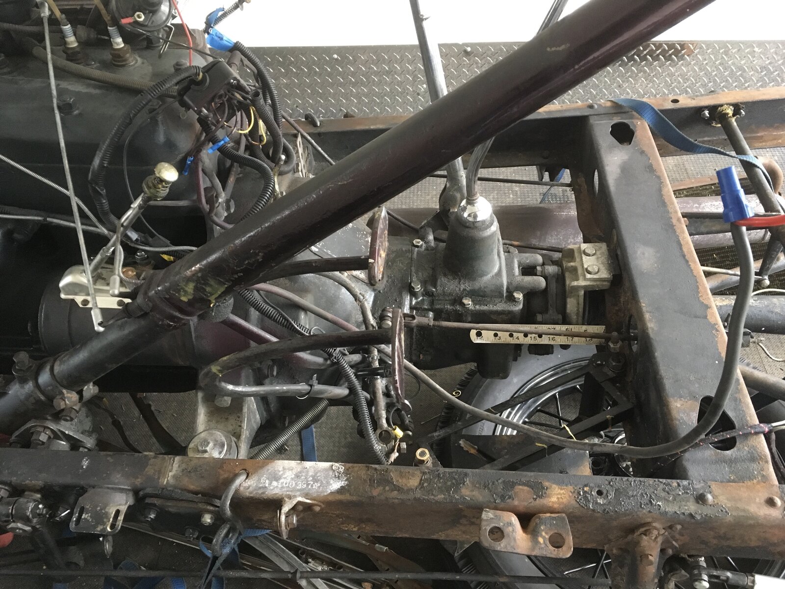

  4. I’m far from an expert as well but from my (limited) experience Ford stamps look like this 2EFBC057-62CA-4E34-BC84-72B3577D70D8.jpeg
    The 9s/6s look like a lower case “b.” But maybe they didn’t start that until later?
    Now I just went to look at the A motor I have and it looks like this…
    CCE05321-BBE6-4543-8534-85C6D6A98BEE.jpeg I have no idea on its origin.

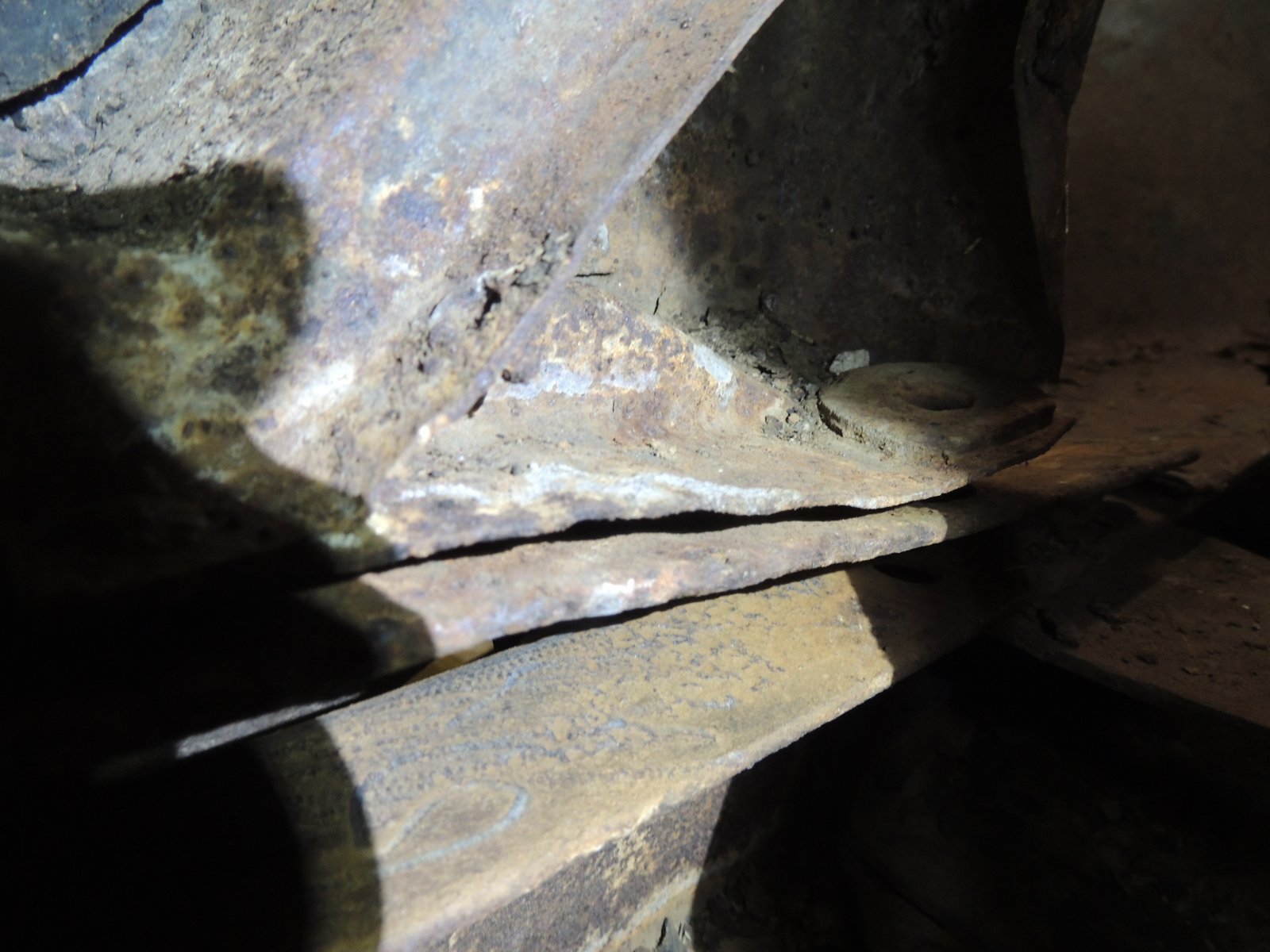

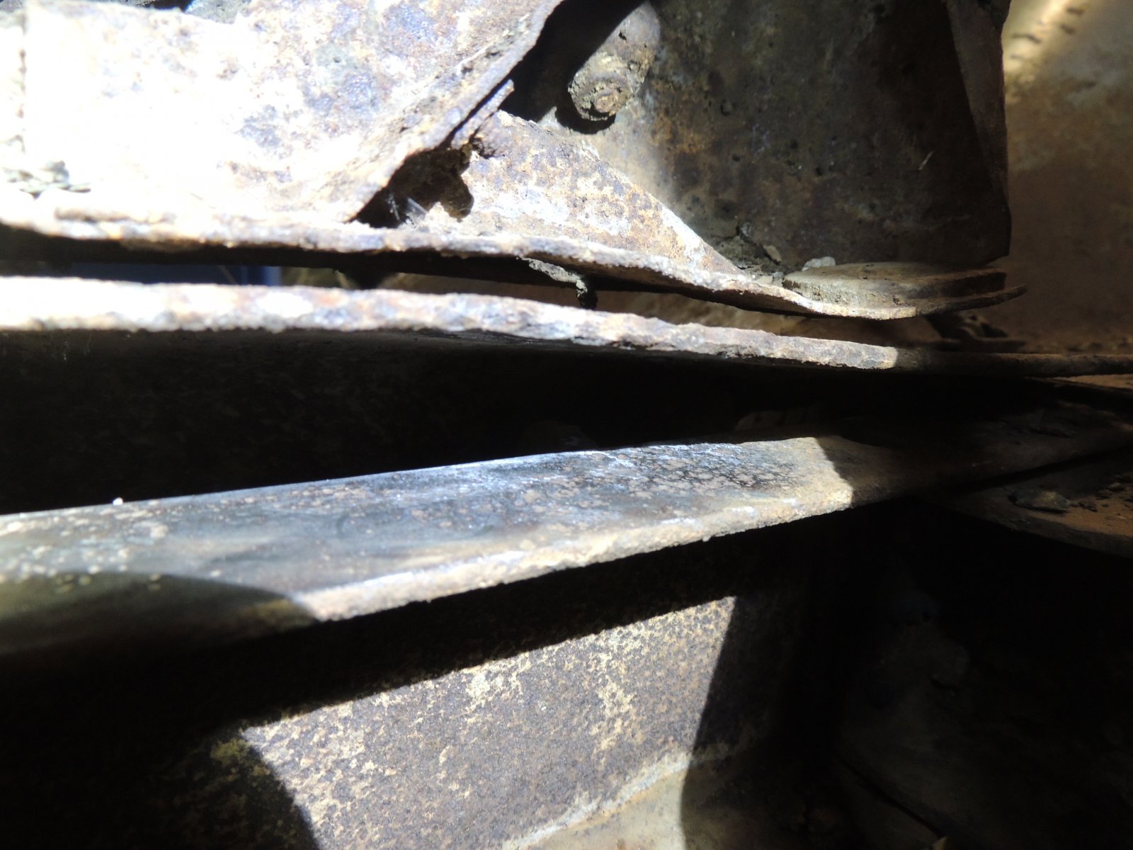

    Is it possible that any of the frames did not get a number stamped on them ? I saw mention of that somewhere that frames didn't always get stamped but don't know if it is accurate or not. I managed to raise the body and runningboard about an inch or so and cleaned some residue out. Could not see any number or remnants of a number.

  16. Budget36
    Joined: Nov 29, 2014
    Posts: 15,471
    Budget36
    Raising an inch may not be enough. That’s a pretty shallow angle to see stamped numbers.
  17. ekimneirbo
    Joined: Apr 29, 2017
    Posts: 4,218
    ekimneirbo
    I had a bright light and a mirror and I could see the surface pretty well. I cleaned it out with a wire brush and then ran a rotary tool across the surface to make it somewhat shiny but not remove any metal. I could see a somewhat pock marked area on the far side but other than that it was just flat and smooth. I would have seen something if a number was stamped in it, but there was nothing there. Its way too much work to get the running boards unbolted along with the body.

  18. ekimneirbo
    Posts: 4,218
    ekimneirbo
    Here are 4 of the pictures I took. Blew them up larger with Microsoft Paint which really enlarges them. Couldn't find a trace anywhere, but my eyes aren't the best either.
  19. dwollam
    Joined: Oct 22, 2012
    Posts: 2,880
    dwollam
    They are not all in exactly the same spot. Seems they can be anywhere within about a foot or so.
