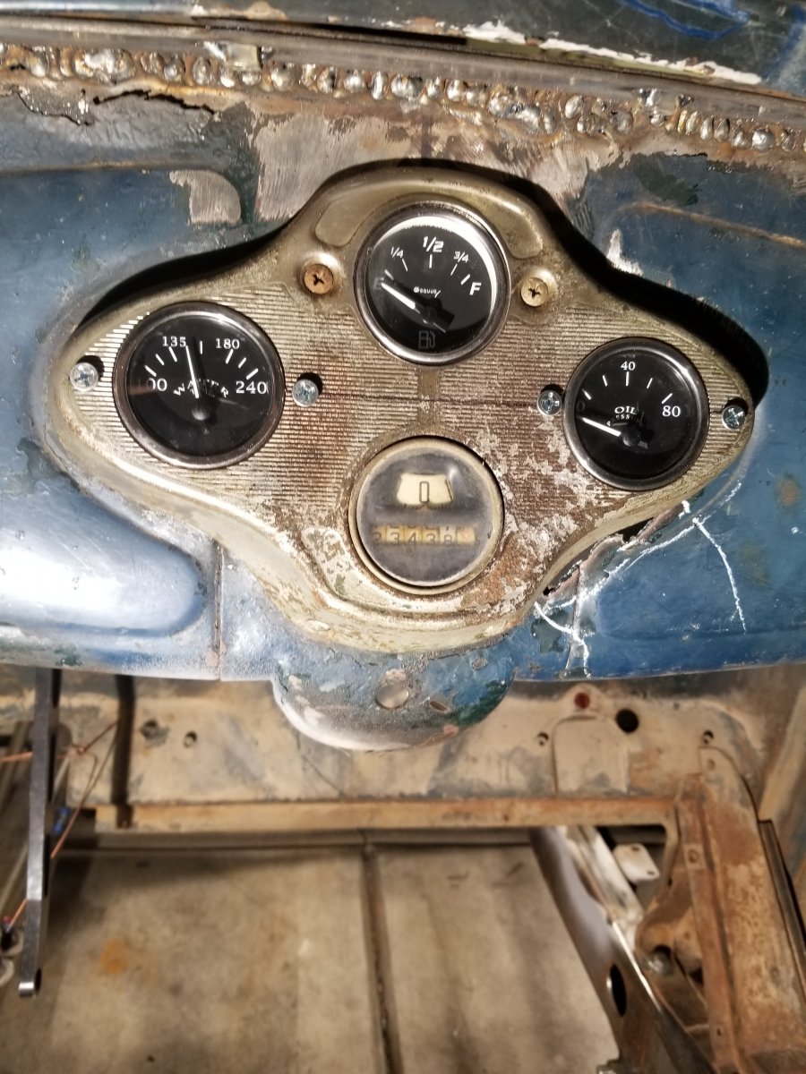

    Want to upgrade speedometer ,Has anyone used a motorcycle unit?
    They are small but not sure the work the same as car type.
    The stock unit goes to 80 mph.
    Any suggestions welcome . I can enlarge the original hole but wanting to go 3 1/2" A dash 31.jpg

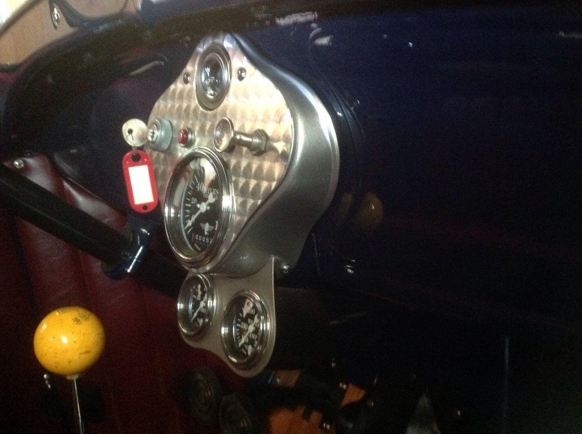

  3. Your main problem is clearance between there tank and the instruments unless you are going to cut the tank. I (acknowledging that tastes may vary) would go with something like the era correct aftermarket ones in the pictures or mount the instruments in the right cowl panel. Keep the stock instruments in the dash including the speedometer unless you plan to go over 80MPH, in which case you can carry a GPS to measure speed.
    Charlie Stephens

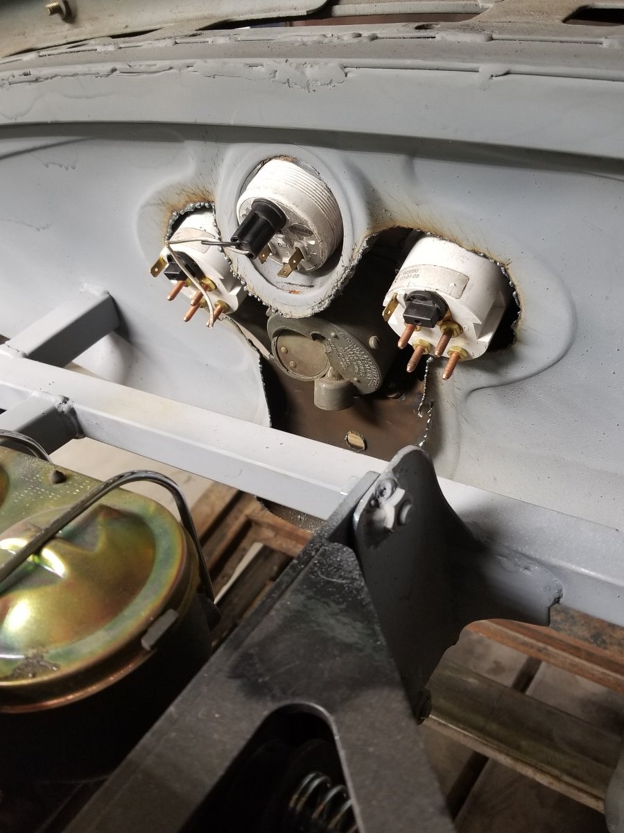

    I cut my stock gauge panel and added a pie cut piece of metal, welded back together. That let me run a deeper stock Stewart Warner speedo. Still running the cowl gas tank.
