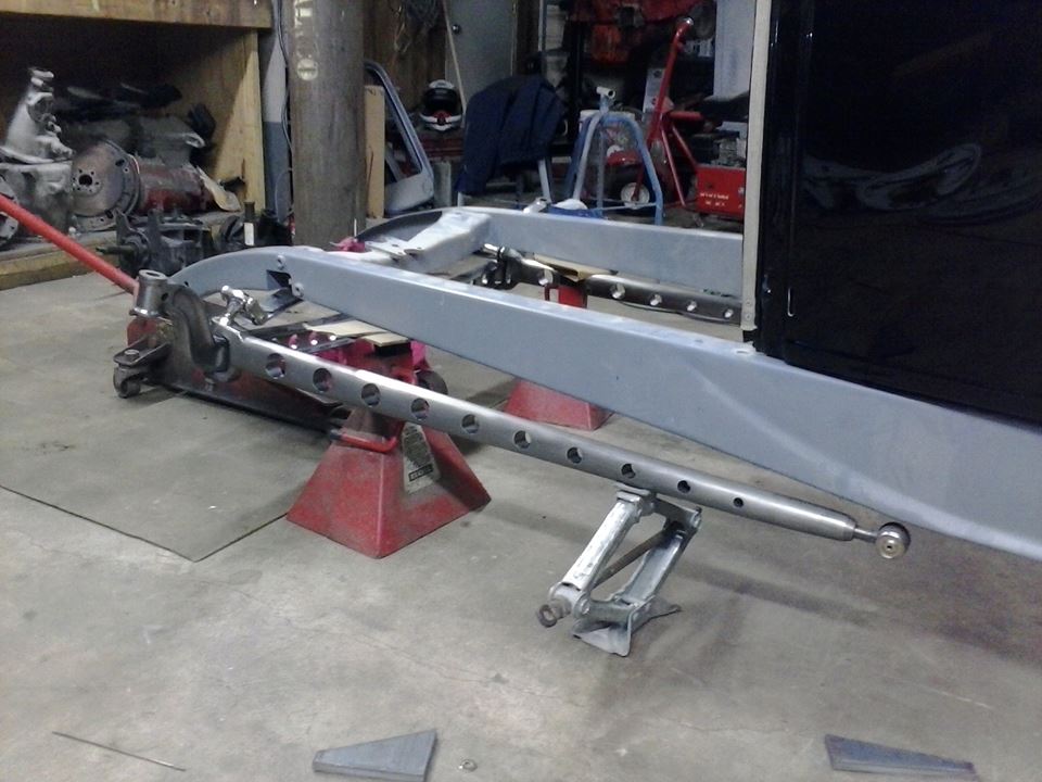

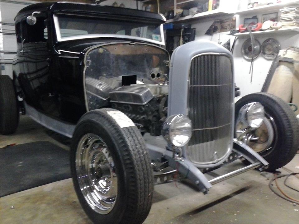

    build pics of 1931 ford coupe on 1932 ford frame, keeping the traditional theme of a 1962 period hot rod. Drilled I-beam, drilled and split wishbone, F-1 steering, Drum brakes, small block chevy three deuces, ram horns and 4-speed trans

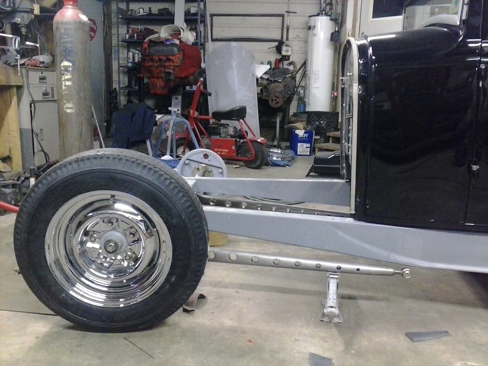

    I really like the chrome and pie crust wheel combo.
  5. F-6Garagerat
    Joined: Apr 12, 2008
    Posts: 2,652
    F-6Garagerat
    Those are real ford wheels too. Not the catalog 10 lug universal jobs. Where did you get them chromed?

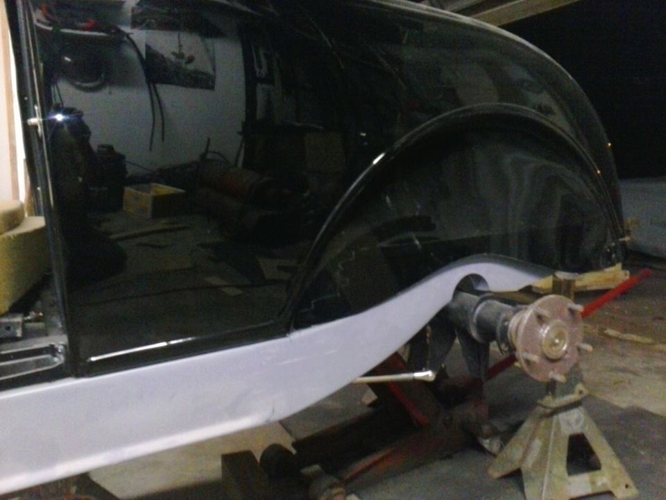

  6. The37Kid
    Joined: Apr 30, 2004
    Posts: 32,780
    The37Kid
    Nice! Welcome to the HAMB, I'm building a 1962 period perfect '30 Roadster. What are we looking at in this photo, sub rail kickup? Bob [​IMG]

  8. Rusty
    Joined: Mar 4, 2004
    Posts: 9,487
    Rusty
    I likey that firewall

    Wheel and tire combo is dead on, looks great
  14. gould1966
    Joined: Nov 17, 2013
    Posts: 6
    gould1966
    from texas
    Yes rails to match the rise in the 32 rails. I know there are other ways to do it but this will keep a more smooth looking floor.

    gould1966
    from texas
    The wheels are from wheels Vintique. Also Change in the steering department, I'm using a 1940 ford instead of the F1. It keeps the nostalgia and no angle issue

    That is very sweet ,great job . Could ya give details on the wheel/tire sizes .they do look very nice .

    like he said...sizes of wheels and tires...purdy please.

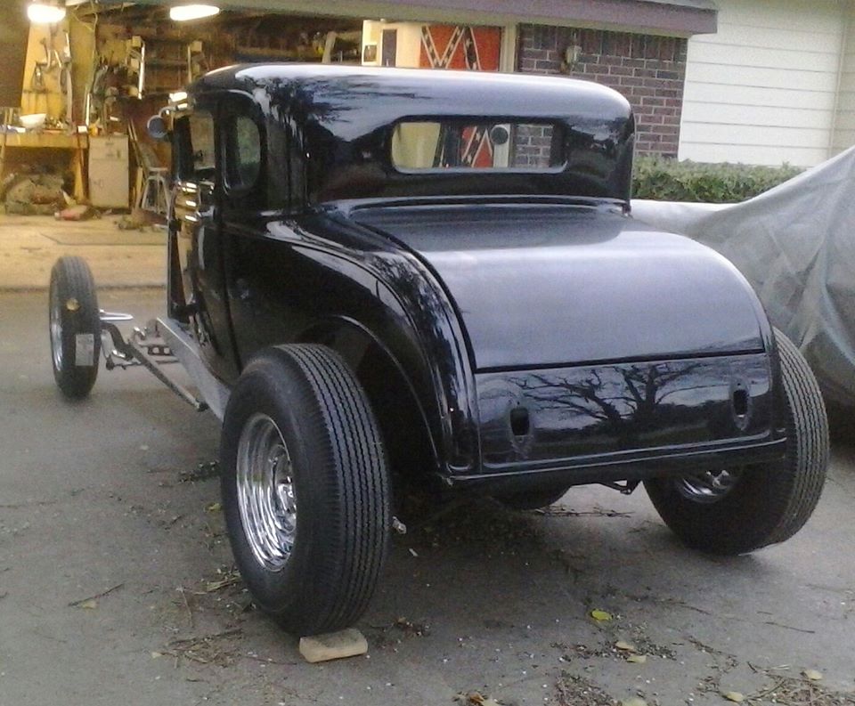

  23. Stance is killer on this car-nice!

    Please please give us some details on the wheel and tire combo you got it rite stance is perfict nice build
