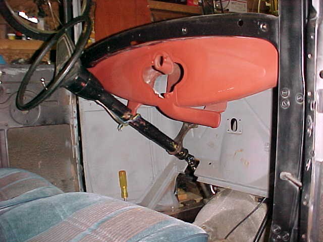

    You asked about a column, don't know if it helps but here's what I have:
    Steering box: 1965 Mustang
    Steering wheel, shaft and bearings: 1967 - 73 Chevy truck (?)
    Steering mast jacket: exhaust pipe
    Lower mast jacket support: Late 1931 Ford
    Re the steering shaft etc that's what I was told when I bought the complete assembly at a flea market... I removed the mast jacket etc and just used a piece of exhaust pipe. I welded the lower end of the shaft to a Speedway Ujoint.
    See photo
