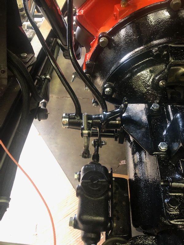

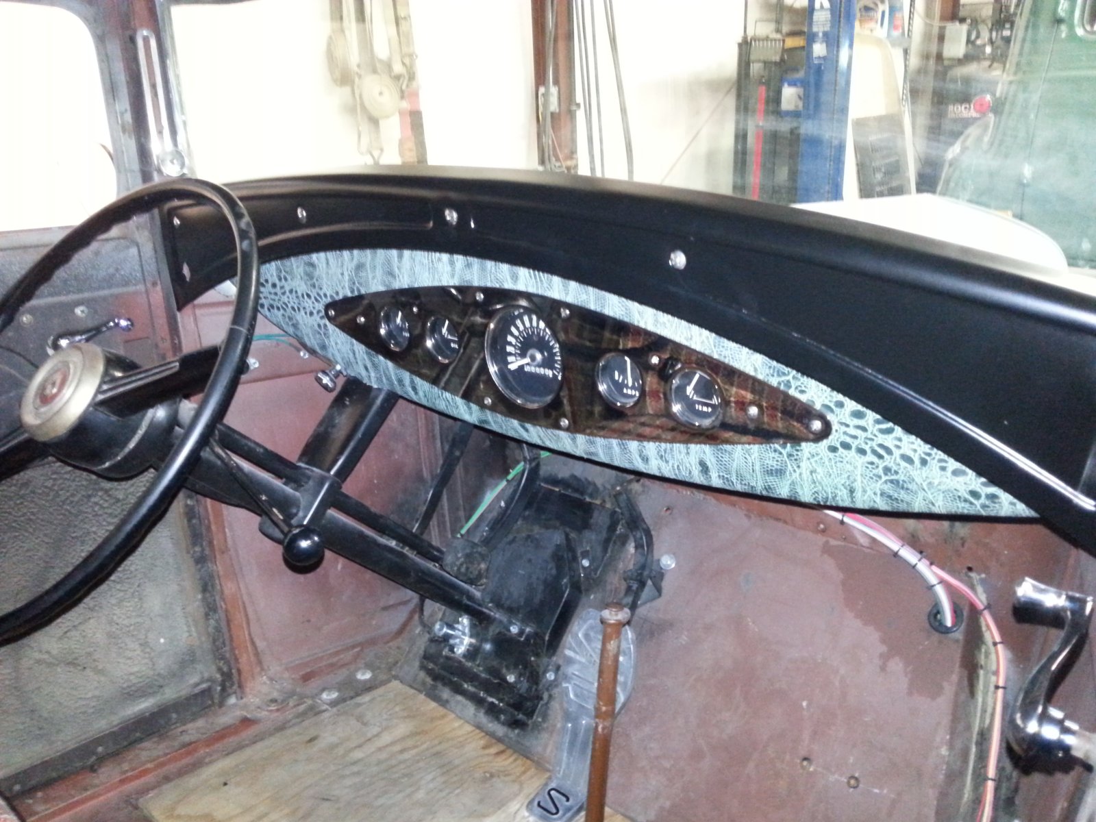

    cabong
    When I bought my Model A, it had clutch and brake pedals, steering column, gas pedal, and shifter that made it all but impossible to get into the ******, and even harder to drive. Being chopped didn't help any. This picture is a tad difficult to see, but the clutch and brake pedals are slightly higher than the new column position, and operate two hydraulic master cylinders. The floor shift was removed and it now uses a '53 Ford column and shifter. The gas pedal, from a modified Slingerland base drum, was moved to the right a little. All this made the cruizer much easier to enter and exit (remember, I'm 80), and actually quite comfy to drive. Model A Stick.jpg

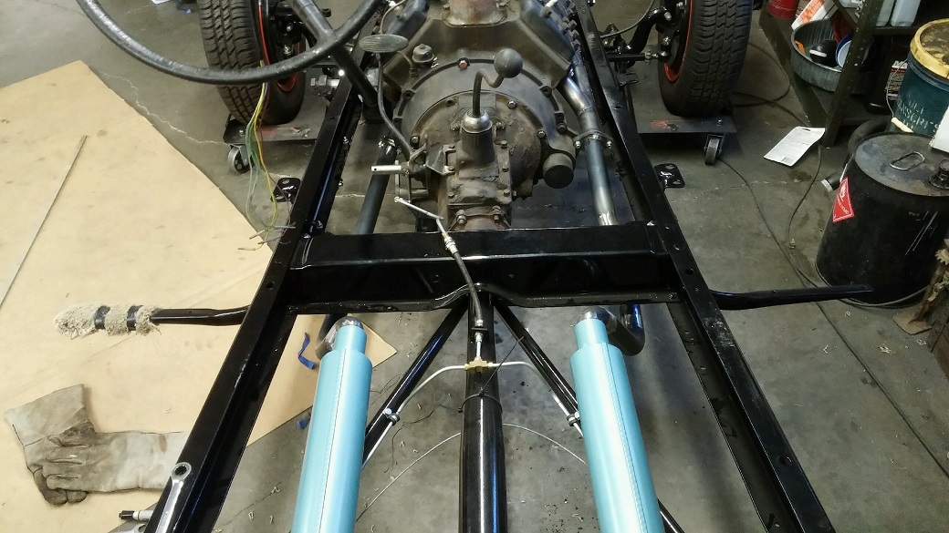

  12. I can measure mine for you one day this week. I have 32 pedals that have been shortened sitting in a 32 k-member, they have been tweaked also to be symmetrical with the steering column when its attached to the dash. Screen Shot 2023-11-05 at 10.12.03 PM.png Screen Shot 2023-11-05 at 10.14.09 PM.png

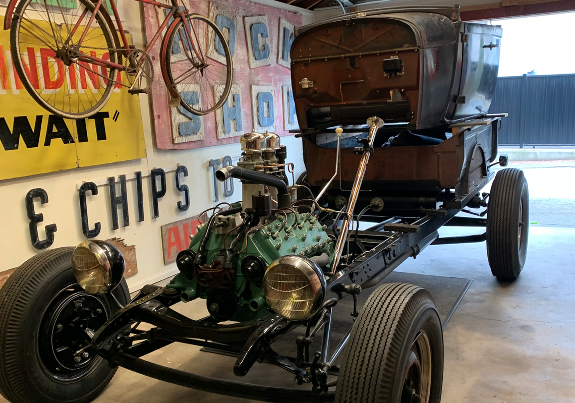

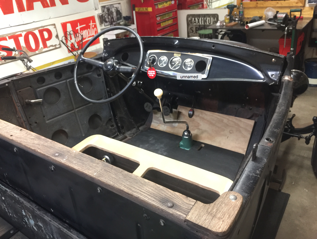

    I'm running an 8BA with a 41 pickup transmission and using an adapter from a Model A vender to mount the stock pedals on a V8 transmission. they sell them so you can run a synchronized V8 trans with the four banger. This is the second V8 A I've done this way with no problems. This is the best pictures I could find, it puts the pedals in the stock position. I running a modified 56 F1 steering box which puts the steering column it the stock position.
