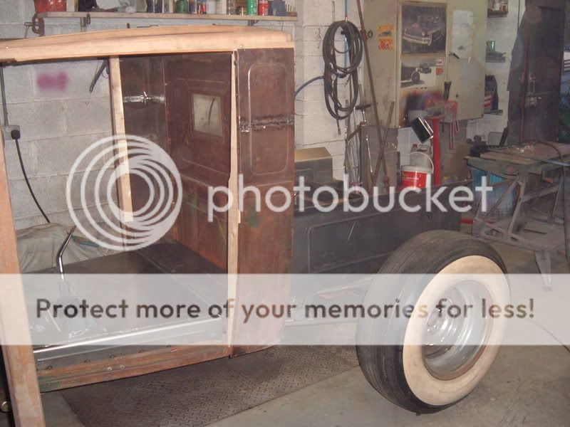

Started on this just before Xmas, it was going to be my long term project built with all the right bits that I have been collecting for the last few years. But plans change and Rottenpop made me buy his Model A tudor sedan . So I am now putting the pickup together with bits I have lying around to sell and get some cash for the next project. Heres what I have done to date Started with the 4" roof chop I had new wood for the roof

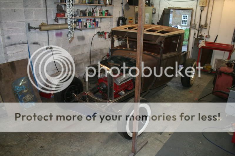

Next with the ch***ie Used a stock Model A ch***ie with a new rear box section kick up added and home made crossmember Engine is a 283 SBC and 3 speed manual box
Is that the stock subframe, or did you use something else? i've got a 28 cowl and a T subframe I was thinking of putting together as a PU and purchasing all the other sheetmetal. But I wasn't sure if that subframe would work for the pu. thanks!
No, they are different. If you are planning to use new "A" sheetmetal, you might as well spend the extra $200 or so and get the correct "A" subrails too.

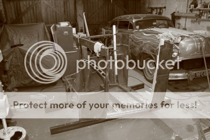

After toying with the idea of using the old bed I decided it was a bit too far gone and had a go at fabing up a new one. Enlisted my top beed roller (My 9 year old daughter) Then folded up the top and bottom Just got to make the stake posts and put some 1" box on the top edge. This is at end of play today

Sorry, not sure I understand. Are you leaving the 1" in there or cutting it out. (Personally I REALLY like the squared look on the back and sharp line down the side.)
