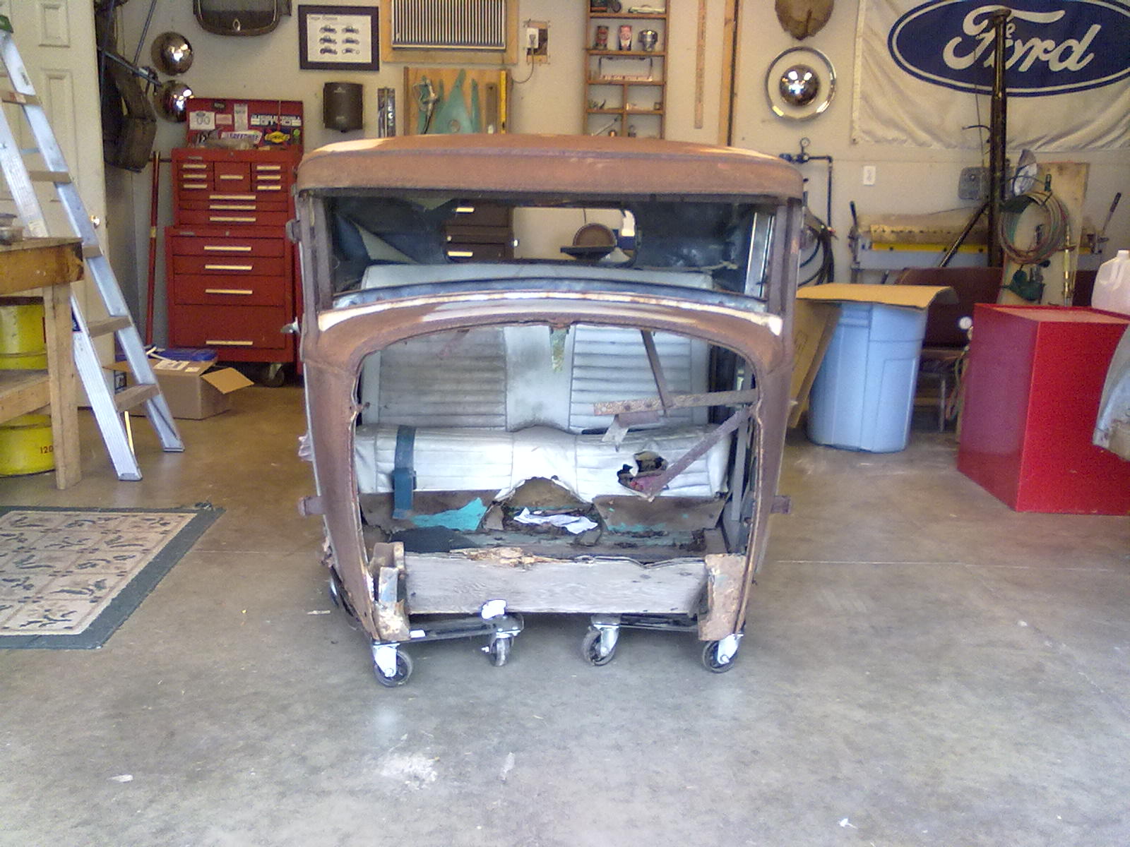

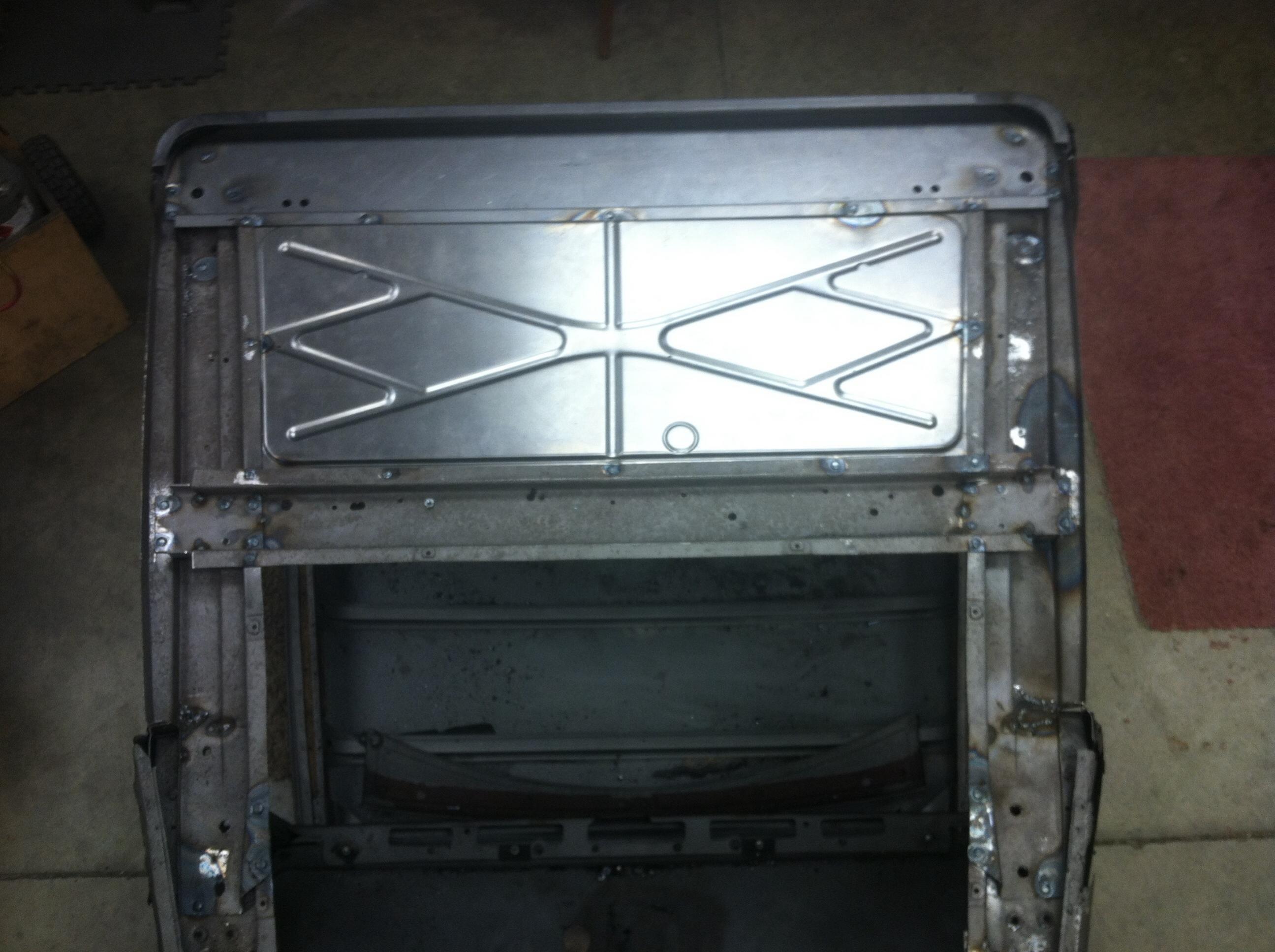

  3. F-6Garagerat
    Joined: Apr 12, 2008
    Posts: 2,652
    F-6Garagerat
    Well, the floor is finally rivited back together. Going to get the cab back on the frame this weekend and start hanging/chopping the doors. After that I can start on the patches.

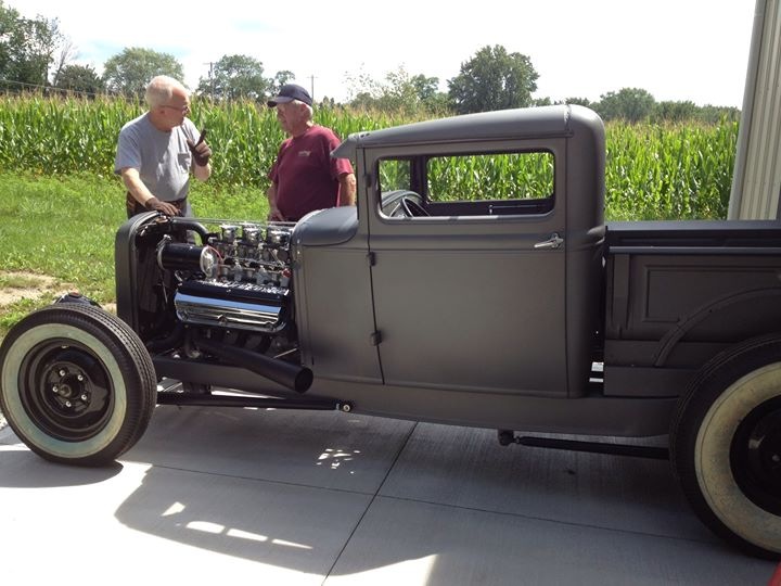

    One door, sorta on, lol. Progress is progress. My brother cut some nice oak body blocks. Cab is bolted down now and the door chopping has begun. Last pic is my buddy Ed.

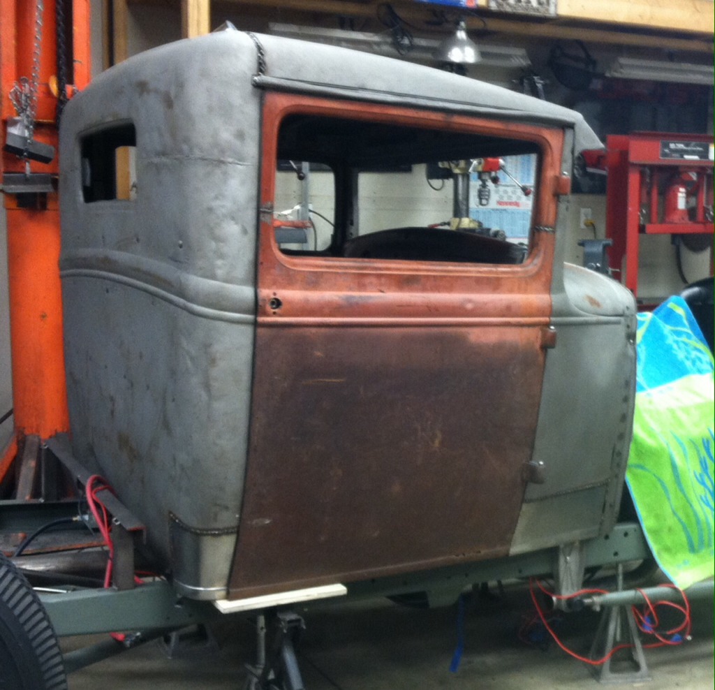

  15. F-6Garagerat
    Posts: 2,652
    F-6Garagerat
    Got one door on. So far so good. Over the last few weeks doing work on the floor of the cab my brother and I came to a conclusion. This old hot rod body is only going to be so nice. It will never be 100% right. It's just had a rough life. It's so far out of shape it's not funny. To really fix it right would be more money than it would be worth when done. So, it's gonna be as good as it can and nothing more. Do get me wrong, I love this thing. But buying a nicer coupe, truck or roadster body would just make more sense. I have been without a driving hot rod for 2 years. Sold my last one and figured this one would come together fairly quick. Well, it didn't. I got sick for 2 years and **** just didn't go as planned. Now, I'll drive this thing for a few summers and enjoy it but, it will never be as nice as I imagined. It will be fun as hell though because I won't be sitting on my *** this summer, I'll be driving my hot rod.

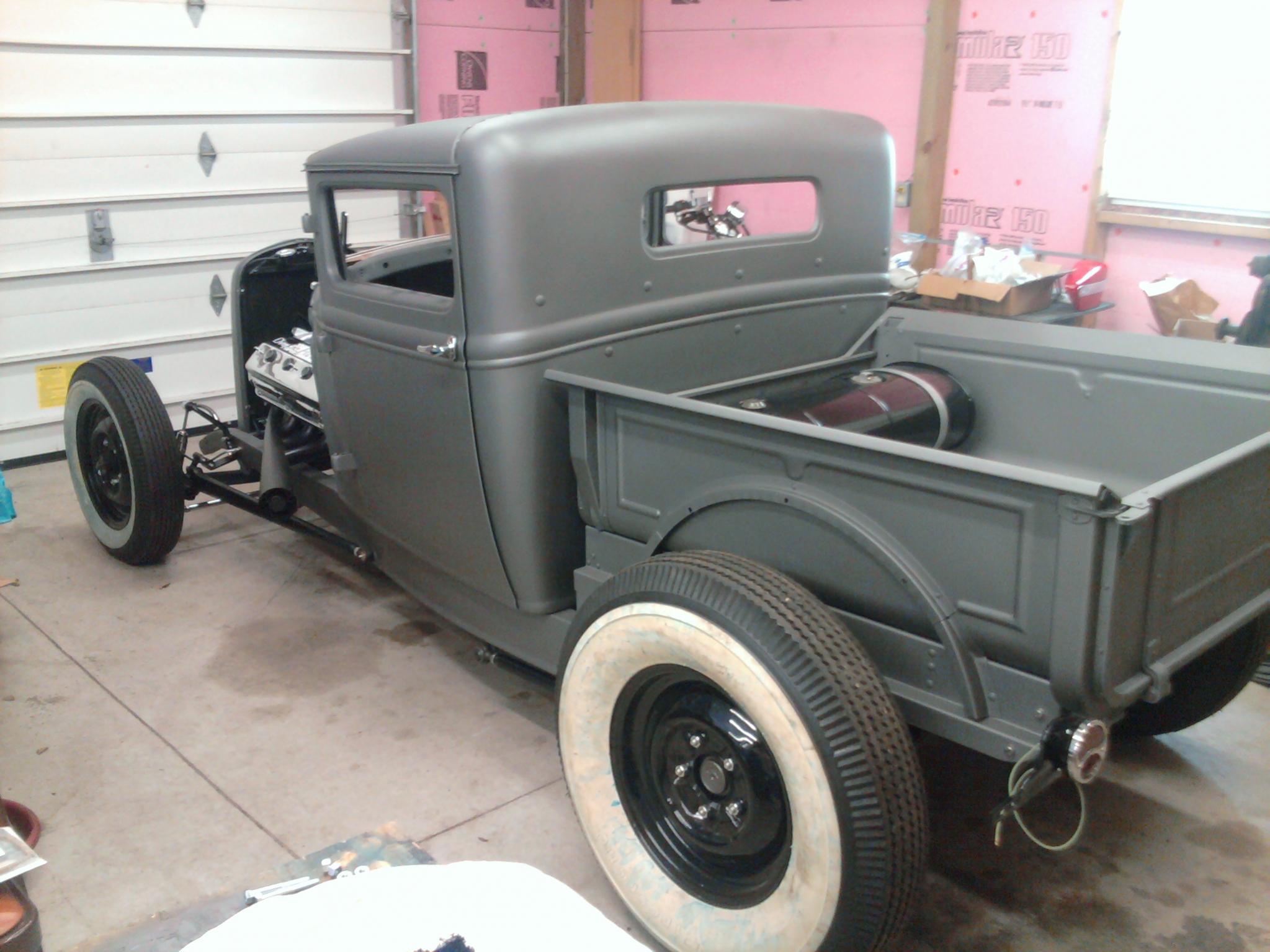

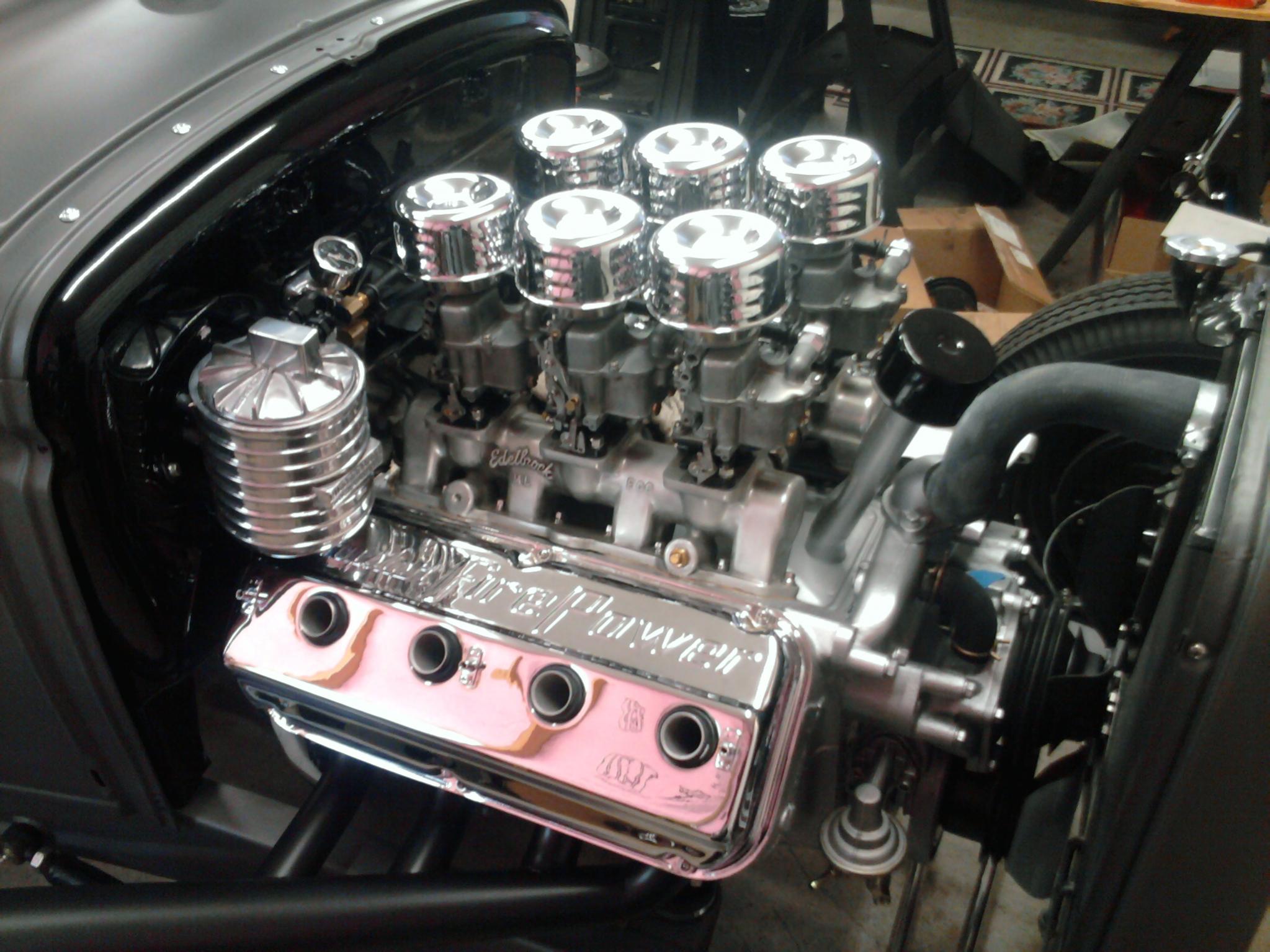

    Well, patch panels are done. Bear claw latches are done on doors. Steering box flange needs to be made then the steering box/column/wheel can go back in. I made a flange before and welded it on. It was good but at the time I was using one of those "32 roadster dash for an A" catalog things. I hated it. I have a 36 dash I put in which is done too but the column was at the wrong angle now. So new flange is needed. I've been so busy getting ready for Autorama that I haven't taken many pics. I'll upload some with the app in a minute.
  28. F-6Garagerat
    Posts: 2,652
    F-6Garagerat
    Pics of things that are done, some were under construction when the pics were taken.
    Oh, and pics of the original 40 Ford Standard Hubcap set that I've been trying to piece together. I've been buying 1 here 1 there. Then a guy on the ford barn says he has a nice set of 4 "driver quality" caps. He's an older guy and couldn't send pics. Well, I don't know what he's "driving" but it must be dented to F#{€!!!! Only one usable hubcap in the box. So, I still need one, and I have 2 weeks to find it. If anyone has one they want to part with......
