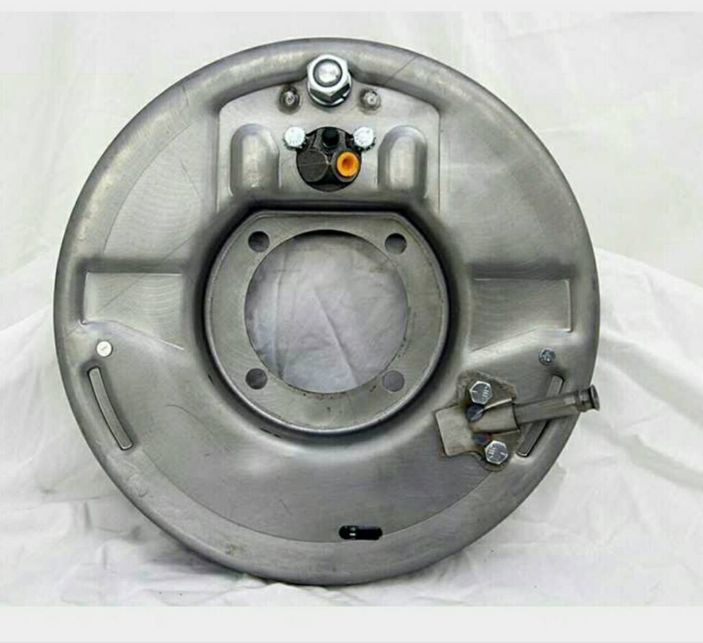

    These pics show the e-brake set up on the 40-48 backing plates.
    1 bar goes between the shoes & 1 goes to the cable.
    These are ebay photos.

    Thanks safari-wagon. Those are easy to fabricate.

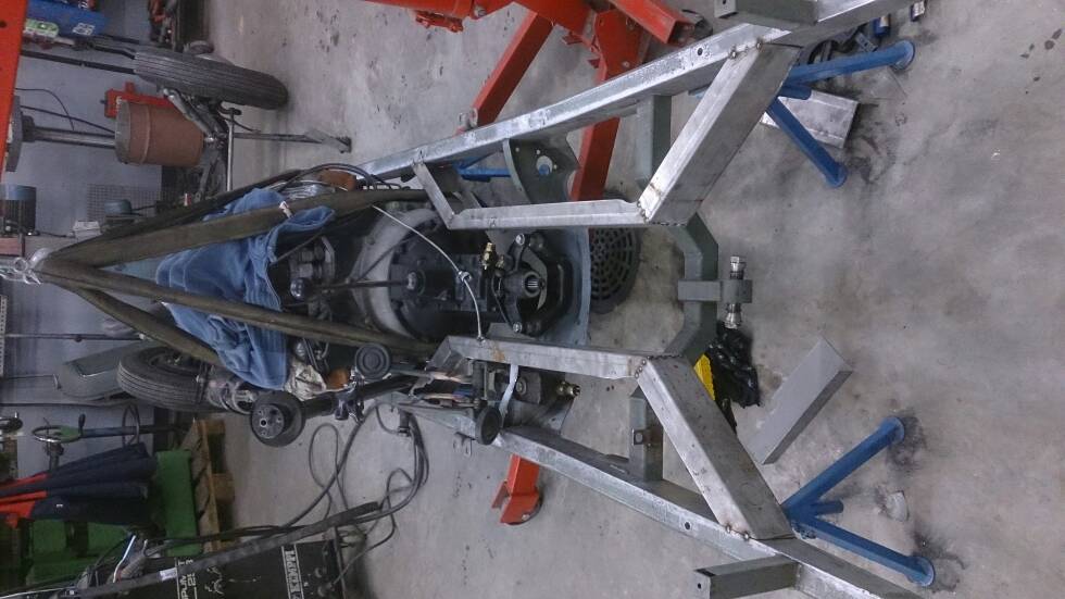

    Yesterday I took the engine off. Getting ready to start boxing the frame. Have to figure out what to do with the steering column and clutch and brake pedals since those are attached to the frame. Part that will be boxed and have to modifyed to get everything back together.

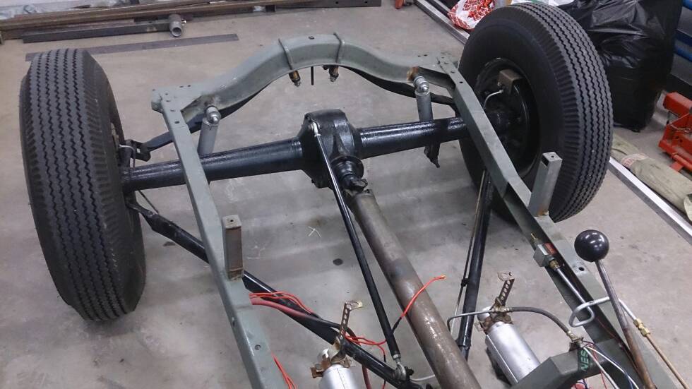

  5. mista
    Joined: Nov 24, 2015
    Posts: 137
    mista
    from Finland
    What is this rear axle on the car? I have one rusty axle that I was thinking is from model A but it's almost 20mm thinner in diameter measuring from the thickest end of the pipe. And what are those lower control arms on rear end?
    wedjim and Jeff34 like this.

  7. F-6Garagerat
    Joined: Apr 12, 2008
    Posts: 2,652
    F-6Garagerat
    The axle tubes, axles and matching spider gears (important) are 1937-41 Ford. The center section is 1942-48 Ford light truck open drive, carrier and 3:54 ring and pinion. So it's kind of a hybrid, lol. The 42-48 axles and tubes are longer length and, IMO, look bad under a Model A, especially a fenderless car. They are way too wide. So, I made the axle I needed, with stock Ford Parts.
    The "control arms" as you called them, are 1937-41 Ford radius rods.
    kidcampbell71 likes this.

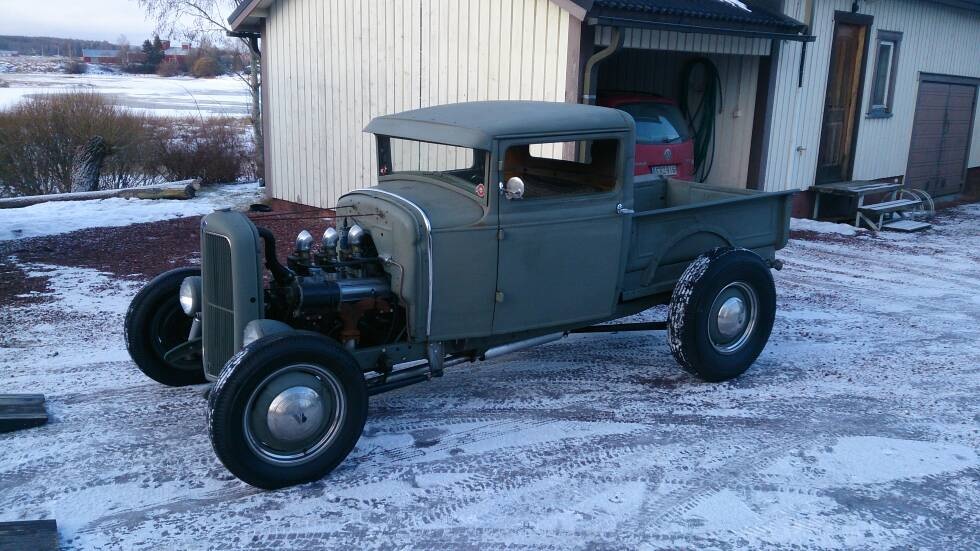

    I've been on a phone few hours to finnish transport agency and finnish hot rod accosiation and will have to make a report of every part used in this car so they can check if there is a way to get this car registrated as it is. Biggest "but" I guess for now is the steering. But we will see what else there will be. Safest way for me and I guess the easiest would be to put a flathead in it, but we had a nice talk with everyone and I think I will at least try to get this car legal as it is.

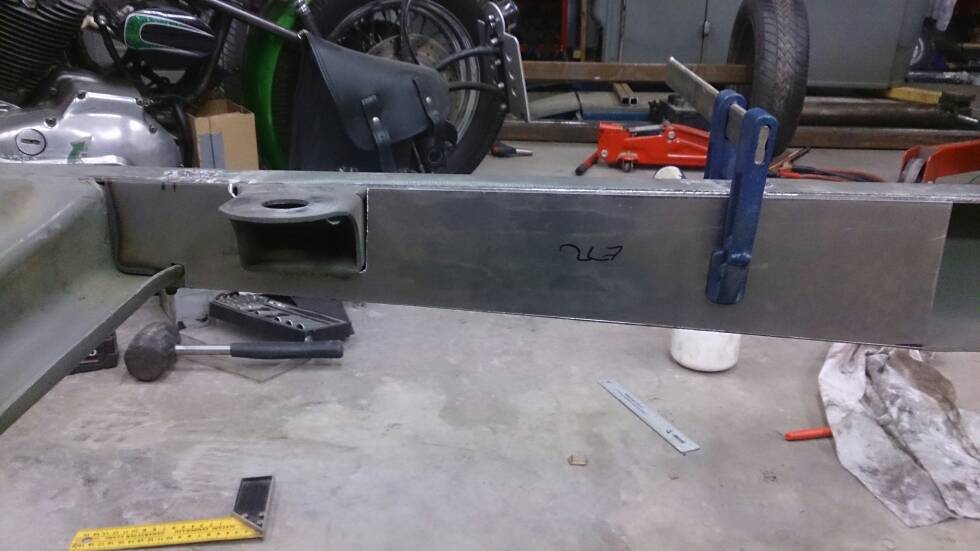

  18. mista
    Posts: 137
    mista
    from Finland

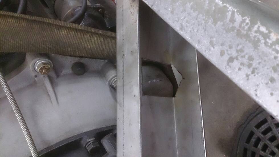

    Just a little progress. Got the first two pieces of the boxing plate fabricated and I'm quite satisfied how they fit.
    It takes time for me to do this since I have three small kids. 6, 3 and 1 year old.. So my garage time is limited only to when they go to sleep. And I'm quite tired at that time also :) But hour after hour little by little and it will be good again.

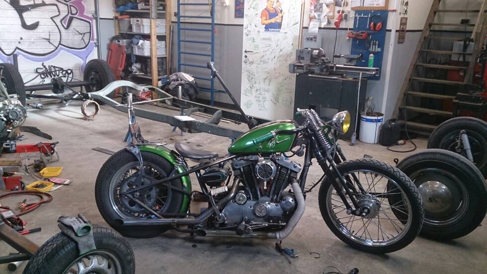

    One photo with my ironhead in front just for kicks :)
    It's funny how Scott had one picture of this car with ironhead in same garage.. So it didn't go totally strange place when it moved here.
    kidcampbell71 and Runnin shine like this.

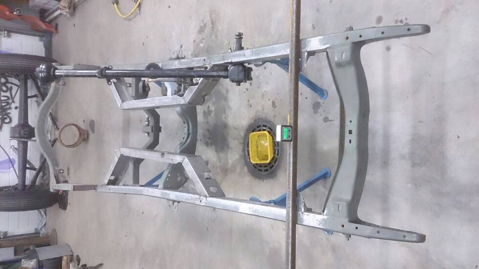

  20. mista
    Posts: 137
    mista
    from Finland
    kidcampbell71, mctim64 and waxhead like this.

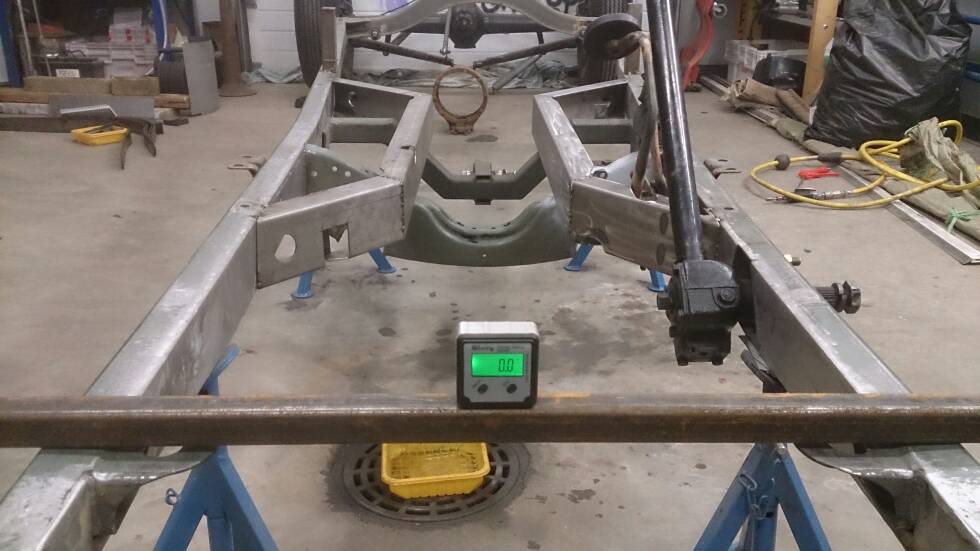

  21. mista
    Posts: 137
    mista
    from Finland

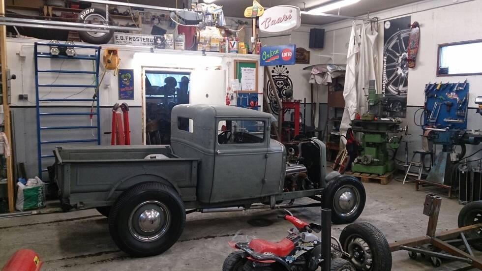

  23. mista
    Posts: 137
    mista
    from Finland
    That is a nice pic. Thank you for that. Every picture of this car is always welcome. I'll save them in my computer as a memory of the cars history in US.
    The car has its soul and i saw it and felt it the same second i saw this car first time live when i was picking it up. I'll wreally try to keep it as it is. Install the windows, door locks and i'll have to paint the frame black since they don't sell rust-oleum self etching primer in Finland and any other matt green primer.. :(

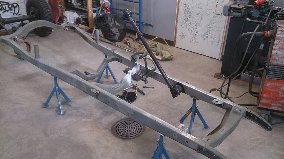

  27. mista
    Posts: 137
    mista
    from Finland

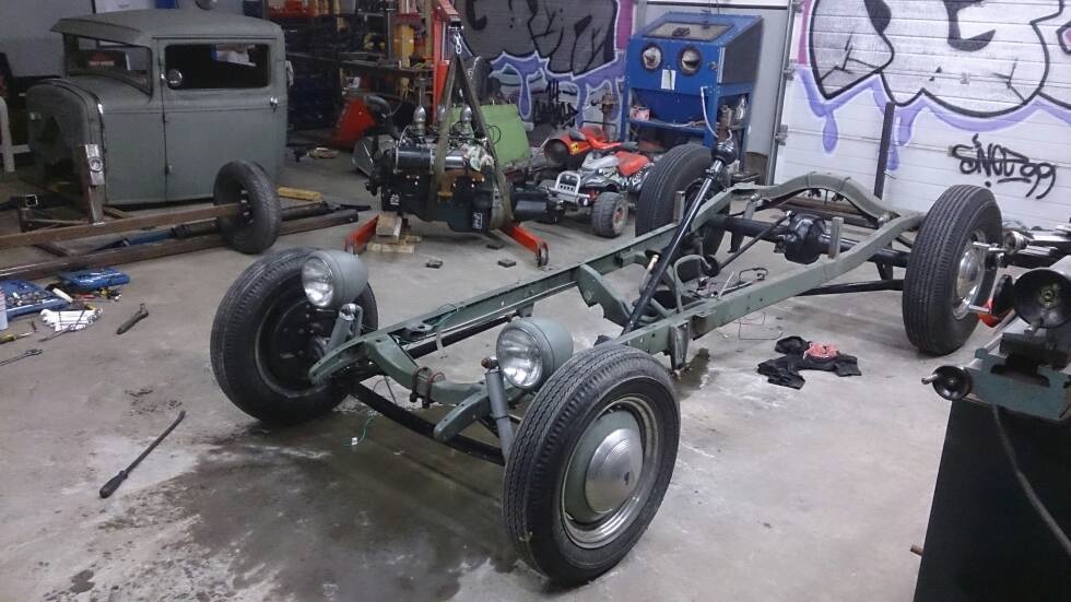

    Last weldings on the frame are done. Made also some small brackets for brake lines.
    And now i know that it will be impossible to get this car roadlegal as it is. Here in Finland. So i'll have to put the flathead v8 in it at least for first tech inspection. Now i just have to find one somewhere...

    Yeh. Those fu..ers try to limith anything here. Max 140hp engine, 4 links front and back, disc brakes etc...
