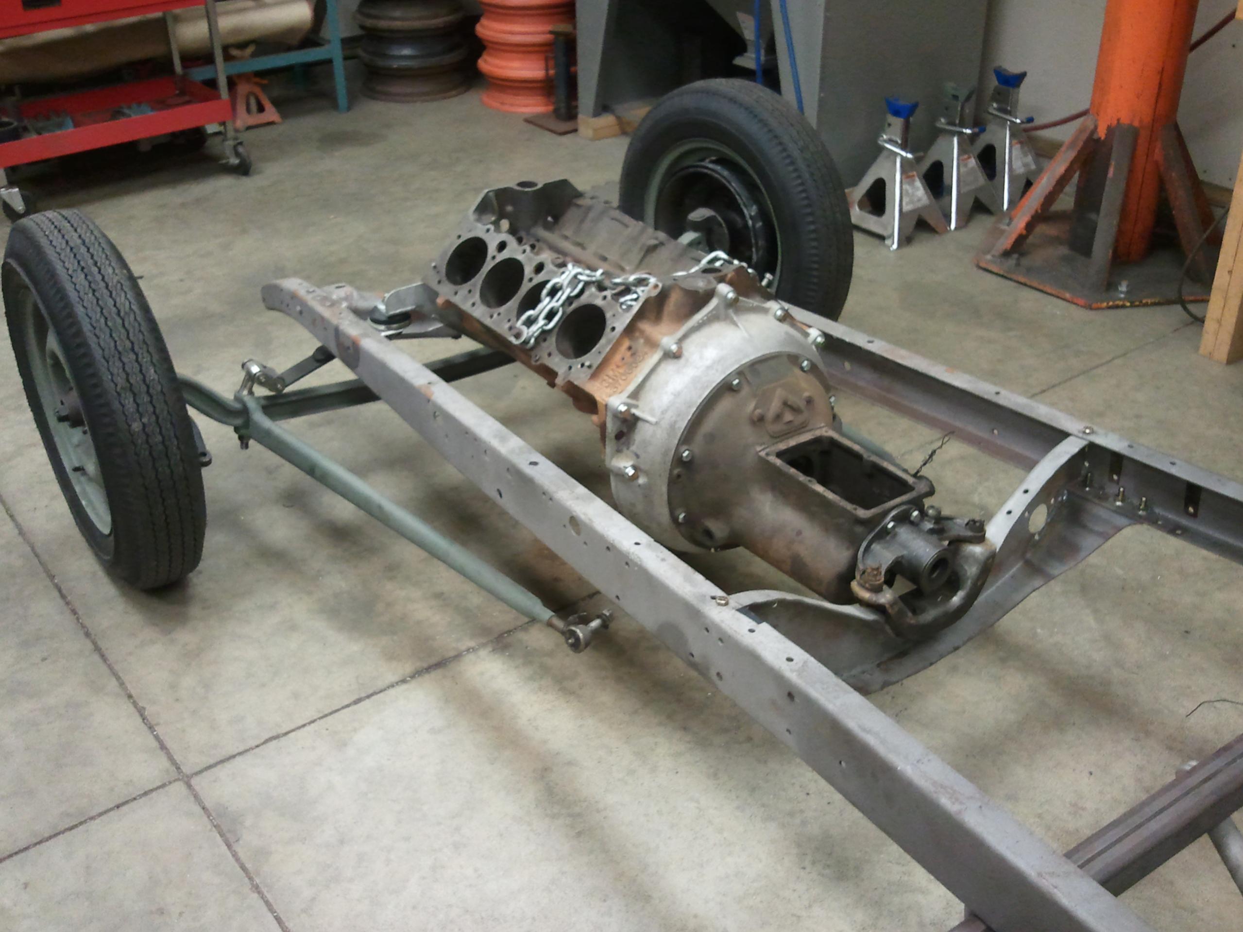

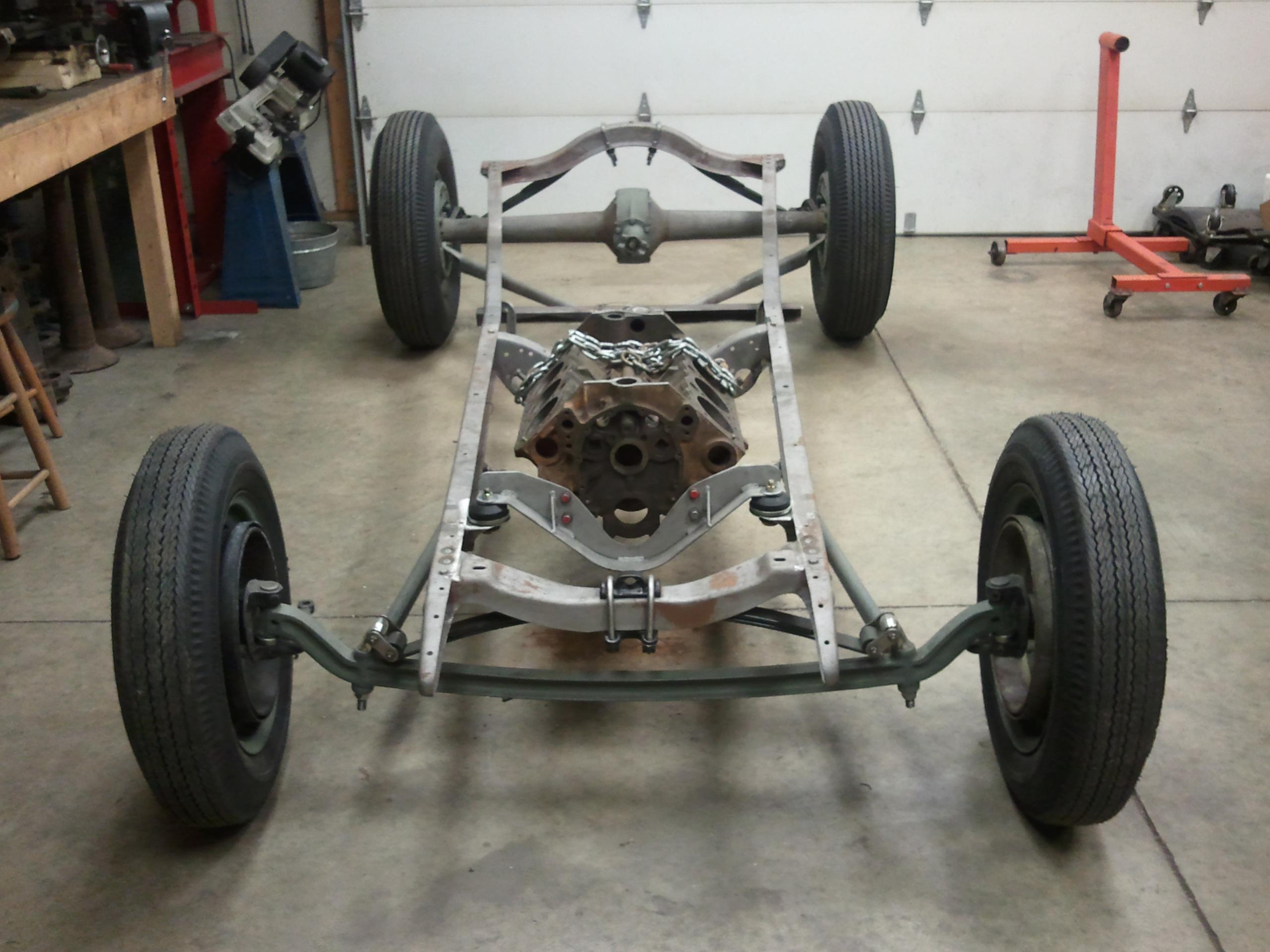

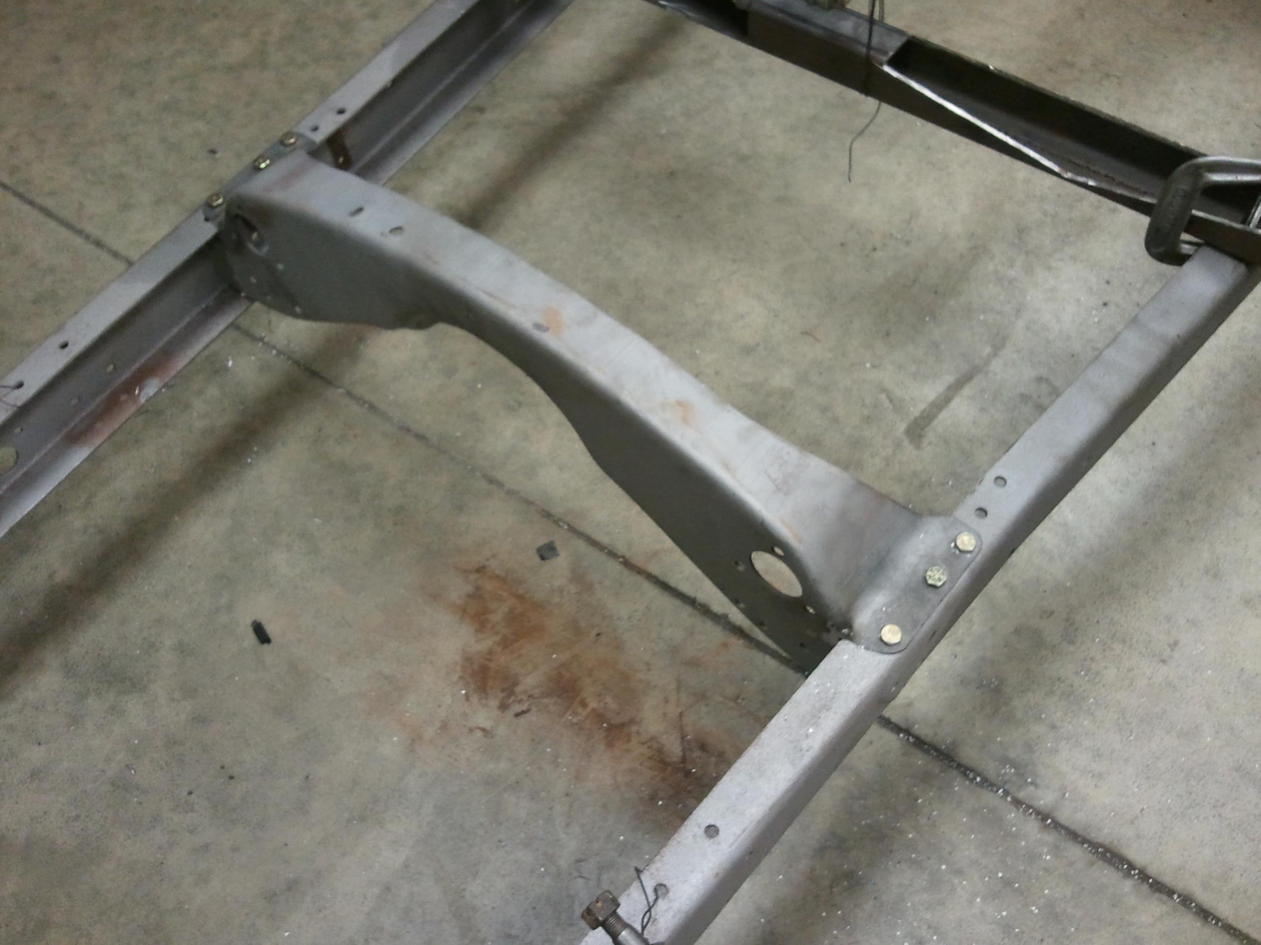

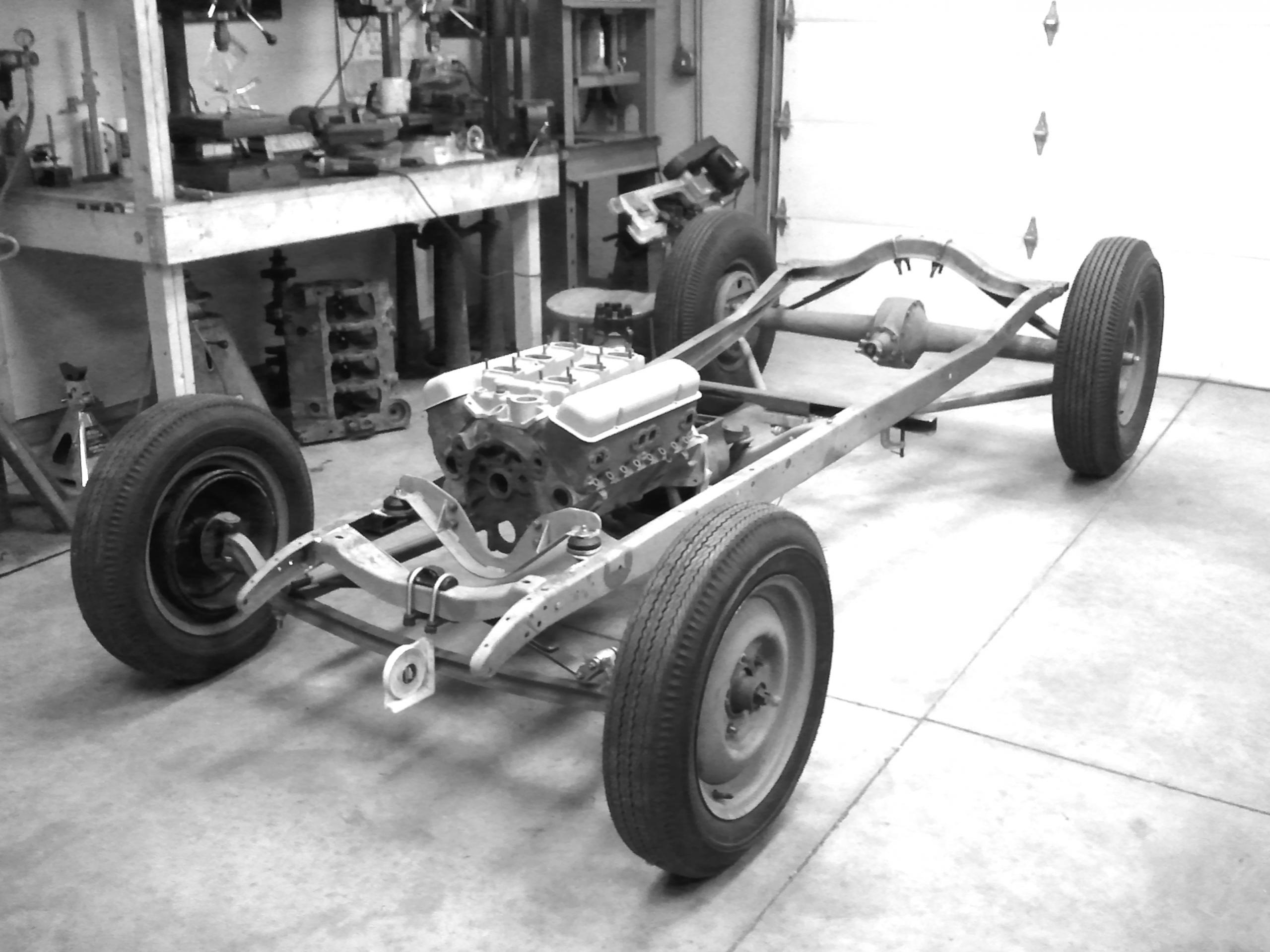

    Got my F1 crossmember finished and mounted in the frame today. My brother Keith and Big Ed helped out as usual. Next is the F1 steering box and column, clutch and brake pedals. After that the radius rod mounts front and rear. I'm going to try and mount the rears in the center to a ball so the whole thing pivots like it's supposed to and a torque arm or ladder bar type setup like the rolling bones. The frame was stretched and Z'd 7 3/8" to use a spring behind axle. Here are some new pics.

  24. peter schmidt
    Joined: Aug 26, 2007
    Posts: 660
    peter schmidt
    from maryland
    Nice looking truck any picks of how you stretched and z'd the frame

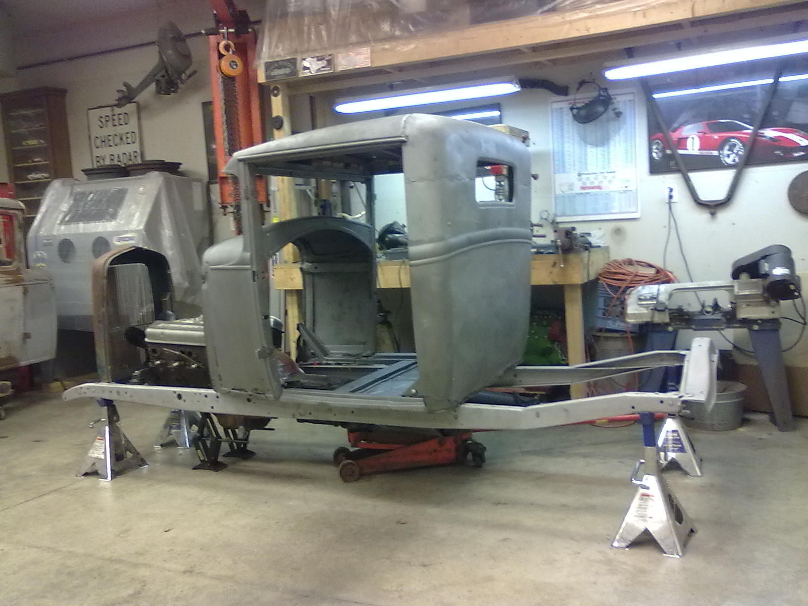

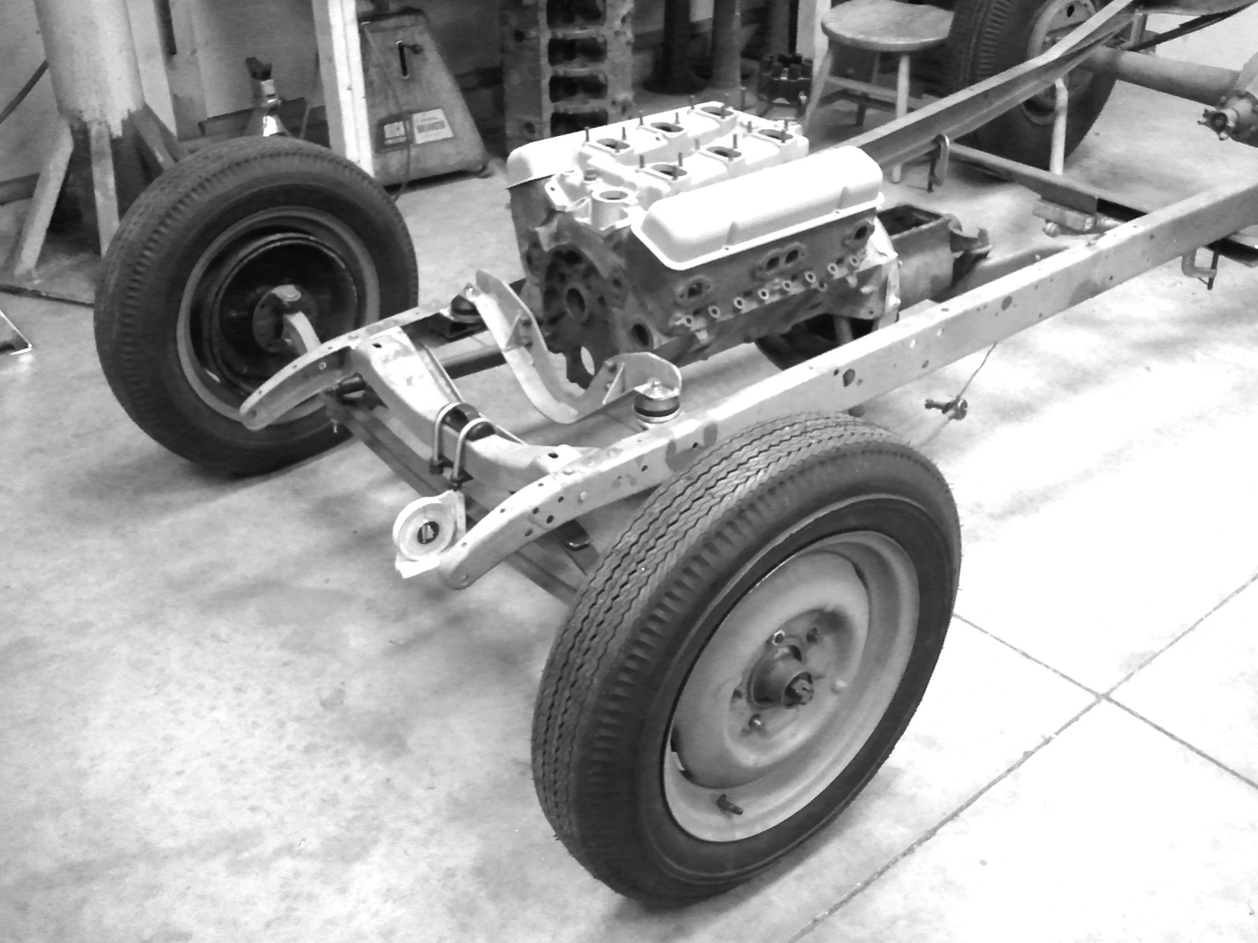

    I have better pics I can post but but I need to find them, measurements also. It still needs to be boxed but here's a couple for now.
    So, here's what I did. It's just a variation of the way Vern Tardel/Mike Bishop do it in the book "How to Build a Traditional Ford Hot Rod" so read that first and this should make more sense. I had the frame apart. I took some heavy poster board and made a template of the last 3 feet of the rails and cut it out. The spring behind axle puts the center of the spring 7 3/8" further back than the spring over type. I laid the template out on the bench, picked 2 points 7 3/8" apart. (I picked a spot on the rear of the frame rail that would allow the rear radius rods enough clearance so they wouldn't hit the frame. They are closer to the frame after it is Z'd.) I drew a line on an angle from the rearward line at the top of the rail to the forward line at the bottom of the rail and cut it. Then took the cut rear portion, moved that piece back and up so the bottom of that rail made contact with the top of the front section. Made sure the top of the rail of both sections were parallel and stuck the template down to the bench, measured and all was good. I laid the rails out the same waycut them and built a jig to hold everything square and welded it together. I took some pieces of tube and filled in the top and bottom like they do in the book and welded it inside and out. The rear crossmember is connected in the stock holes so the frame is a bit wider from front to back than a stock frame. Like I said, it needs to be boxed still. I will post some measurements and pics of the template this week.

  26. peter schmidt
    Posts: 660
    peter schmidt
    from maryland
    Thanks alot for the pics and info that looks great I was wanting to do the spring behind axle on mine and couldent figure out a way to make it look good the way you did it looks great. Thanks again

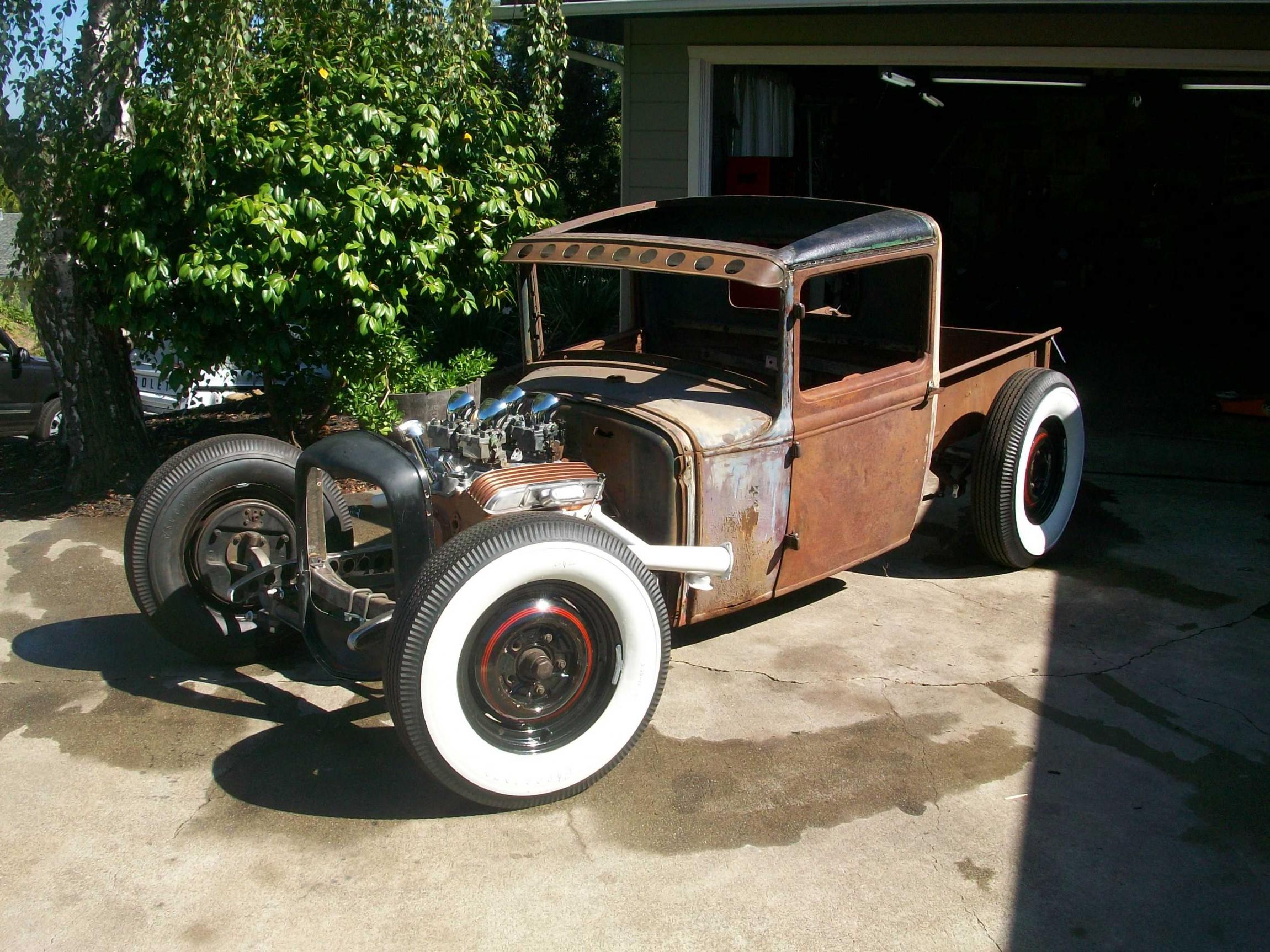

  27. The truck is coming along nicely. Id say better un channeled with the chop.
    Are you going to box the rails for additional strength ? as i noticed they havent been done yet.
    Thanks for sharing.

  29. F-6Garagerat
    Joined: Apr 12, 2008
    Posts: 2,652
    F-6Garagerat
    yeah i'm going to box them, in the process of ****oning up the ch***is now.
  30. F-6Garagerat
    Posts: 2,652
    F-6Garagerat
    thanks. there are 6 leafs in the rear spring.
