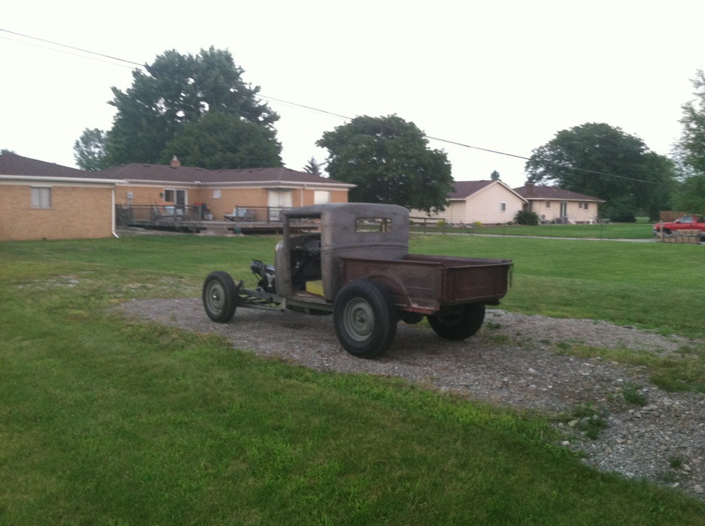

    Well, the ride I so desperately wanted to take this summer isn't going to happen. We started on the doors last night. You expect this bodies to need some shifting around to get things to fit but this one is waayy out. The door openings are both dimensionally the same but they are too far out of wack. Sub rail is cracked in 2 places each side which I didn't notice before. That's not helping. Rear of cab, cab corners and rear floor are rotted and letting the back of the cab tilt forward real bad. Sub rail cracks have the cowl mis aligned. Nothing my brother and I can't fix but it's going to take a while.
    So, we're going to start it up for the first time this week, break the cam in, and maybe take it for a quick loop around the backyard. Won't be the same as being out for a cruise but it just might keep me from going insane.

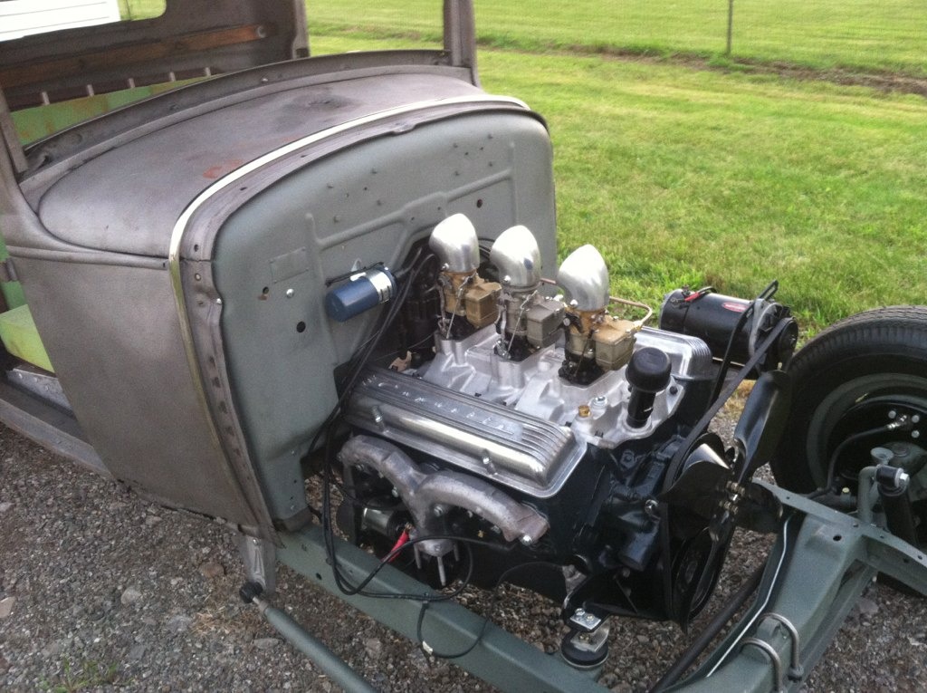

    Well, pushed it out of the shop yesterday. Wanted to make sure the carbs weren't going to flood and no other fuel leaks. One of the bowl plugs was leaking like crazy. Got it stopped. Wanted to whirl it over and see if it would fire at least. Radiator is not mounted so no break in yet. A few back fires out the carbs so we had fuel and spark, a good sign really. Screwed around with the distributor and got the fire coming out of the exhaust instead. Pretty sure the distributor is too far advanced, needs to be retarded a few teeth. Before anyone jumps on me for the coil being sideways, I need a longer coil wire so we just turned it sideways for the testing. It will be mounted upright. All in all it was a fairly positive night. It was getting late so my brother and I figured we would knock off for the night. But, we're even closer to hearing it run. Busy tonight so no shop time. Friday night it's show time. Keep your fingers crossed. Here's a few pics. Check out the box wood my brother hooked up. If it wasn't for his help I probably would have given up months ago

    Fire in the Hole!!!!! Nice! Flames are common with that setup/no exhaust, open like that.

    Yeah, we basically just wanted to see if we could get anything to happen, lol. We weren't planning to start it up that night. I had 2 pieces of 2" pipe bent and flared that still have to be put on before we start it up for real and break the cam in. Didnt want to run it just on the manifolds.
    So tonight, baring any other setbacks, should be the night for break in. Need to pick up a lower radiator hose, bolt the exhaust on and we should be good to go. Well, I'll probably need to put that oil canister on, lol. I'm going to pull the distributor and valve cover real quick and static time it, I think it's a bit advanced. If all goes well there will be video later.

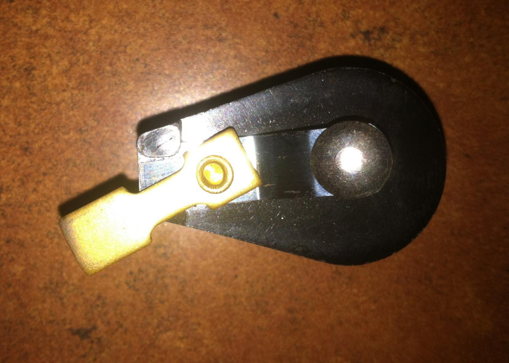

    Can't catch a break. When I got this 283 I got a bunch of parts with it. A box of ignition parts, nos points, cap, condenser and this rotor. We knew from trying to get the engine to fire the other day that the distributor (a 1957 cast iron Delco dual point) was off a bit. Checked it tonight and it was 180 out. No big deal. Static timed it correctly now. Went to put it back together and noticed the rotor. Pretty sure I broke it getting the cap off and out of the firewall recess area. I'll leave this one on the drivers seat of the delivery van at Franks Auto Parts on my way to work in the morning at 5am. He will know its from me, lol. He's a hot rodder. If you live in the Detroit area and dont know about Franks, well you should. If he doesn't already have one on the shelf he will have one by the time I get out of work. Then we'll try it again.
