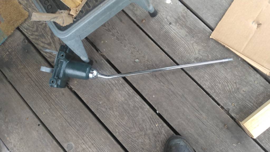

    I also picked up a cool torque tube with a borgwarner overdrive in it. It will eventually make it way into the car. 042D2E0D46AB41409B883A2258C8FD0B.jpg

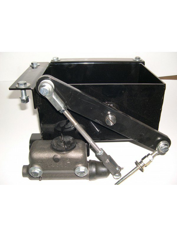

  10. Are you going to go for the reproduction Lincoln brakes? For what it is worth I like mounting the master cylinder on the replacement battery box, just be sure the box is built strong enough (some suppliers cut corners). Might be a good question for fordbarn.

    I am going to run the Lincoln style brakes. I already had a set from another project. I am using a battery box style set up with master cylinder attached.

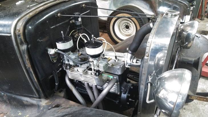

    Engine has more work done. Intake with dual 81's and new head. Brakes are done just need to bleed. 1977.jpeg

  14. What is the story on the head? It looks like a Thomas but has a Model B water pump? Is it a one of a kind that Tod made up? I ***ume the intake is one of those reproduction Thomas manifolds, where did you get it? Using all three carbs would look good but probably run like hell (over carbureted).
    Charlie Stephens
  15. CGkidd
    Joined: Mar 2, 2002
    Posts: 2,924
    CGkidd
    The head is the new one from Dan Price same with the water pump which is aluminum with modem bearings and seals. The intake is one I picked up from a buddy. Not sure if repop or not. I do know it doesn't have a boss for the throttle bracket so I got creative with a throttle cable set up. Mounted a cable bracket under center carb block off plate. And a chore pedal inside.

    Can I see a pic of your master cylinder placement please?

  19. That looks solid, unlike others I have heard about. In an effort to jog your memory, did you buy it from someone in central California, did you buy it from Berts in Colorado? I think the master cylinder is unique, do you know what it is from? Maybe someone could add to the list.

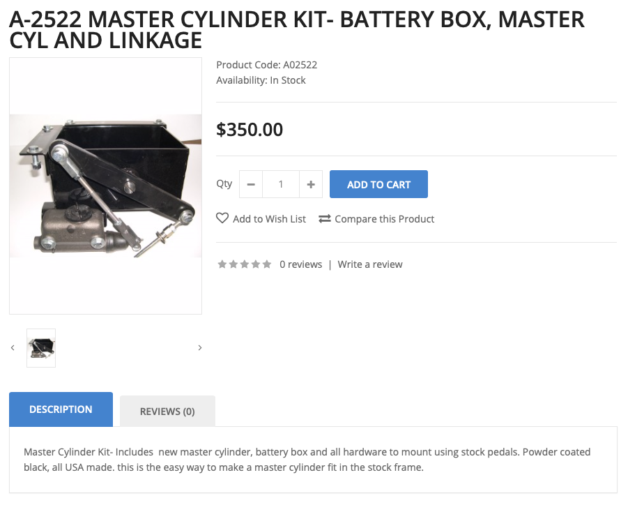

  22. It sure looks like the one in Bert's catalog.

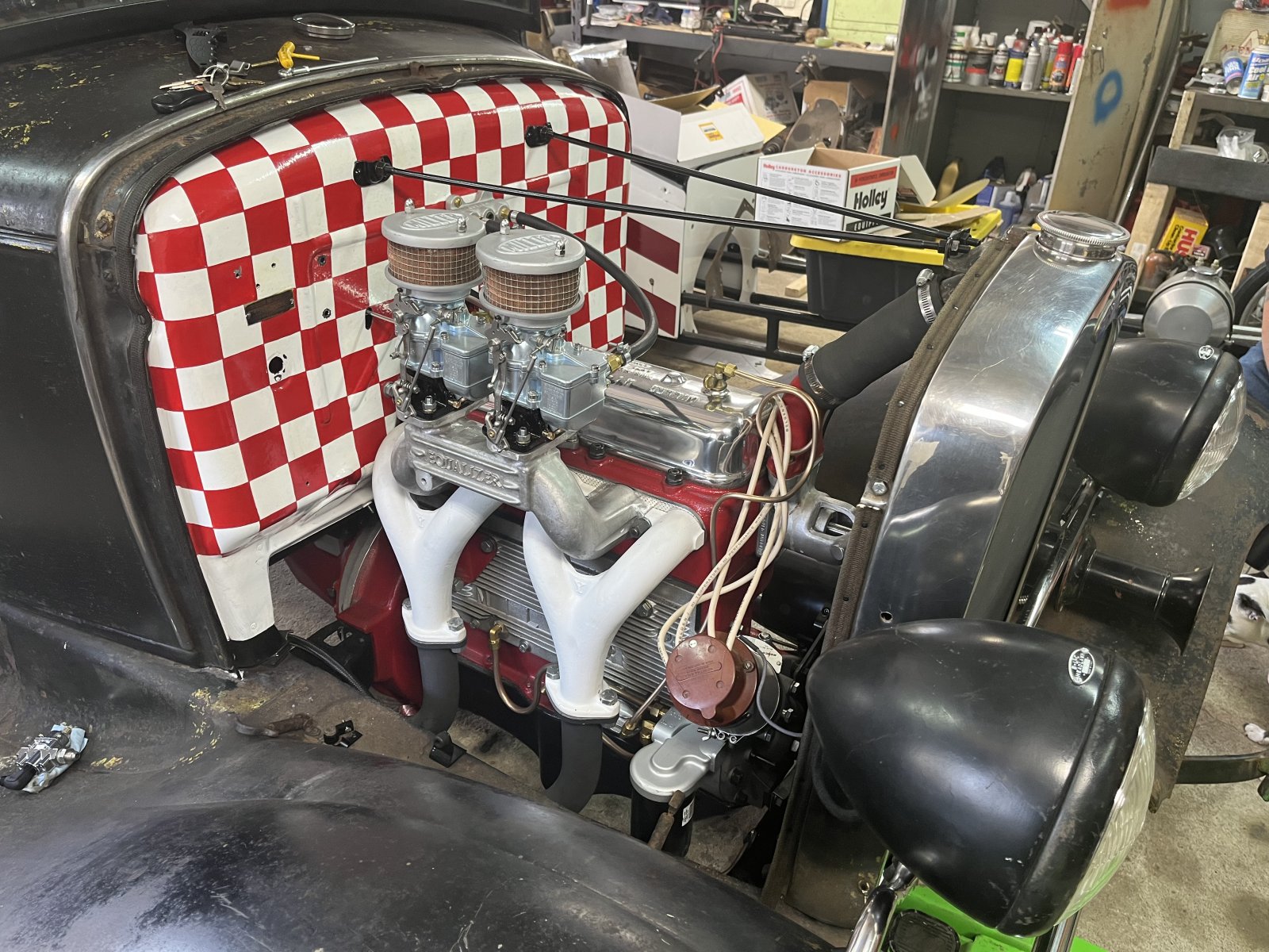

    Engine is in place. Shanghaied a buddy to hand paint the checkerboard on the firewall.

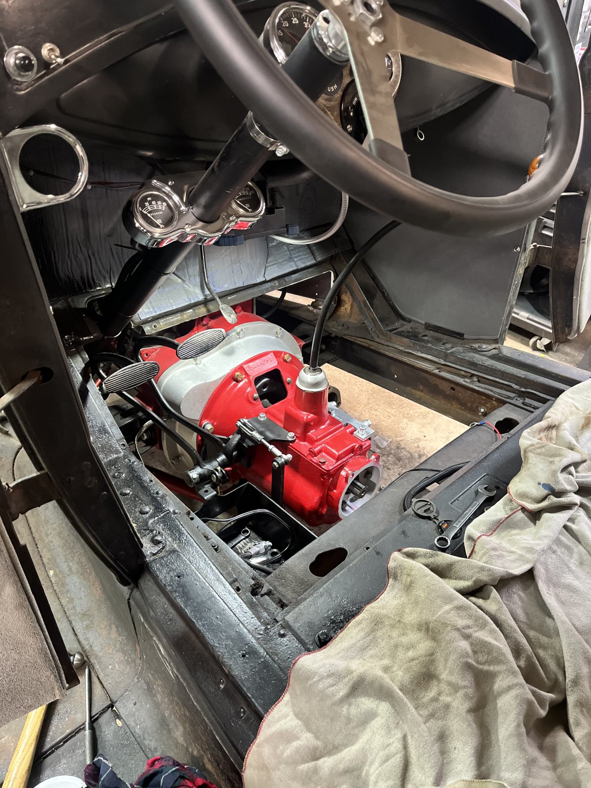

    CGkidd
    Well it’s been awhile but here are some updates. After test driving decided I did not like the gear ratio on the Mitchell transmission and went with a clings adapter and 39 gear box. Plus if I damaged the transmission I have spare gears for the 39. Also changed to a equilizer intake and headers from Charlie Yapp.
