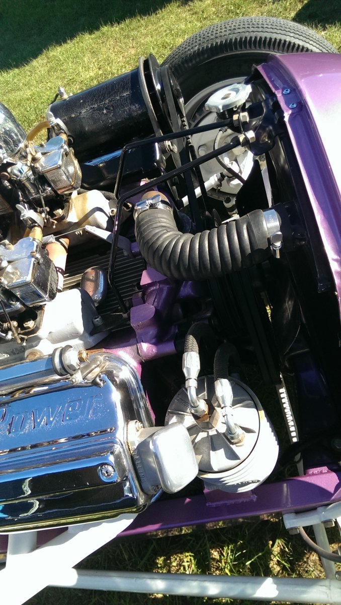

    One other option is to attach the radiator support bars to the front of the engine.
    There's still some vibration (and eventually fatigue failure), but it has been done successfully.
    Here's Bobby Hilton's channeled coupe for example:
  11. Stogy
    Joined: Feb 10, 2007
    Posts: 27,391
    Stogy
    That engine must be quite rigidly mounted and that is quite possible.

  12. ramblin dan
    Joined: Apr 16, 2018
    Posts: 4,165
    ramblin dan
    I once saw a set up where 5/16 heim ends were used on the ends of the support rods and wonder if that was enough to absorb some of the vibration. A while back there was a thread posted about the firewall mounts tearing off due to it being too rigid.

  17. Kiwi 4d
    Joined: Sep 16, 2006
    Posts: 3,943
    Kiwi 4d
    Much as I really admire Bobby Hiltons work I really do not think that those radiator supports going direct to the block are his best idea ,unless the engine is solid mounted.
    The power he and Ross build into these vintage engine will surely be rock n rolling.
