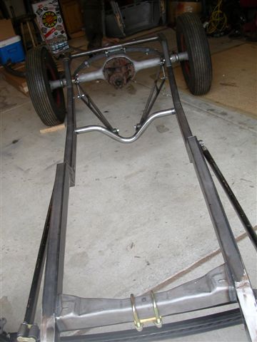

    Heres one I'm working on now. Its a 40 ford front spring mounted behind the axle.
    This one was for an A pickup I did last year, coil springs and a pretty good kickup.

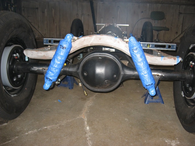

    This is my First attempt at a Coil-over / Hair pin set up...
    These pictures don't show the Panhard that I added later which is basically the Speedway Bolt on Kit.
    Well See if it works in a few months.

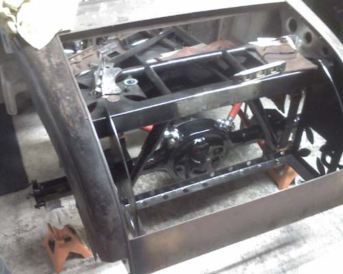

  7. 40 Ford rear spring.
    2nd leaf removed, a couple of top ones gone, that could change.
    Custom made main leaf.
    The pic of the car has the 1" aluminum spacer block removed.
    Depending on how the rear fender setup works out it may be removed if there's clearance for the tires.
    Gets the car down nice & low and the best part is, a lot of adjustablity vis a vis ride quality and chassis height.
    32 frame very close to stock measurements.
    No offense, but I'm all through with coilovers.
    They don't have enough travel to have a good ride.
    You'll more than likely want a sway bar, it makes a big difference in handling on the mountain curves....

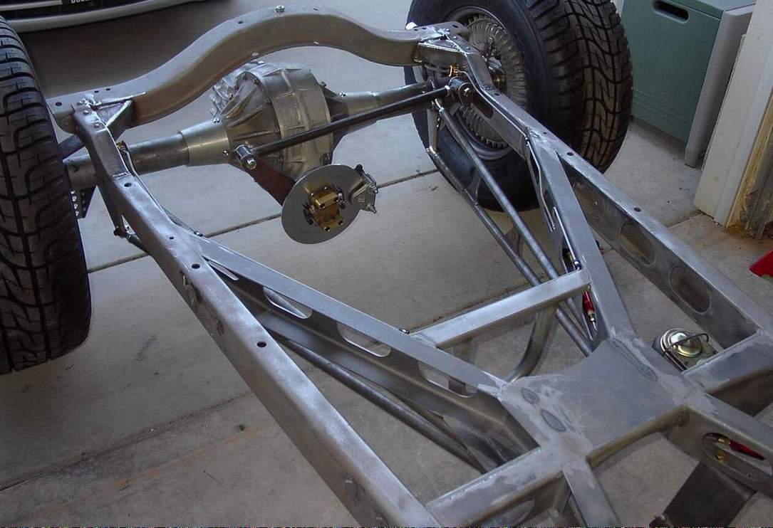

    Here is a modern style 4-link.

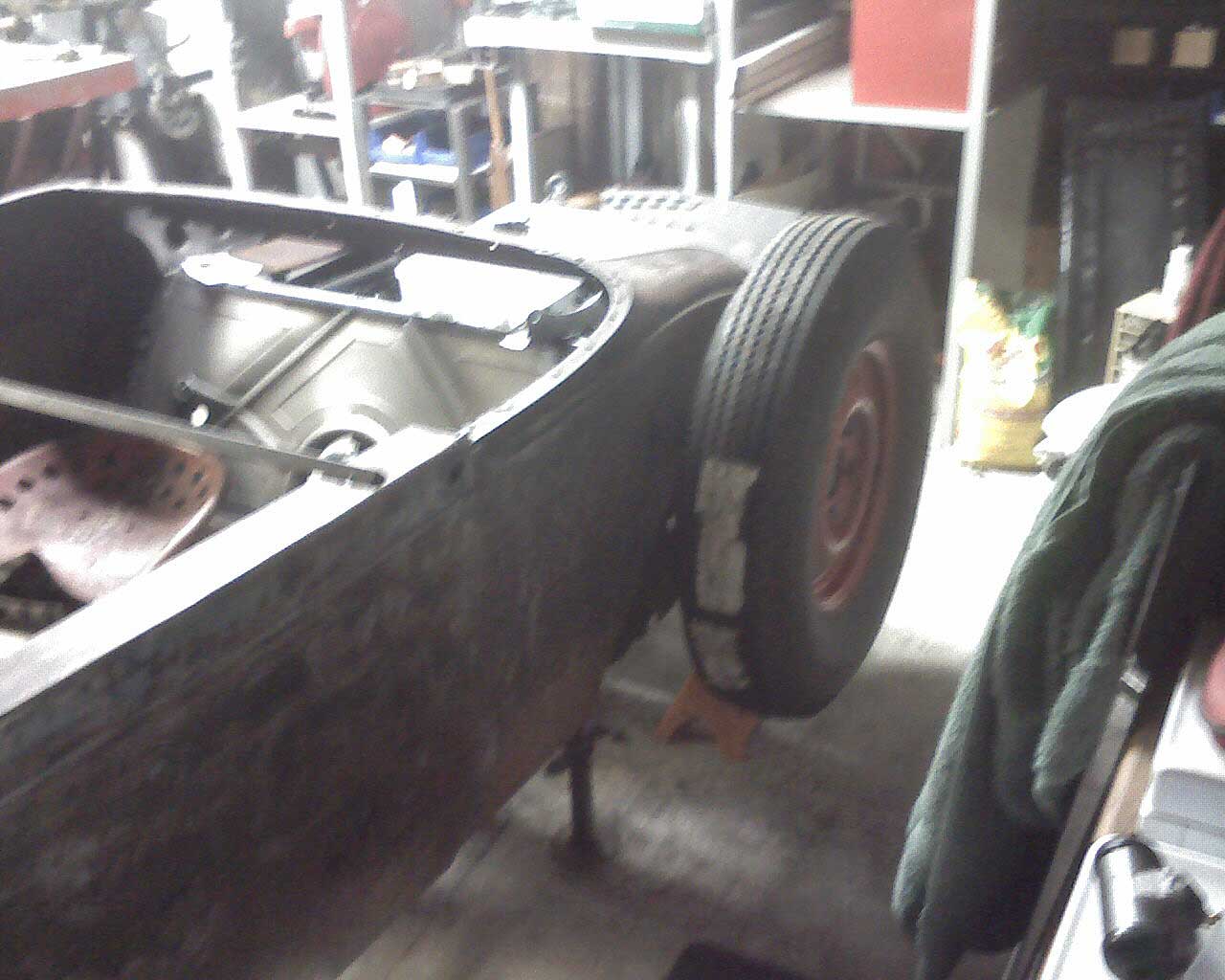

  10. Not pickin' on Cornerfreak here since it's obvious he's going in a different direction than I am.
    Anyhoo, heres a pic of the 31 on 32 rails roadsters trunk.
    Lotsa room.
    (Disregard the big multi-hole lid bracket . . . that was so I could find the optimum location for the upper part of the gas lift. A small single hole bracket replaces the big one.)
    Enough room in fact for a spare tire & tool box and a few extra parts.
    (Fuel tanks, battery and pump are under the body within the frame rails.)
    We usually carry a couple of small tool boxes in the 32 - one for tools and one full of small stuff for repairs.
    Toss in a couple of hot rod chairs, couple of jackets and a small ice box and you're pretty much done.
    You can see how little room is in the 32's trunk.

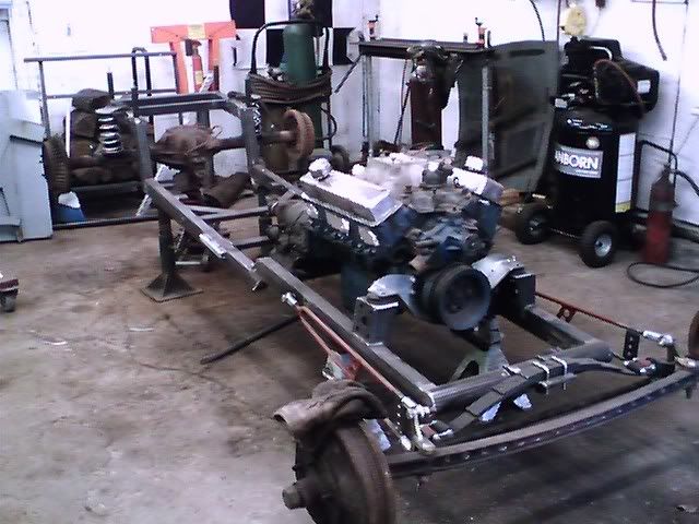

    Mine is a AA truck, and my rear setup is definitely more different than anything else you'll see out there on anything to do with an A. The pictures and build process are in the link located in my signature.
    Coming up soon: More progress! Soon to be a roller and have the engine set into place! Woohoo!

    I envy your trunk space! Haha but yes I have very little. Even less once the tank is in. I didn't want the low low stance you see quite often now-a-days. Just a lowered look that has useable suspension travel. Just trying to put as much detailed work as I am capable of for a solid ride and see what people notice. Here are a couple more pics of the rear suspension. A somewhat side pic of near ride height and completely dropped. About 8" of useable travel. C9 that's some nice work also. Looks well thought out.

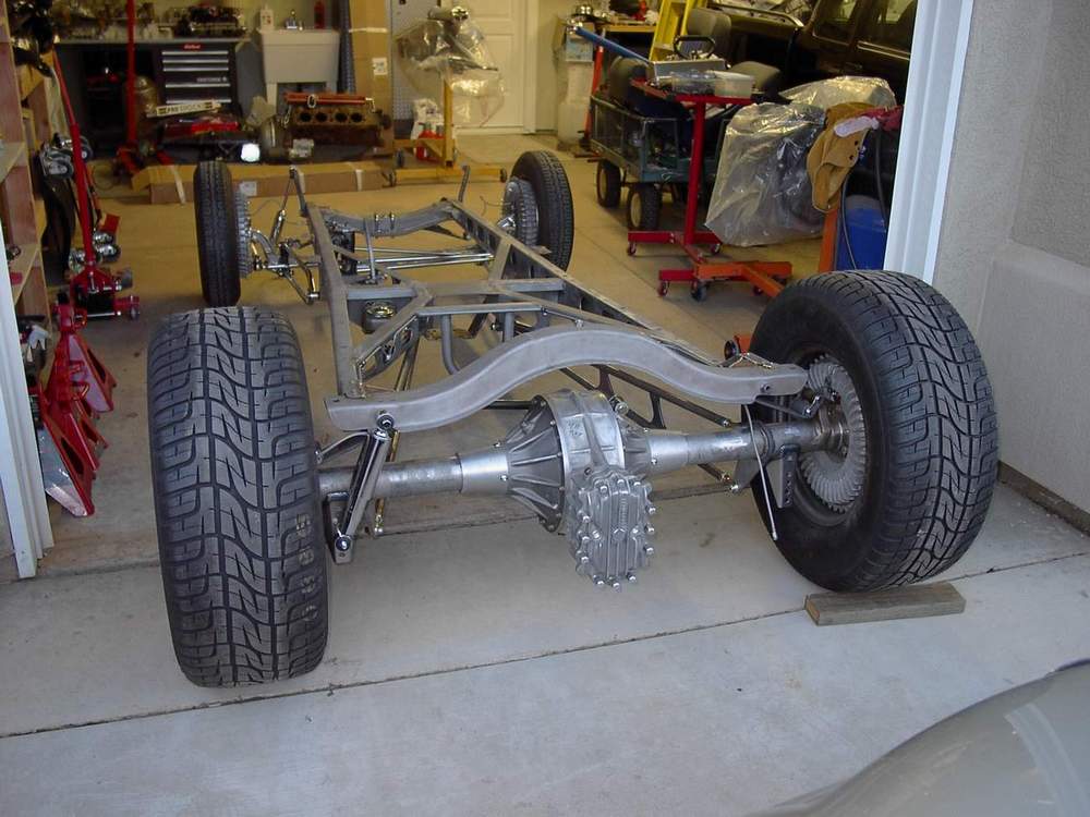

    Here's a couple shots of my 28 roadster. Stock Model A crossmember,35 split wishbones,40 rear end with a Wilson Welding quick change.
