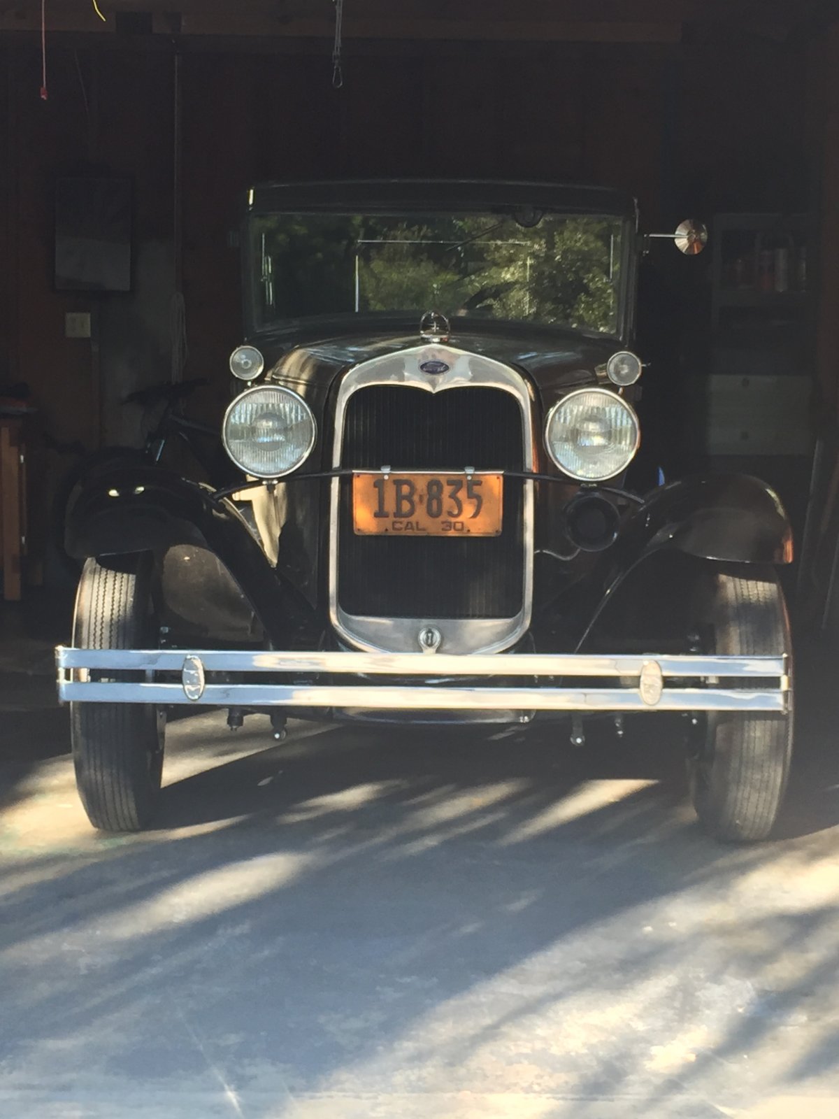

    I put '40 brakes on my '29 A-V8 with stock rear end and MT hubs and drums. I don't think there would be a problem. The MT drums have a thicker flange and you need the special studs but the width would be no more than an inch and a half total, not each. I have 8" wide wheels with 235/ 15 tires and even with that the tires only stick out about an inch or so past the fenders in the rear. A bit more so in the front. You should have ample clearance to use wheels with more back set to bring them in a bit if needed.
    See my avatar picture
