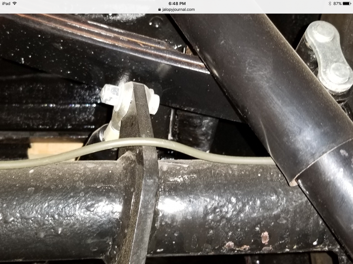

    I am trying to sort through a rear suspension problem on my AV8 (30 coupe).
    I did not build this car I am just working from the front to the back sorting problems in order of severity.
    the current problem is that the spring shackles are at 90* at rest and the bottom of the spring is very close to the top of the hairpin mount. (see pics below of my nightmare)
    The rear member is from a 51 Ford F1 and I am trying to determine what spring was used for this rear suspension and if my problem is a worn out spring, to many leaves removed, other...
    I was told by the PO that a 30-31 spring was used and possibly there was a leaf or two removed.
    Looking at pictures of a 30 reverse eye spring it would appear that the arch is greater than the one that is in my car.
    My questions are:
    How many leaves are in a stock 30 rear spring? Mine looks to have 6, maybe 7, it is still in mounted so it is hard to tell for sure.
    Does anyone have a measurement of the distance between the bottom of the leaf pack and the line that runs between the reverse eyes when the spring is installed and the weight of the car is loading the spring?(see my drawing for the measurement i am looking for) mine is about 9" and the spring seems pretty "de-arched" from what a stock spring looks like out of the car.
    In another thread about rear springs @HotRodWorks Said that the standard rear spring eye mounts are 49.5" apart. Mine are ~47". Posies sells a 46.5" spring but I want to make sure that I am not going to raise the rear of the car more than an inch or two using the Posies spring.
    Sorry for all the questions, I suffer from Cluster Headaches so I have had plenty of time laying awake in bed to over think this stuff.
    Chappy

    I'm not clear as to what exactly the problems are. You've not for instance said it rides like ****.
    Problem 1. Shackle is near vertical - is that a problem in itself as it's not at the ubiquitous 45 degrees?. Does the spring actually hit the spring perch? If not is there really a problem? There are some that don't necessarily subscribe to the 45 degree deal, so that's arguably not a problem. If there is interference a shorter spring would fix it. Or maybe some careful and not excessive clearancing of the spring perch.
    Problem 2. Spring is close to the hairpin. Do they actually meet? If not again is there really a problem? If they make contact, hhmmm.
    ***uming the spring is in useable condition and seeing as you have plenty of room toward the brake backing plate, I think revised spring perches giving clearance for the shackles and a little lift to clear the hairpins would be the easiest fix. two birds, one stone. Simple fabrication.

    Actually, looking again at your first pic (not the diagram) in full screen it looks like it's possible that the spring eye is solid up against the spring mount already.
    Chris

    Yes it rides like ****,
    yes the shackle hits the perch
    yes the spring is too close to the hairpin mount (about 1") and shows evidence of contact.
    i am ***uming the spring is not in useable condition as it may be 90 years old, or modified, or to long, or... (that is why i was asking the question about measurements, etc.)
    ripping the rear out of the car, cutting off the spring perches, cutting new perches, and welding them back in may be simple fab for some folks, (BTW would i need to pull the wheel bearings and seals out of the rear before i go welding that close to them? will all that heat mess them up?) but for me, in my one car garage with a 115v mig welder and not trusting my life to my welding abilities... this becomes more than simple fabrication.....
    i was hoping that getting a new, shorter spring, like the Posies 46.5" perch center reverse eye spring would solve this problem without having to do a bunch of fab work. There is a new rear in my future plans for this car but unless someone is giving away QCs today I have to work with what I have and within my budget for now.

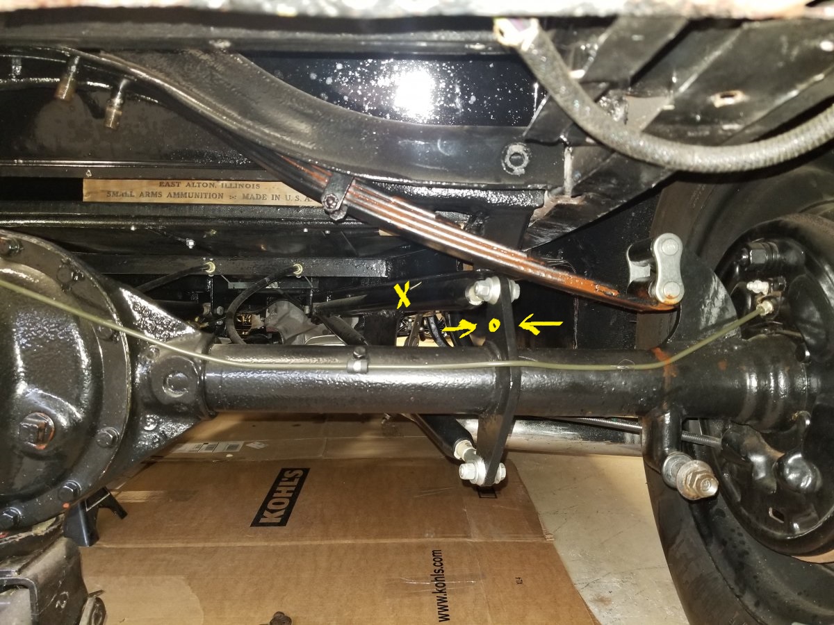

    Well, I pulled the rear today and it is a 10 spring pack!
    Below is a pic of the shackle angle out of the car. Seems like 10 leaves shouldn't settle as much as this one did.
    This is my first model A so I am not sure what it should look like out of the car.
    Thoughts???
    Thanks
    Chappy

    Chappy said he's swapping a different rear end in sometime in the future, but not now. He also said he is not trusting his welding and is looking for advice.
    with those two things in mind, what is the hamb feedback on this idea below?
    ^^^ First is to get a shorter main leaf so he can keep the welded shackle brackets as they are, and get the shackles to 45 degrees.
    Next issue is the "too tall" upper trailing arm bar & clevis. How about cutting that existing top bracket down, relocate the hole for the clevis, then bend the upper bar down at the "X"? ..(which is directly behind the mid-point reinforcement spreader plate between the upper & lower bars)
    Lastly is remove the excessive leaves to get a better ride, then use "cut" center pieces of those leaves up at the top of the spring pack as spacers, so the ride height is not lowered ?
    Is this the easiest way out without turning this issue into a huge depressing project?, ...or am I missing something in all the pics so far?
