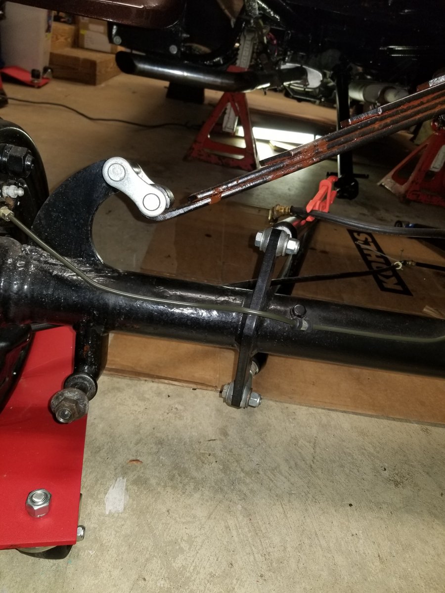

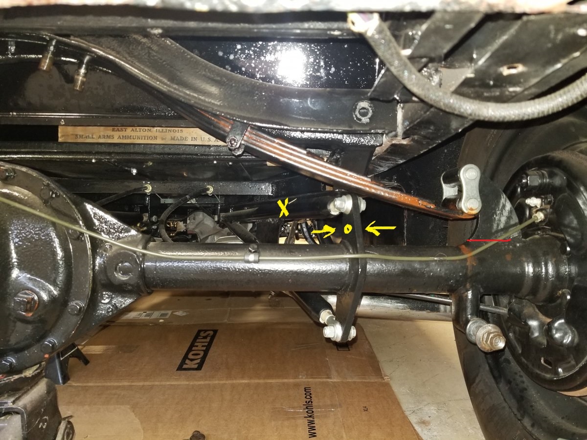

  6. Chappy444
    Joined: Jan 27, 2012
    Posts: 1,337
    Chappy444
    F&J,
    Thanks, I like this idea...
    I hadn't considered cutting the hairpin bracket... dont know why I didnt lol... to close to the problem i guess.
    I am ***uming that heating and bending the hairpin won't cause any strength issues in the metal.
    Out to the garage to take some measurements
    Thanks again...
    Chappy

    Looks to me that if you put the proper length spring in the car it will clear all brackets. I would be shooting for less than 45 degree angle on the shackles. Then tune the spring for desired ride and ride height.

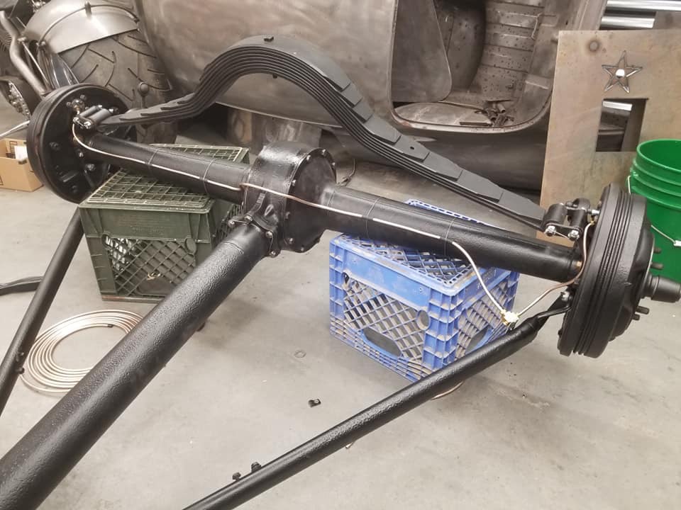

  8. Chappy444
    Posts: 1,337
    Chappy444
    The plot thickens....
    It was late when I got the spring removed from the rear so I didnt look at it close untill this morning.
    A few things I noticed.
    1. It appears that the main leaf may have been shortened at some point... ther is evidence of "vice" markets on the eyes and the second leaf appears to have been cut shorter...
    2. I am not convinced that the upper half of the spring is moving at all, no evidence of grease or slide marks on those springs (possibly painted together after ***embly)
    See pics

    Those little grip marks are common on spring eyes. Might be original from Ford.

  10. 270bob
    Joined: Mar 26, 2014
    Posts: 131
    270bob
    Your observations look correct, that spring is about 3-4 inches too long. If you choose to make a new main leaf I would suggest not reversing the eyes of the spring because then you can make a tool to spread the spring to install properly.

  11. X-cpe
    Joined: Mar 9, 2018
    Posts: 2,265
    X-cpe
    The spring can't move because the shackles are hitting. You might as well have an 'I' beam in its place.

    I'm not a Model A guru so help me out here, >> doesn't that spring have reversed eyes? ..and if so, then that is why the 2nd leaf tip was cut off? You can see the former wear mark of that tip once wore the main leaf in post 38. That tip would have been jambed against the eye?
    I'm not engineer, but look at the pic in post 36 with the tape measure... those tubes are beefy, and it looks like there is only roughly 9 to 10" of unsupported tubing from the middle reinforcement spreader plate to the rear clevis. I simply can't see those tubes being weakened no matter how he ends up modifying them.
    He's got a hobby "driver", not a blown Hemi on slicks..is what I am getting to, as far as low stresses.
