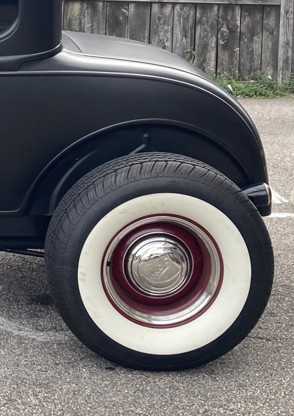

    Silvertown wide white radials at 35 psi. Here is a profile and the shackle. Doing more searching…looks like a true highboy could stand to come up 3 inches or so….

    10psi out of the tires is a free fix in the right direction. Experiment with the pressure, a few psi a time.
    Shackles look fine. I'd be shelving the idea of a 9" and putting the funds to a better exhaust!

    The load rating on each of your rear tires likely is close to the weight of your entire car. Like @Happydaze said, Drop 10psi and see what that does. I run about 22psi in my pickup (700-16)

    Thanks to those suggesting tire pressure...I dropped down to 28 and it's a huge difference. Haven't been on the highway, yet, but even around town is better.
