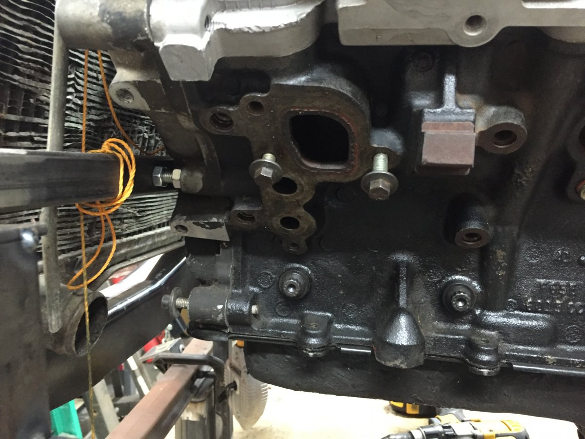

    Ok, so ran into a problem with my oil filter housing. The oil filter sticks out vertically on these motors, which is bad news when trying to replace it. Not enough room between the oil filter and the frame. Also , the coolant return is integrated into the housing. So I have an idea to reroute the oil filter and keep the coolant return in place. Going to do a little hack job and some fabbing. Here are some pics. IMG_2162[1].JPG IMG_2174[1].JPG IMG_2175[1].JPG IMG_2177[1].JPG IMG_2179[1].JPG IMG_2194[1].JPG
    So, basically once I've separated them. I'll tap oil supply and return holes on the housing and on the block for a AN
    fitting. Then just run some braided line. This will put the oil filter more towards the ****** and free up tons of room for exhaust and steering box. I'll post more when I get it installed.

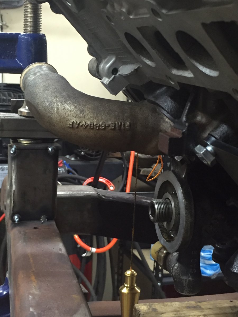

    Tacking engine motor mounts for dry fit. Cardboard is your friend if you do a lot of the fabbing for the mounts
    or when trying to find angles. IMG_2172[1].JPG IMG_2170[1].JPG IMG_2191[1].JPG IMG_2188[1].JPG IMG_2196[1].JPG
