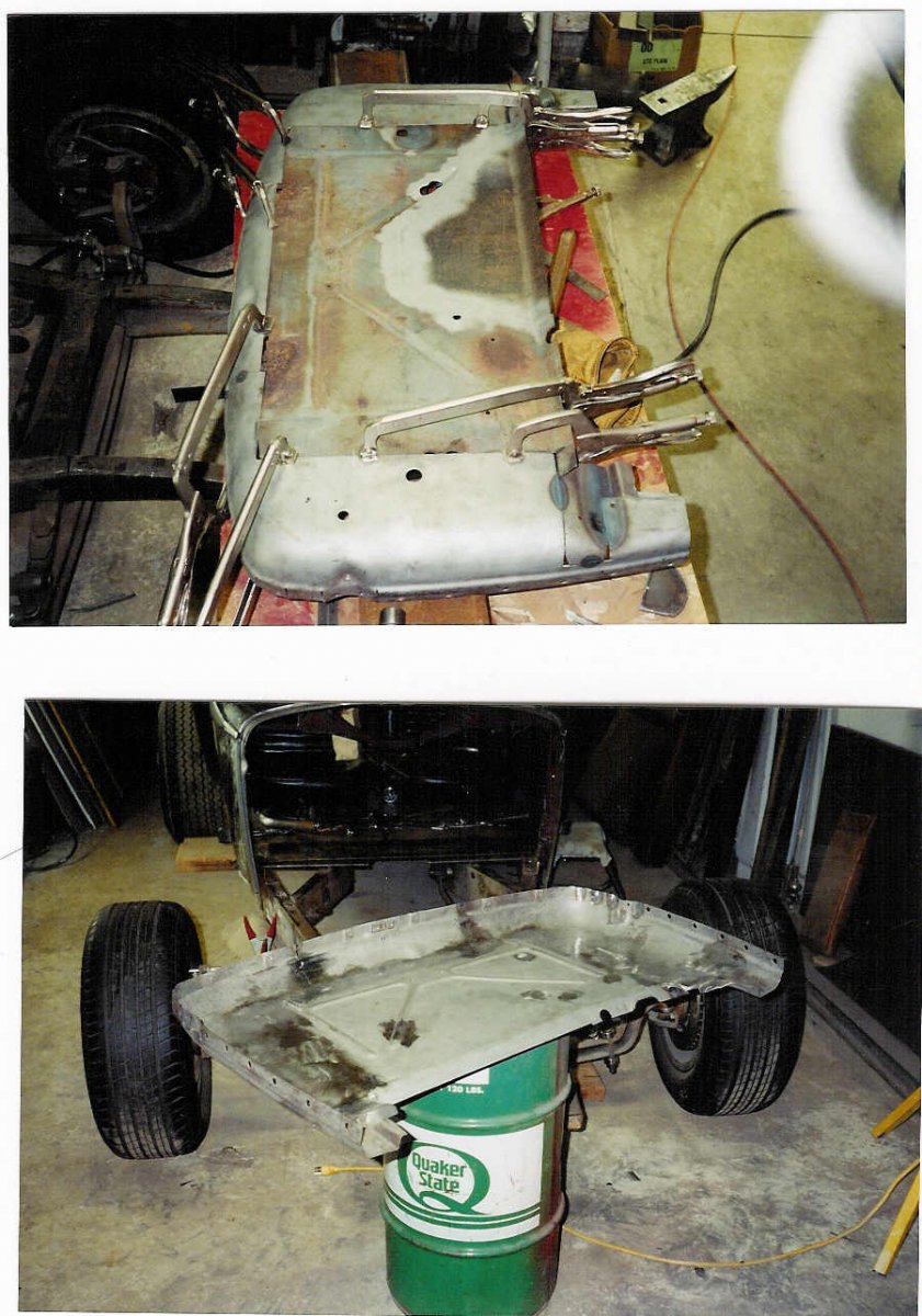

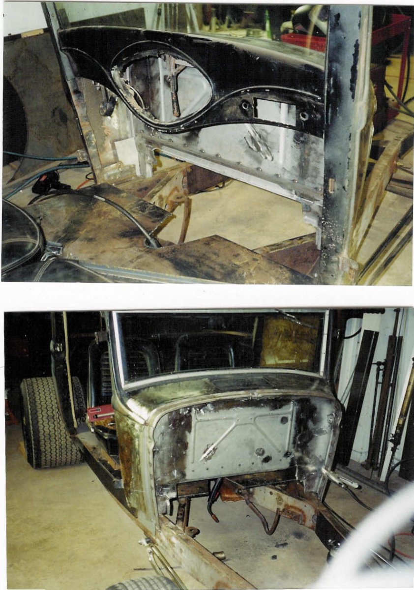

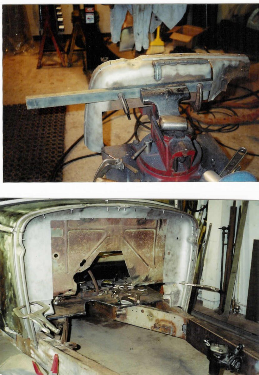

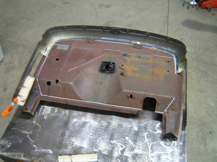

  6. -Brent-
    Joined: Nov 20, 2006
    Posts: 7,780
    -Brent-
    Photobucket really messed with the Internet, didn't they?
    Here are some that I saved for reference for my coupe.
    Firewall 01.jpg Firewall 02.jpg Firewall 02(2).jpg Firewall 03.jpg Firewall 03(3).jpg Firewall Flip .jpg Firewall Flip Feet.jpg Firewall Flip Feet 1.jpg JimRPU Firewall Flip.jpg
