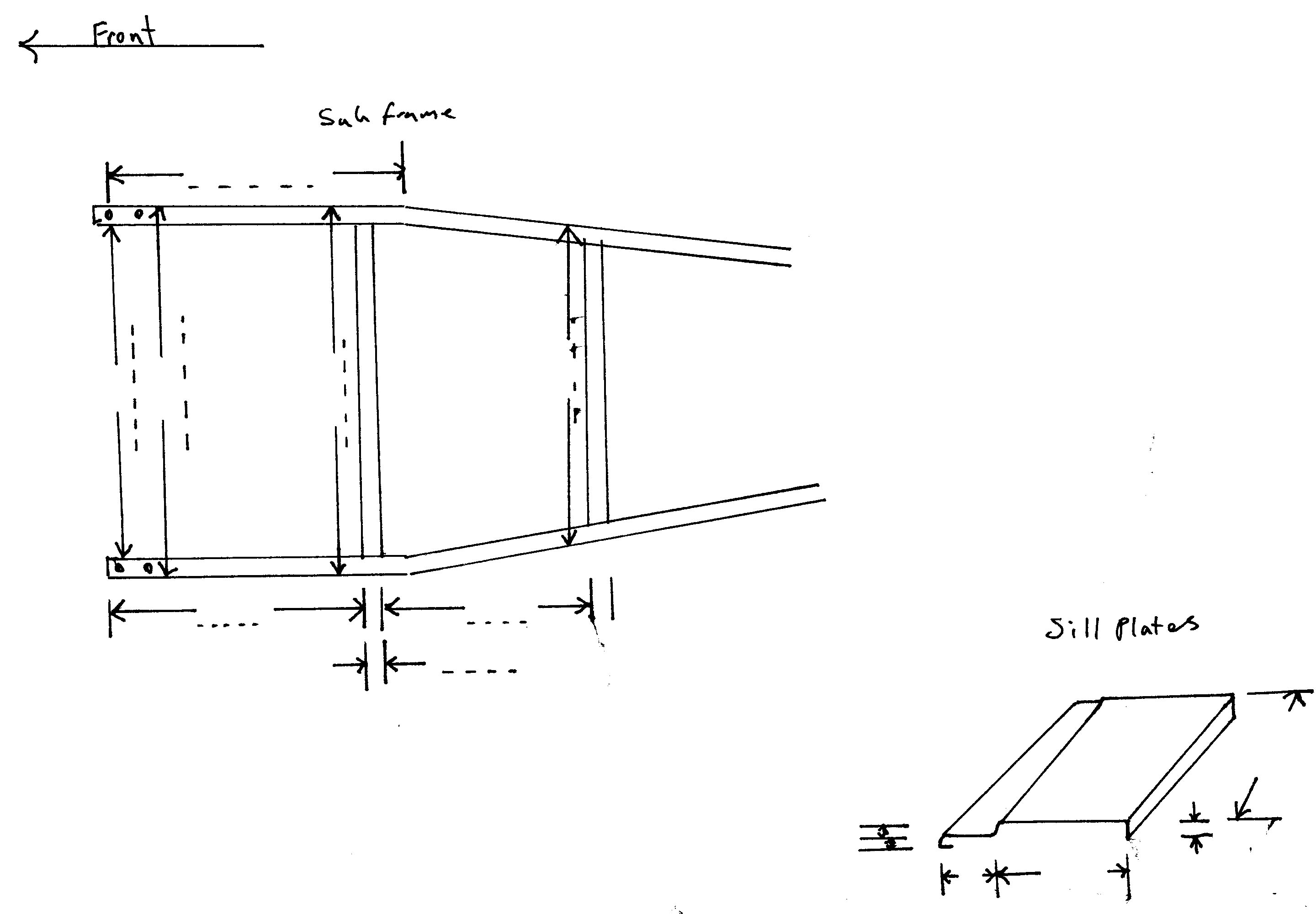

    I have a sketch attached with the measurements I need.
    Brendan

  9. Hello Brendan
    I found the sub frame, I think its better you specify on my pick what measurements you need. The profile is different depending where you will measure. Take a copy of my pick and point your measurements on it.
    Lars

  11. Hello Brendan
    I finally made the measurements; I did a change of nr 15 as you can see. The rear sub rails isn't parallel as you can see on the measurements, just let me know if you want some more. The profile is different depending where you measure, please let me know on the picture on what places you want the profile.
    Lars
